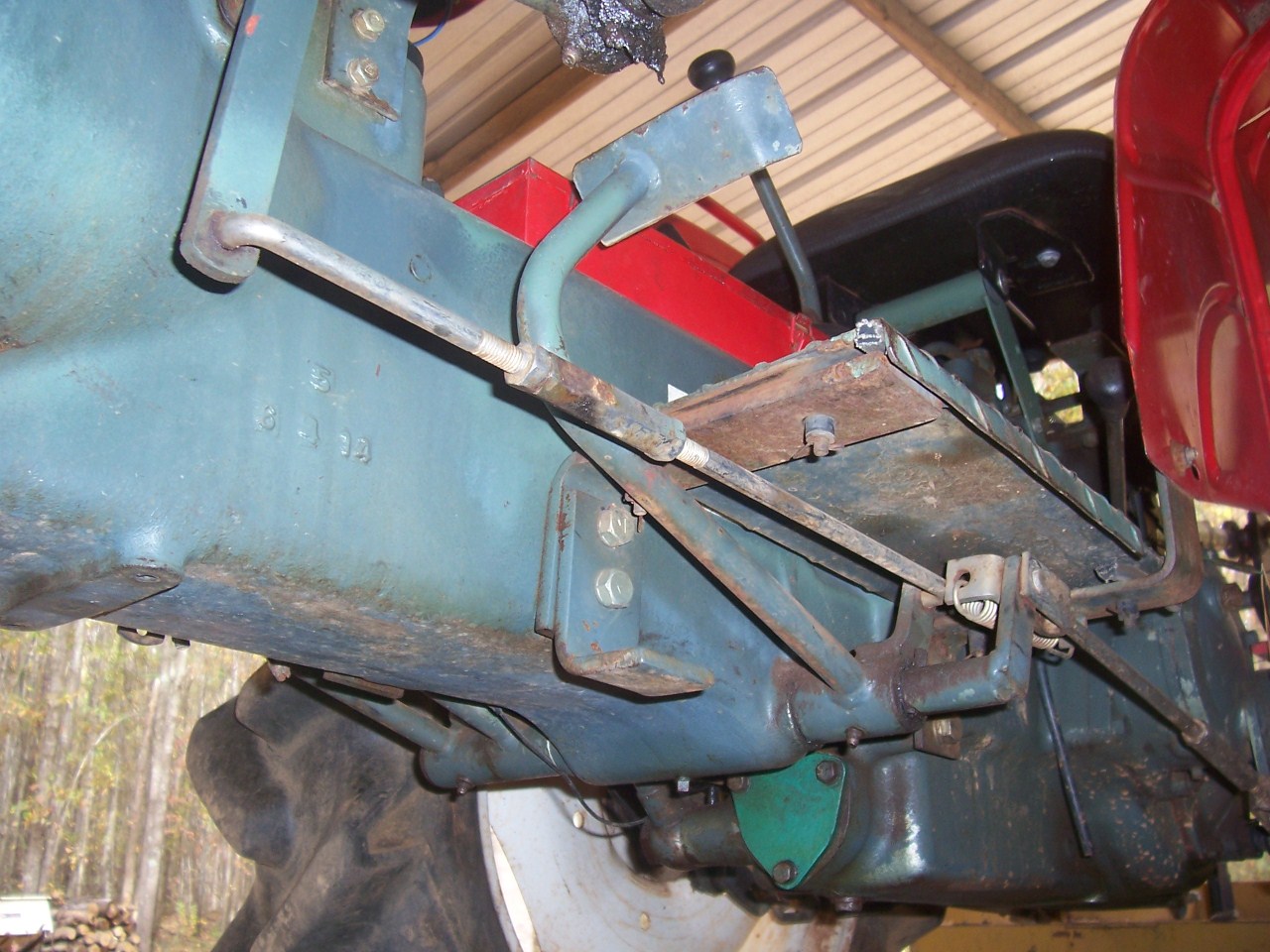

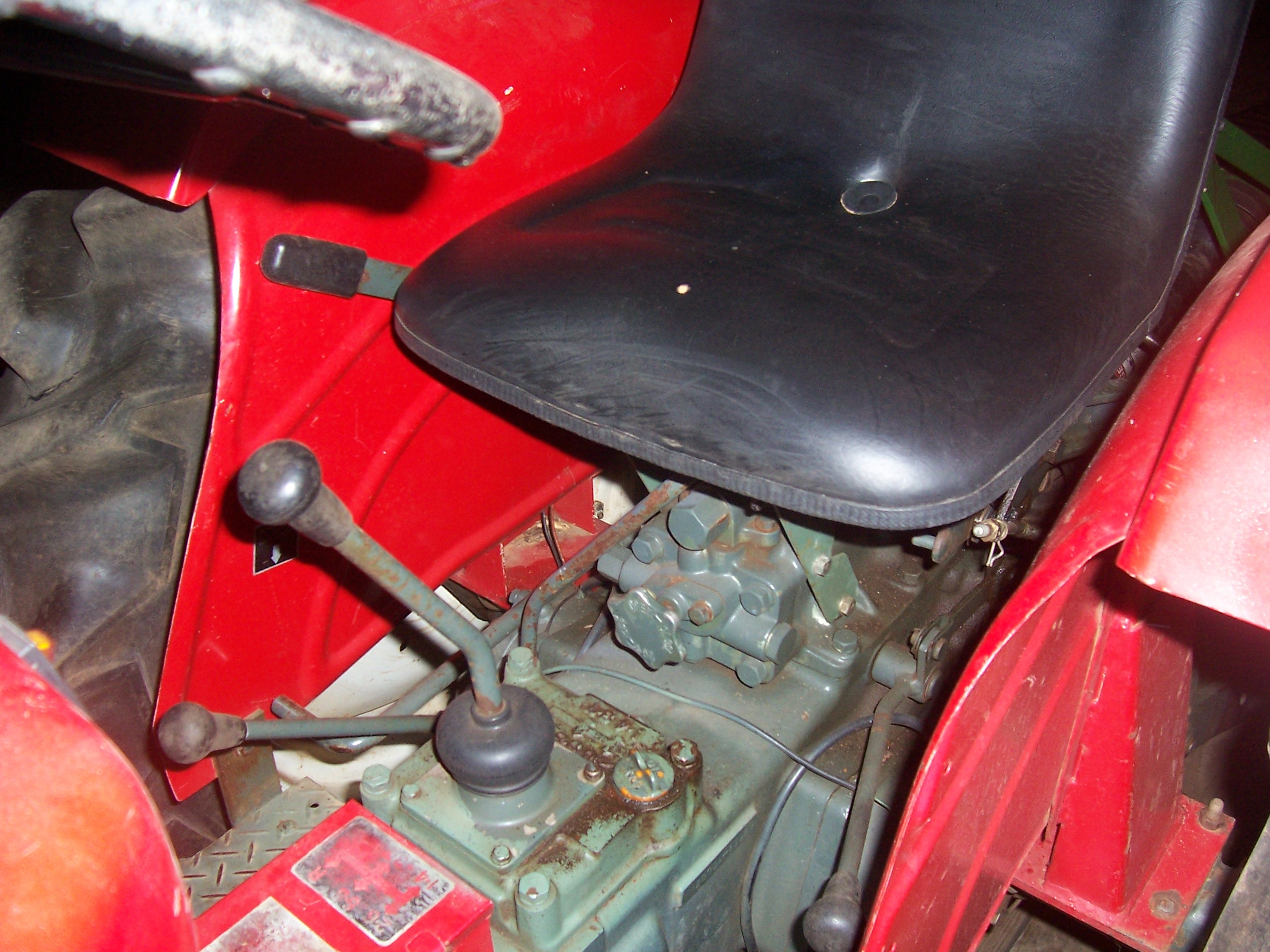

Try this sitting in the seat the Flat knob between your legs make sure it's all the way open. Thats the Serv. Stop valve. And the Hyd's, won't move. The handle Low to the right is the High-low Range selector Make sure it's either up in gear or down, And then of course Select a Trans Gear. Pto to your Left 1 Down for1st. Still CRS. and forget how many gears the 240 has. Atleast I can remember the Ym 2000 same tractor as yours has 3 12N3. That and the Throttle works opposite is the only major difference of the 240 and 2000.If that doesn't do it move to the Clutch linkage. Make sure the Clutch Pedal Isn't Latched. esp. if it's been in storage. Alot of people will latch it or use a wedge etc. to hold it open. It's a known problem that while sitting the clutch will Get stuck if left engaged. and check the Adj. and set it to 1/2 free play before you feel it stop and start to disengage. Check up on the basic's and let us know what you find. I also have a pic. of the Clutch Adj. which is just under foot plate and be looking there for a wedge Etc.

Ok took loader bracket off looked inside little clutch inspection hole on left side of tractor when sitting on it and noticed what appears to be clutch lining. In next couple of days I will split tractor after ordering a clutch from Hoye and dig deeper..

Since you have the top of the transmission opened - do any gears move with the engine running and the clutch engaged?
Seems to me that any sort of slipping clutch problem would make noticeable noise in that area.
   / Ym240d will not move and pto inop?? #7
Dieselcrew
Pieces of Whats left of the Clutch Lining or the Clutch lining itself ?
Seems to me that the clutch just fell apart or delamenated. It seems that there are several clutch lining pieces at the bottom of the case
   / Ym240d will not move and pto inop?? #9
Yeah! thats what I thought you were saying or meant. Loosen your Adj all the way or even remove the linkage and if it doesn't engage without a doubt your spliting it.
