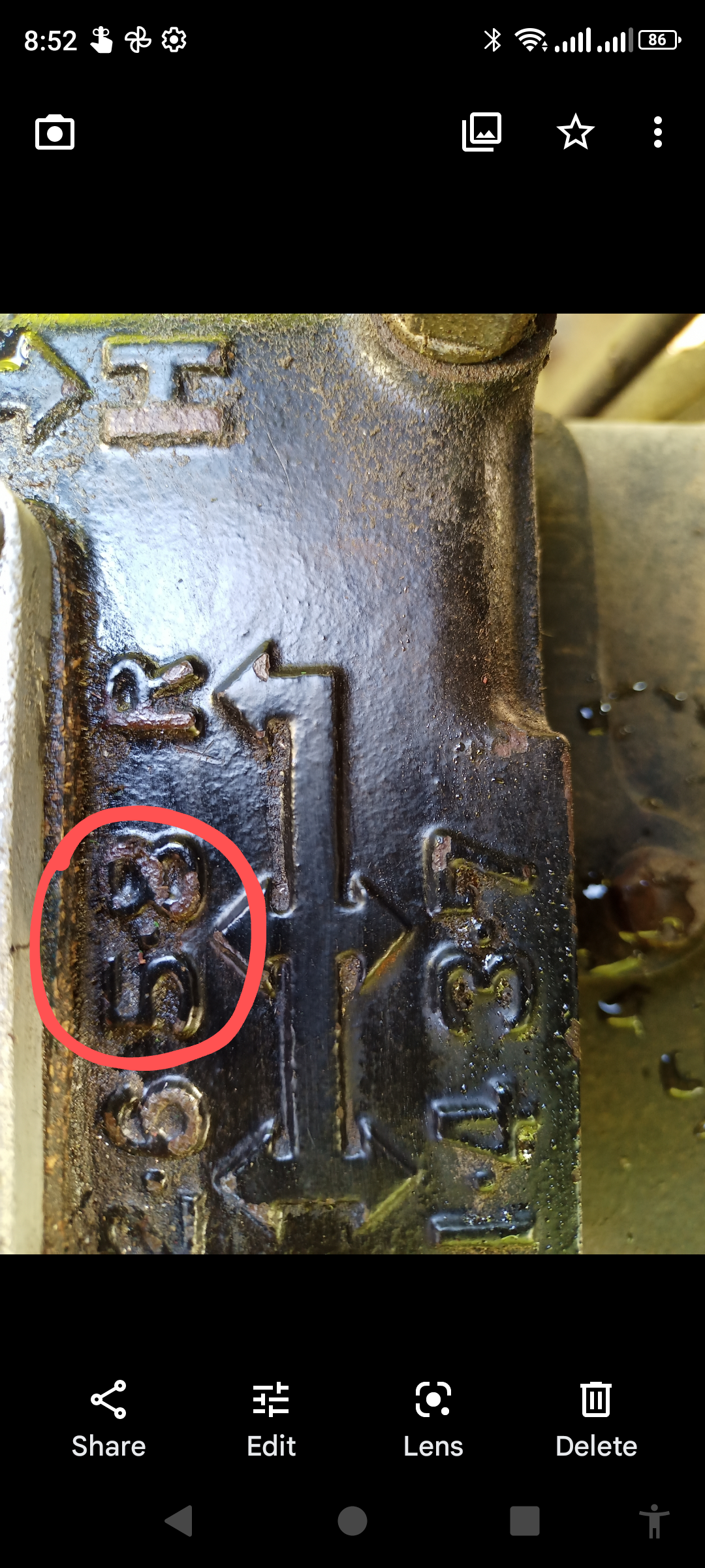

I feel like the dunce in the class. I know there has to be a forth gear some way or another, but, where is it??
   / YM240D Pops out of gear
Sorry, I'm new to tractors and described it as if I were driving a manual car. It is the 5-8 gear circled in the photo.
   / YM240D Pops out of gear #6
Ah, its setup much like the Yanmar made John Deeres. There is a HIGH-LOW toggle lever at the right foot on the tractor.
So, with the HIGH/LOW set to low, the 5th works fine? When the HIGH/LOW is set to high, the 8th pops out of gear?
I'm just trying grasp if its a weak spring holding the HIGH position on the toggle lever inside. Just a random guess really. It could also be a friction disc or something to keep the HIGH from slipping out.
