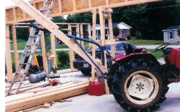

I have a 2310. It has a 4 speed PTO lever is down to the left. I use a 5' bush hog, 5' tiller, and 6' finish mower. When I built my workshop, I extended the boompole I had with 2x6's and 2x8's . I used this like a crane to lift 33' roof trusses up on 10' walls by myself. Made the job easy, the tractor held the truss while I positioned them.

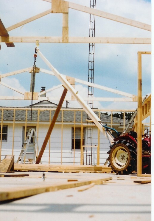

   / YM2310 #7
A better view of the extension

   / YM2310
Clifst2310,
Thanks for the replies and the pictures. By the looks of the pictures, the 2310 must be a pretty strong tractor.
I also didn't know it could handle 5ft implements. Does it get 'light' in the front end?
Do you have filter cross-over reference numbers? (Air, Fuel, Oil, Hydraulic Filters)
Thanks,
Travis
   / YM2310 #9
I use Yanmar filters, I buy mine from a dealer, Any dealer on the board would be able to help. They are all currently available. Also a search of old threads has the cross references, but I prefer orginial filters if possible because I know they will fit and work to yanmar specs.
As for front end weight I have about 400 lbs up front, Fredicks imported mine and they make a weight that bolts on the plate up front . I live up the road from his dad (that's where I got mine) and the weight was already on the tractor. With 5' attachments the front end stays down, but the front has come up trying to pick up too much weight with the boom, wheelies can be interesting with a big block motor on the boom. /forums/images/graemlins/shocked.gif
