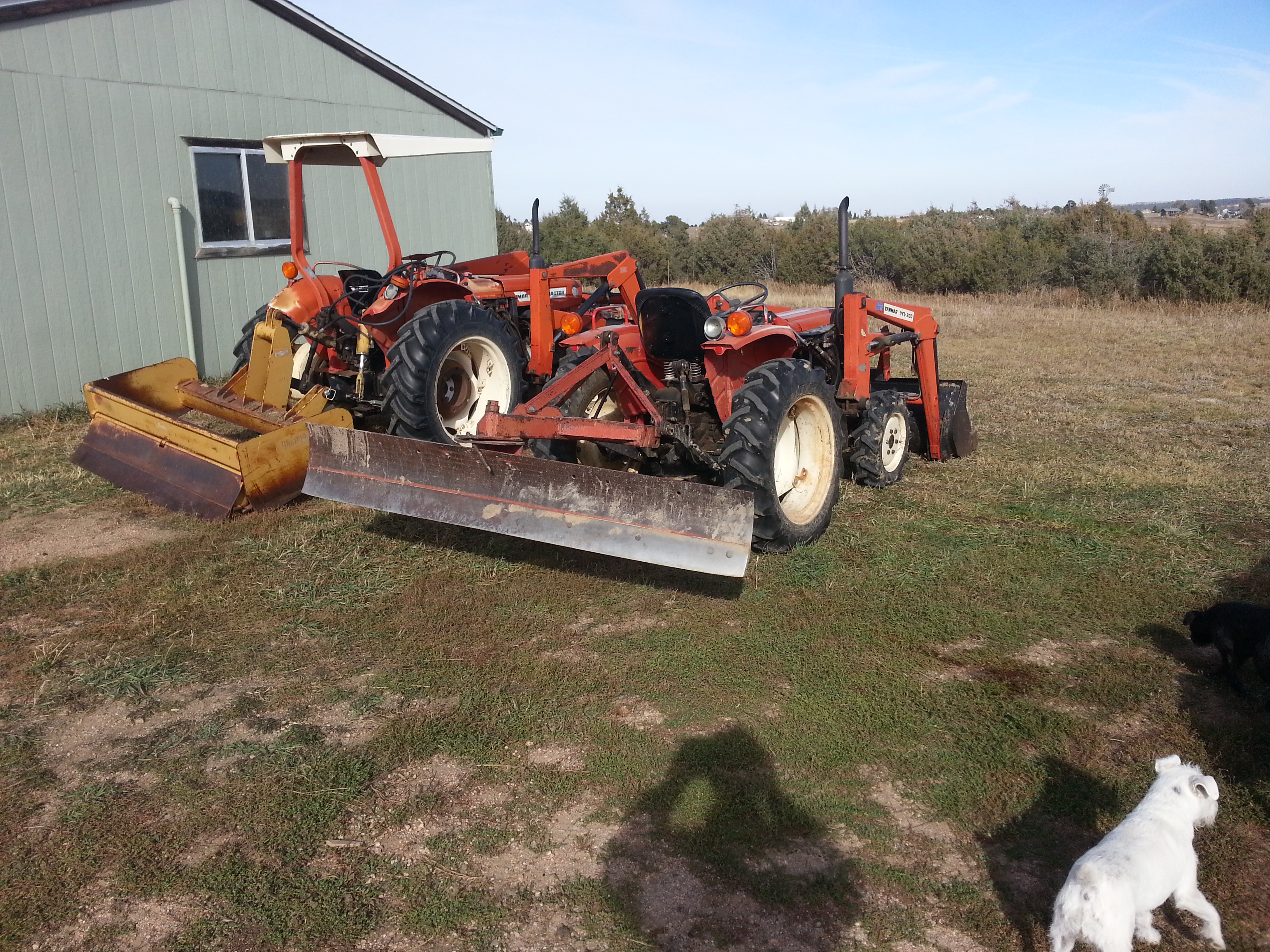

Several people have asked for a photo of the 2 Yanmars.
YM336d / YM226d

I can tell it is a lazy dog just by looking. :D
Actually that is a very high energy little terrier or maybe I took those photos an hour apart and she is still trying to figure out the next step...
