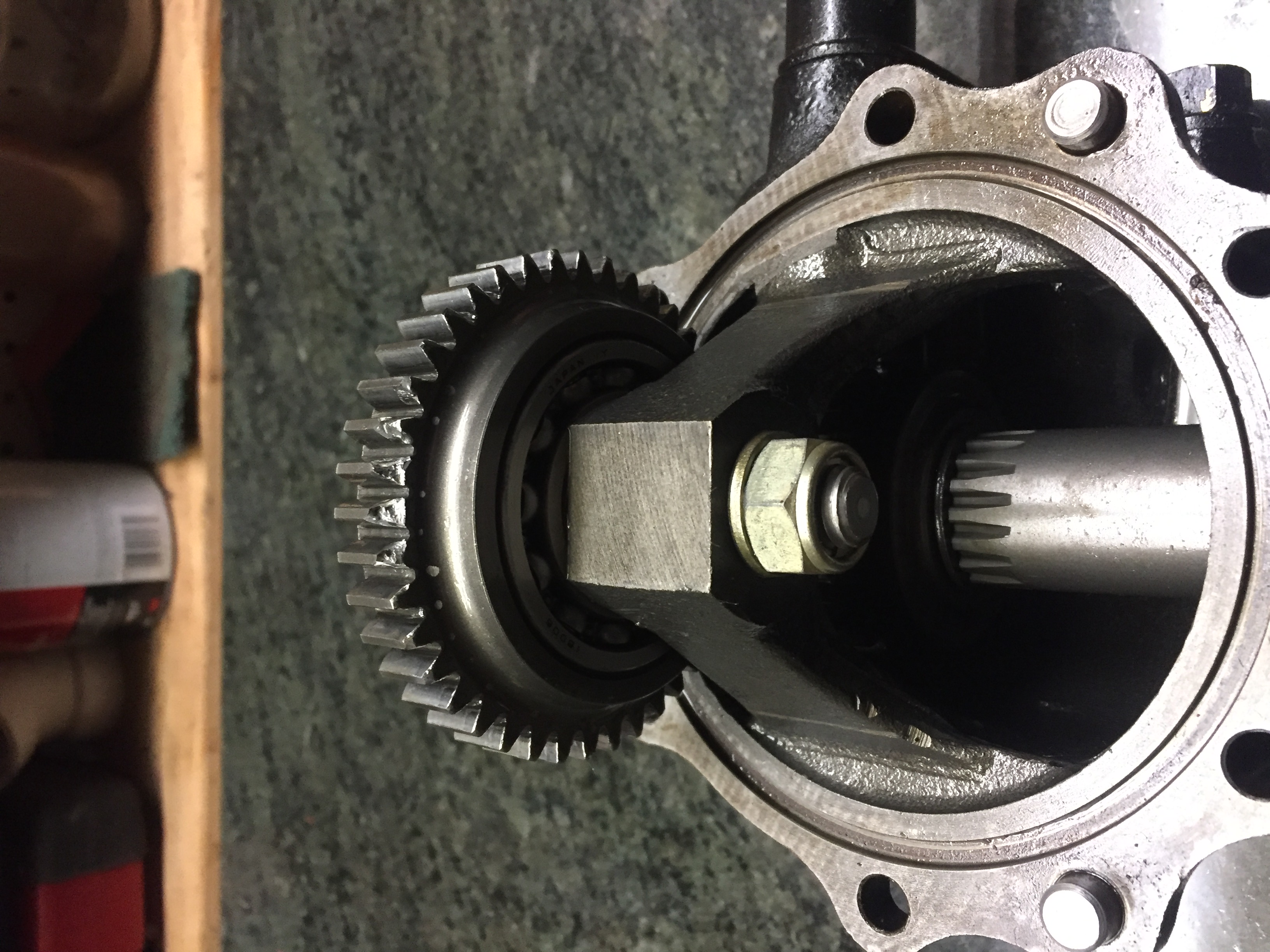

I'm searching for a set of drop box gears for my YM220d. Wondering if anyone might have any leads on parts or cross reference information (John Deere or other Yanmar) for this model?
   / YM220d Dropbox gears
Thanks for the reply Winston. Unfortunately Hoye didn't have the gears, neither did a number of other places I contacted. Luckily the damage was minimal so I ended up taking them to machinist who did a nice repair on them. IMG_0705.JPG
I also realized that someone had put the idler gear in backwards so it was barely engaging with the shaft gear, this probably why the teeth chipped. No that it's installed correctly I hoping it will be fine.
