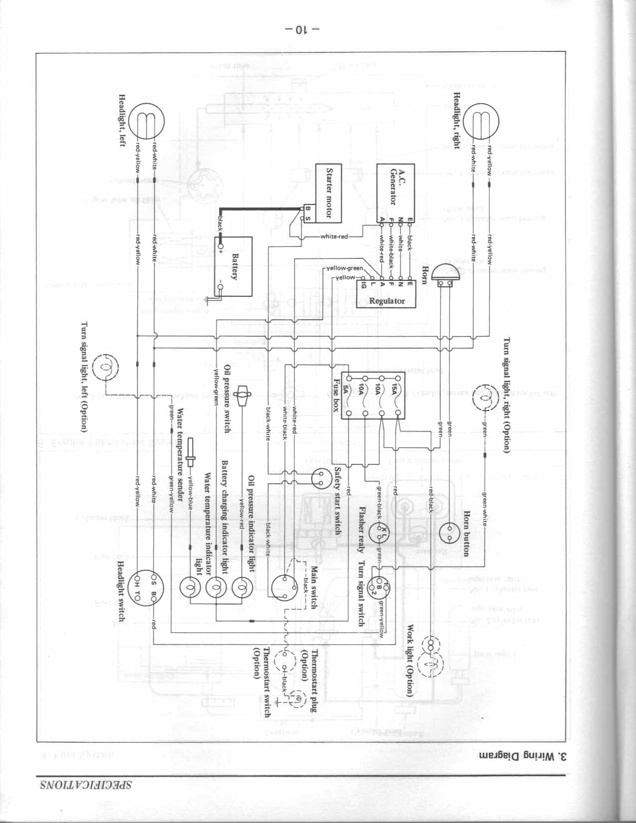

I recently purchased a ignition switch and yes it did come with a basic illustration on how to connect it, but it is has just a bit different terminals to connect the wires. I hooked the wires up to where I thought the directions told me to. I am just having a slight problem with any of my dash lights, oil pressure gauge and lights not working. It starts right up so I got that wire connected right. My question does anyone have a small picture of the wiring diagram for this tractor or one similar. Thanks
   / YM2200 Wiring Diagram #2
Danny,
I don't know if this is the same or not. This is the diagram for the YM2000/YM240. Hope it helps.
Bruce

The YM2000/YM240 wiring chart above describes a separate Thermostart switch.
Here's the YM2000/YM240 chart showing the later ignition switch, the one where you twist the key left to heat the Thermostart module, in case your YM2200 is wired that way instead.

Excellent, That is what I was looking for. Thanks

Can you take a look and see if the CD you have matches the diagram that California replied to me with? Maybe the wire colors are different than the ym240 wires. Thanks
   / YM2200 Wiring Diagram #7
DannyV, we have to take good care of the dealers who take time to post here. I suggest just trace your wires and see if they go to same destinations as that diagram.

Curtdog, the diagram in post #2 above should be pretty close to what you are looking for.
