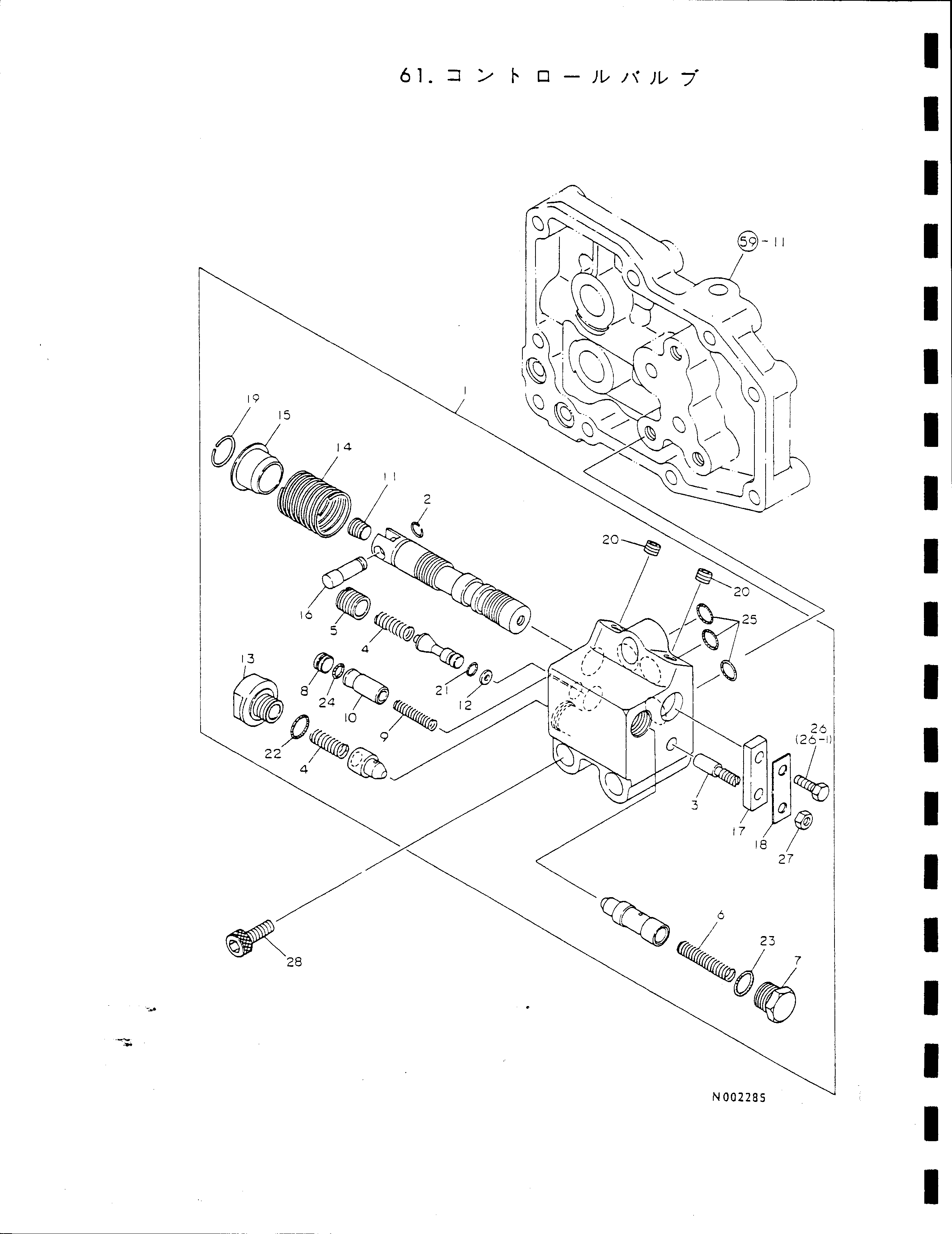

I am posting this to see if the experts here have any ideas on where to look first. I normally would jump right into this and not ask questions until I got in over my head but my tractor is outside and the weather is just down right cold and getting colder so if I can save some troubleshooting time it would be ideal.
So, clearing the snow we received last night and since no good deed goes without punishment, I was assisting two other neighbors with removing their snow drifts, and my 3pt just stopped working and I could not use the back blade. Loader and power steering (Hoye Kit) are all working fine. It just stopped lifting and dropped to the ground. Of course I was able to lift it up manually. The first thing I will check for is if there is some linkage problem, but I spoke to the good folks at Hoye who believe it could have been a failed ORing. That will be the next item, but that seems to be a challenge since it will take the whole tractor out of service until parts are available and put back in. Its been about 50 hours (a year or so ago) since I last changed the hydraulic fluid, filter and cleaned the screen.
Hoye thought it could be o ring 22 under the knob (13)
Any other theories or things to test / check?

If I'm looking at it right,That O ring doesn't look to be a difficult job. Might find something that will fit in an O ring assortment
   / YM2020D - 3 Pt just stopped working. #7
I think that's an application where the identical o-ring is needed.

I partially gave up. I got up at daylight and it was 3 degrees out. Suited up and realized quickly that I had to the take the fender off, possibly the tire and some additional items to gain access. Problem was I was suited up like an astronaut and what would normally take seconds took minutes. At the 45 minute mark my hands were numb my feet were numb and the straw that broke this camels back was I was having trouble getting a socket onto the ratchet and without thinking put the socket to mouth to assist in orientating it correctly and the **** thing almost froze to my lips. I gave up and hope that next weekend it warms up enough to work on it. I have a decent hydraulics place near by and hope they can match the oring assuming that is the problem.
