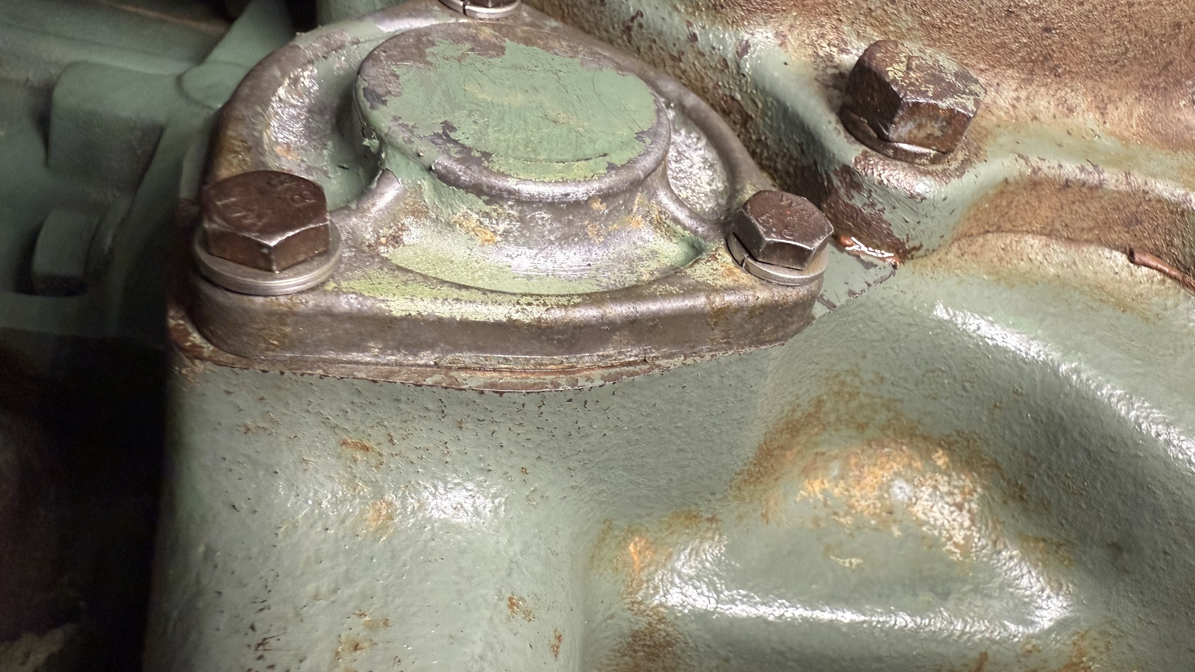

I thought there Might have been a Leak on the Filter Screen cap. (The 3 Point Circle cap with the 10m screws)

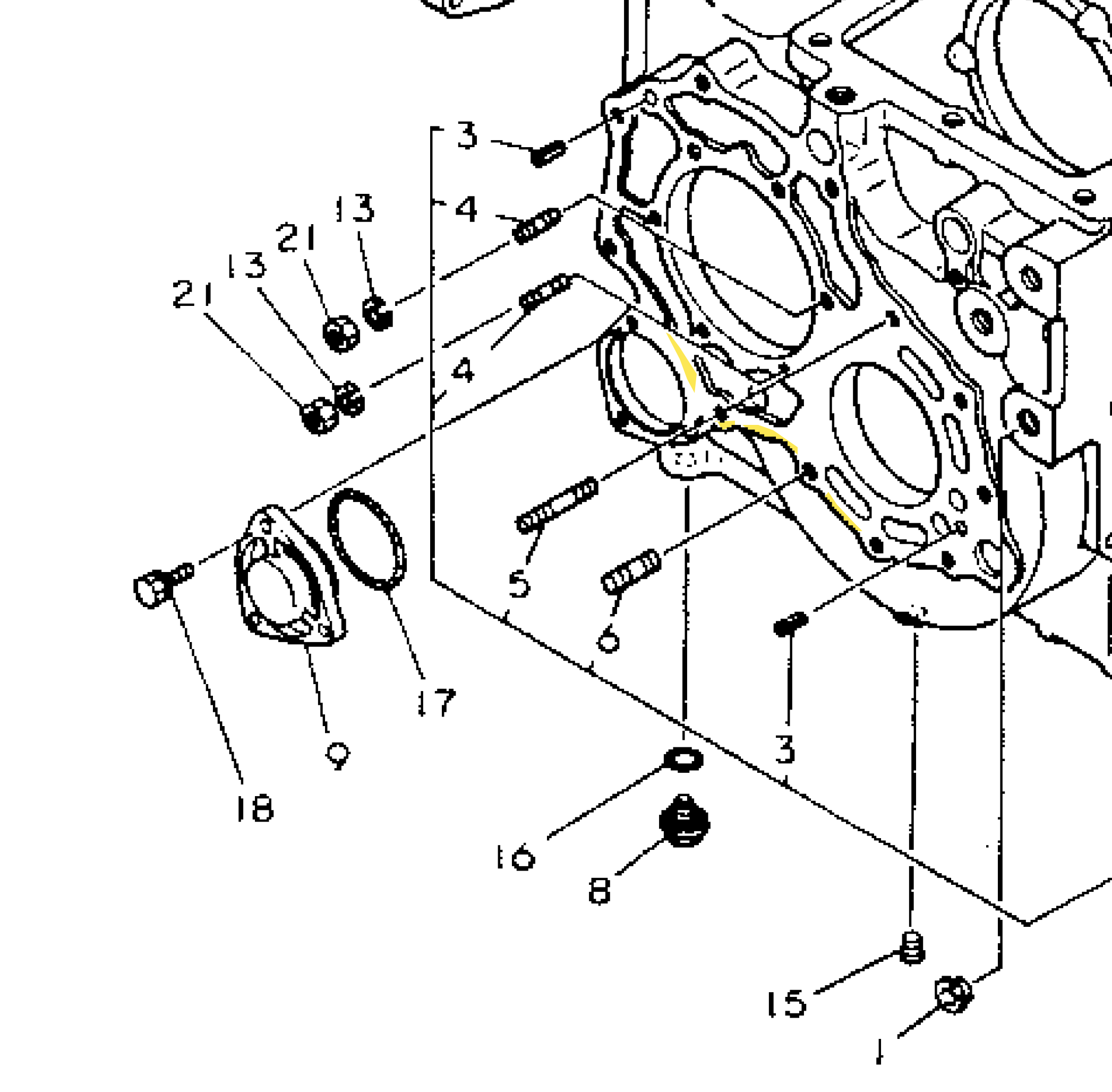

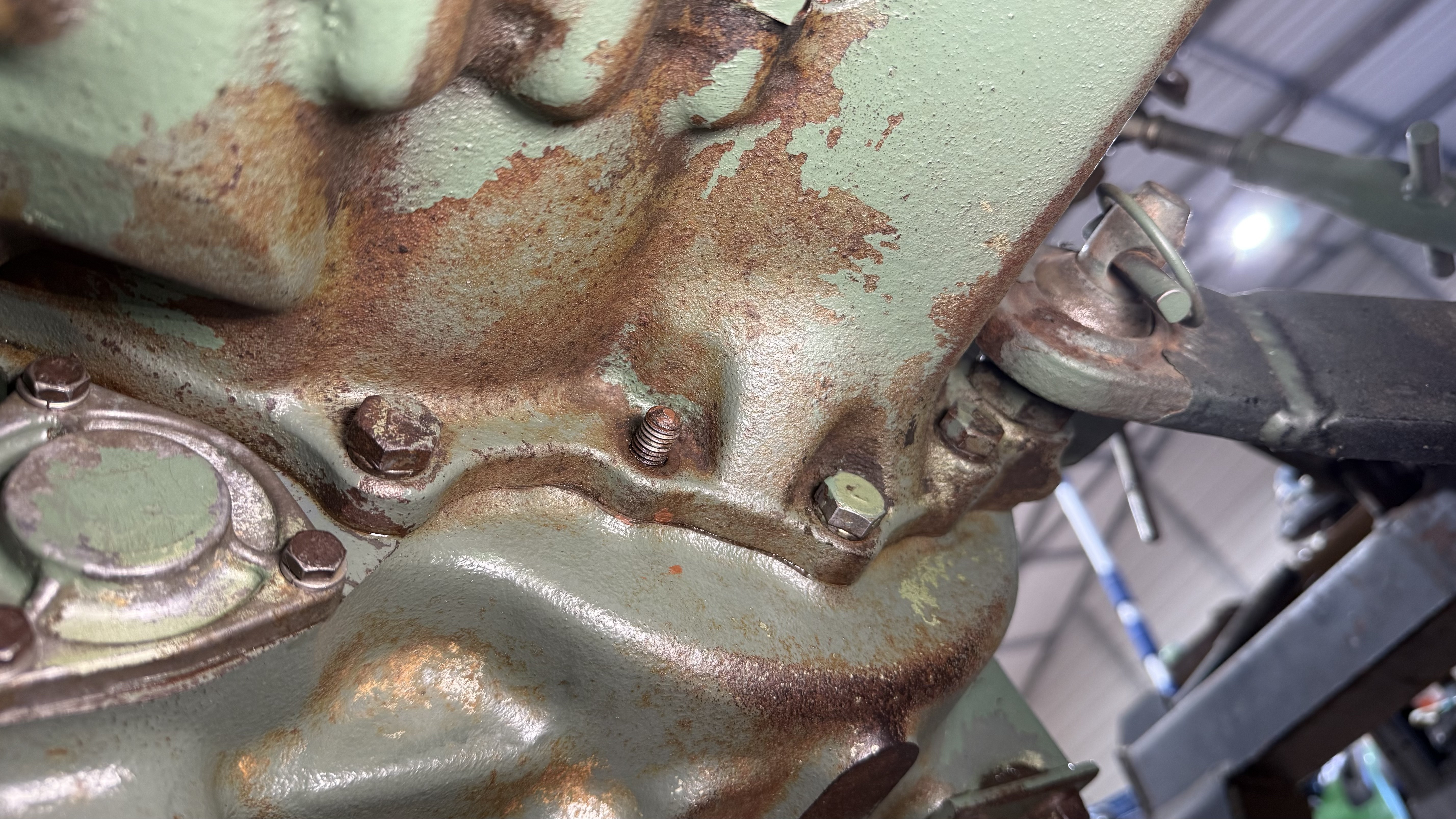

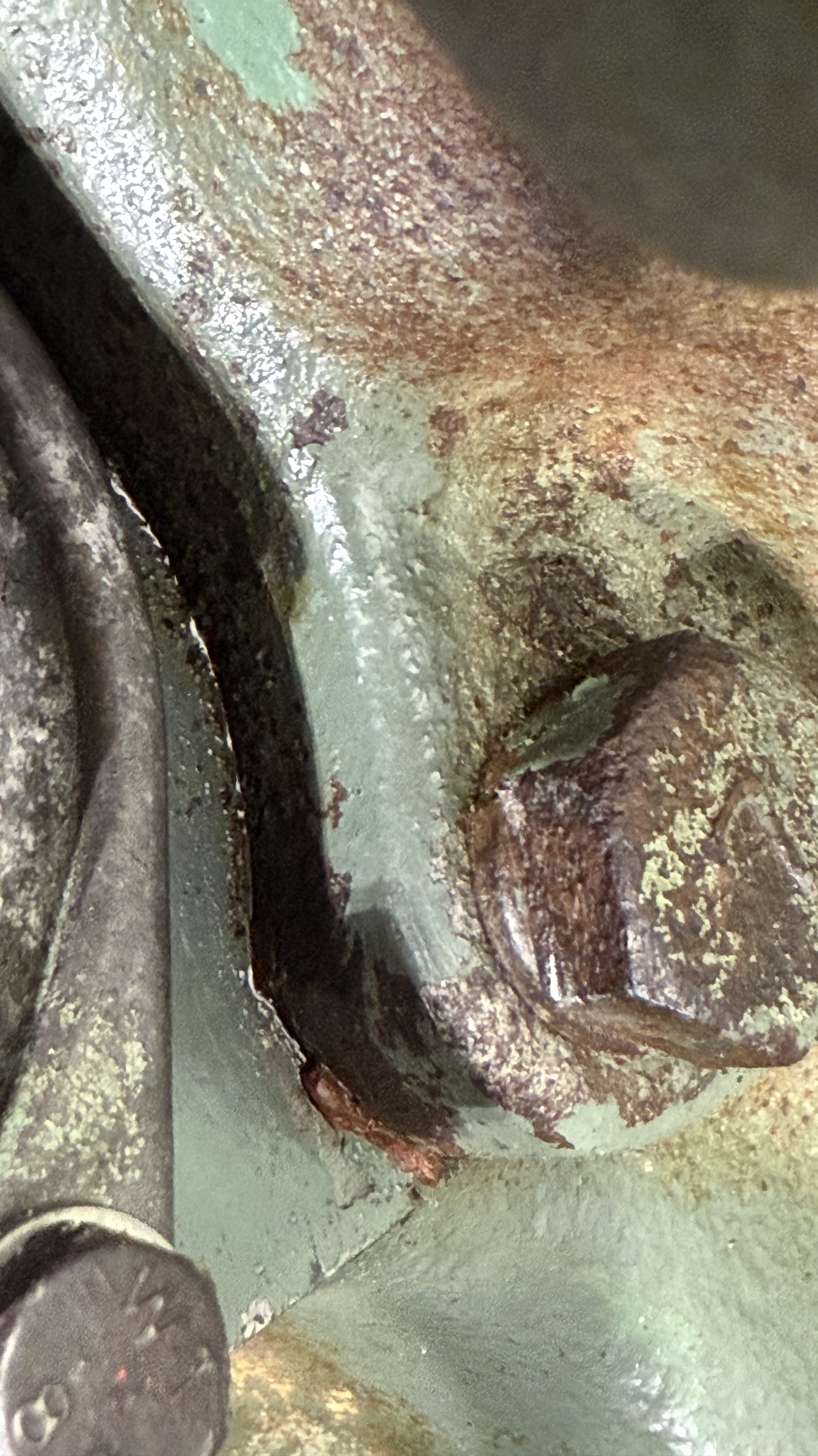

Though upon further inspection the leak is coming from where the left Rear Axel Gear box bolts to the main engine body, just above the filter screen cap. Actually a few places at that joint.
The pictures show some shiny spots in the cracks between the two chassis pieces. they apparently leak much more than I thought. like a lot more.
Question: being so close to the intake, could after the tractor and the hydraulic fluid heating up, cause air to be sucked in to cause the cavitation?

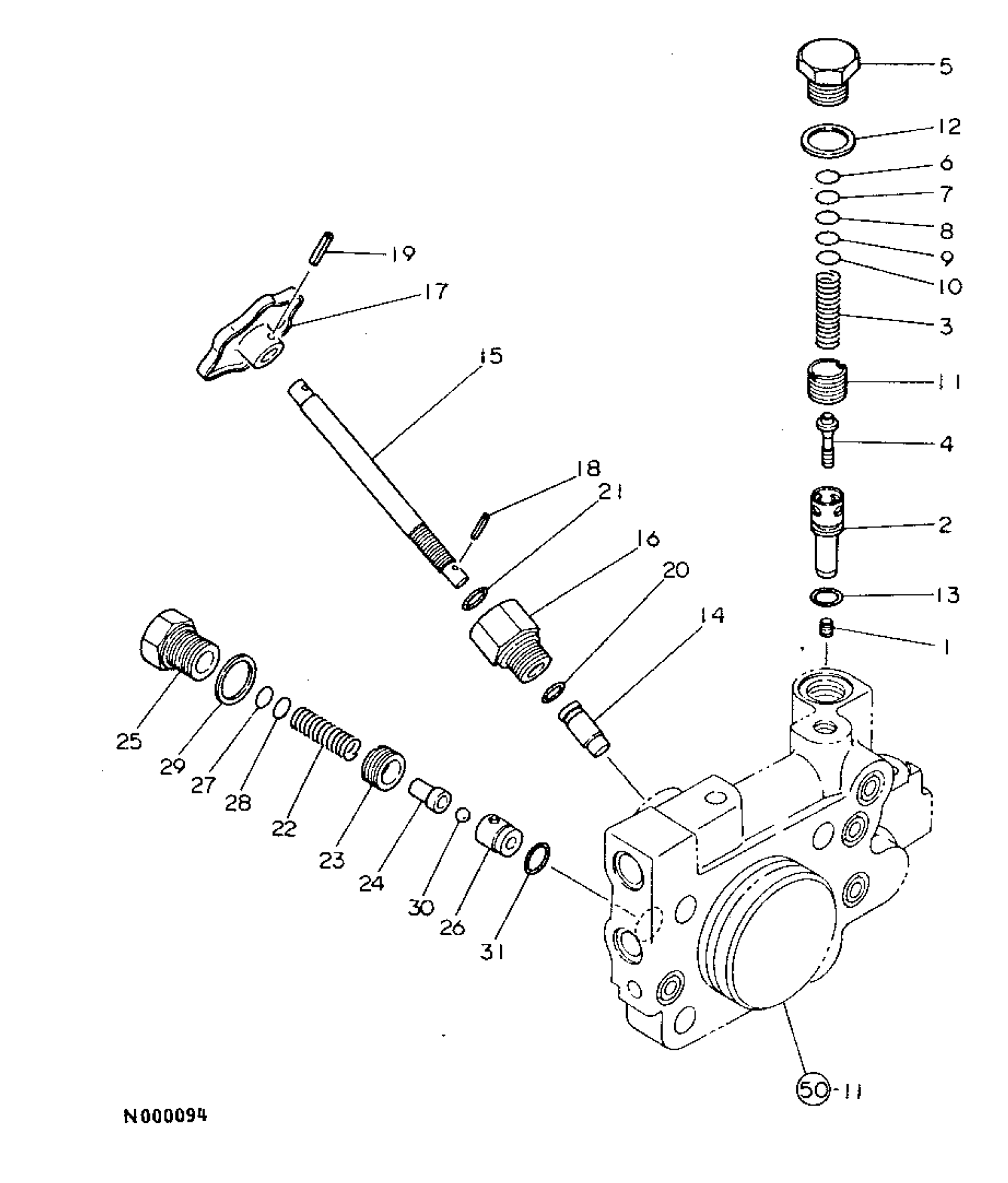

Question: Could this be one of the spring, o-ring contraptions that control the pressure? The Numbered Items below.
Yellow parts re where I see the oil seeping from.

Your main relief valve is the one on the top right of your picture. It would be set about 2123-2275 psi with engine at 1500 rpm and warm fluid.
Your safety relief valve is the one one the bottom left. It's function is to relieve such as when your going down the road with a heavy implement and hit a pot hole. Your implement bounces and causes high pressure. It should be set at 2417 to 2702 psi. These numbers are out of a 220/226 manual. I am confident it is the same system you have . I owned a 2002D for several years.
You are sucking air into the suction somewhere.

Is it possible that the Air is coming in the place that its leaking on the chassis case?

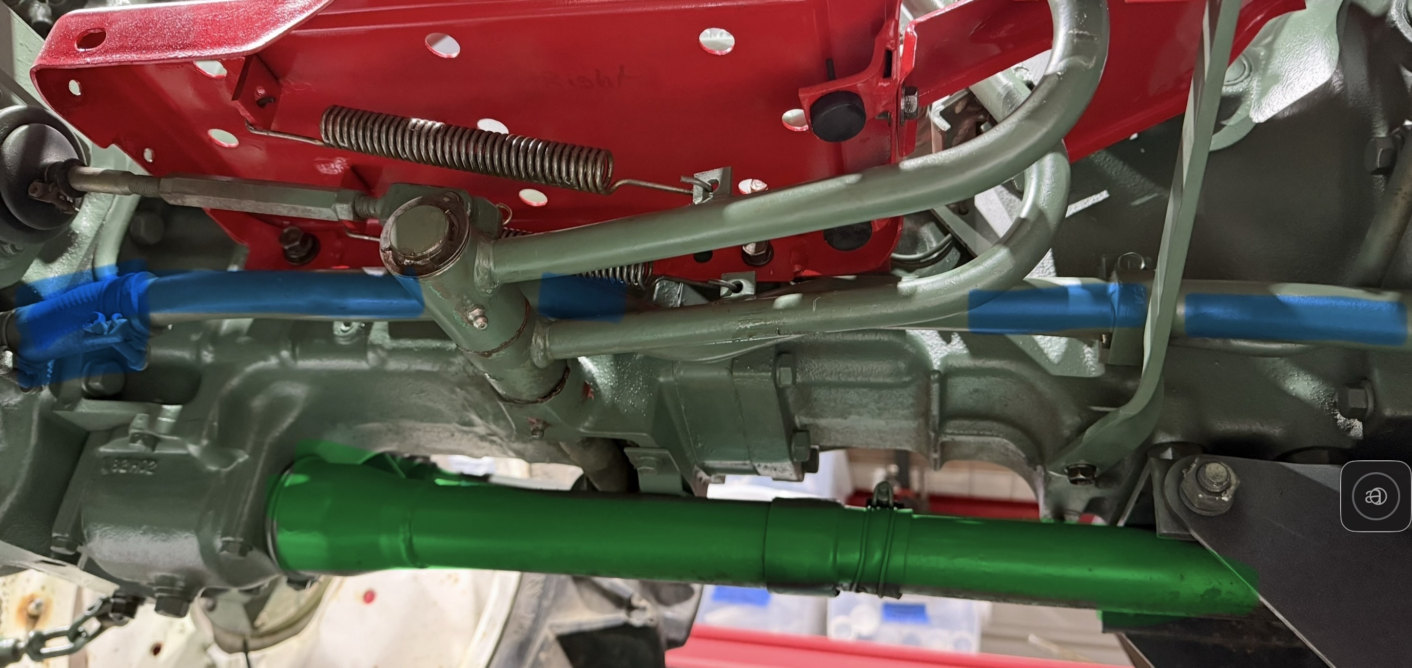

You talking about the hose at the left of the Blue highlighted line? I have yet to replace that. The other hoses looked fine, so I was thinking of cutting one of the ones with the 90º bend to fit the strait section.
The Green Highlighted transmission shaft. Does that also carry the Hydraulic fluid to the front Axel/Steering? Those clamps around the rubber parts are not 100%.
We have seen several times where that blue section of hose on the left was cracked (dry rot) or loose and would suck air. Many times it would not even show a visible oil leak.

On the Pic. of the O-ring contraption I'm showing O-Ring #OR-600 and a smaller O-rings just above it. No part # on the small one's though?
