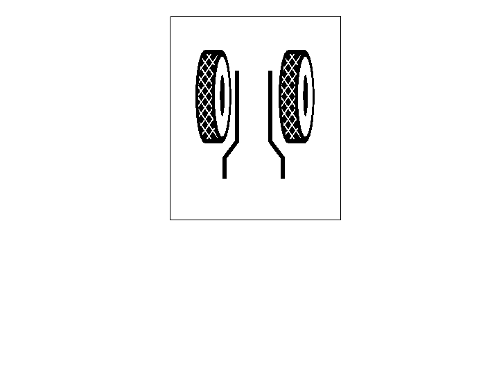

1. After careful review of my problem with implements banging into my rear tires, I noticed that I only have chains on the outside of each sway bar. I don't have a center drawbar post nor any chains coming from the inside to control the spread of the swaybars.
That's all I have on my 2000, with an implement attached and the chains snug they should not hit your tires. I did replace my straight lower arms with the kind that flair out at the end. (See Hoye) That keeps the spread past the tires. I turn all my pins in on all my attachments to keep the spread to a minimum. See my drawing, the view is from the rear looking down on the arms. Hope this helps...

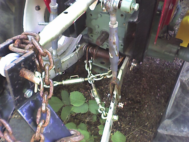

You could cross the chains on the inside, which is how they work on the illustration you posted. That's how I did them on my 1602D........

That's the way those sway chains are supposed to work. Right chain controls the left side and verse vica. You can reverse your rear tires for a wider stance if not already done.
