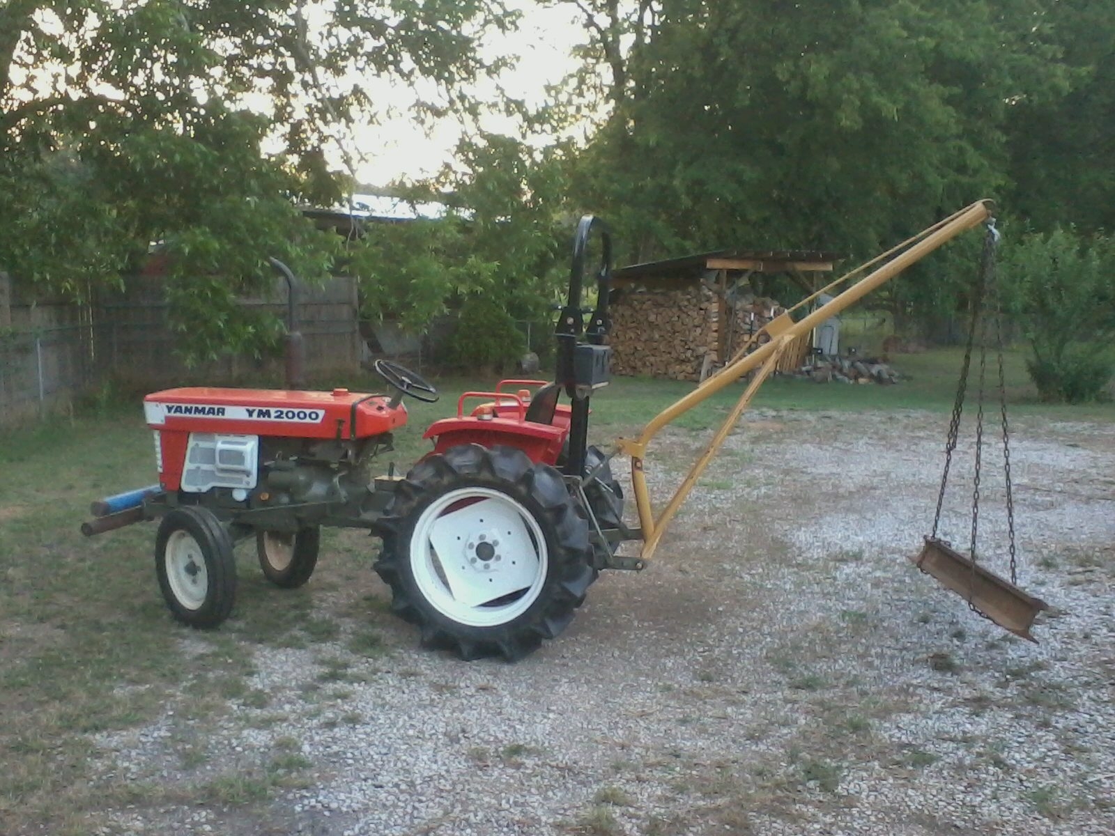

I have a 3" solid Stella bar up there that's about 38" s long welded to a 3" I.d. pipe filled with lead thas about 32"s long. Total weight for the 2 is prolly 175 pounds. It holds the front of my 2000 down pretty well. Perfect for a bush hog still not enough when I used my diskharrow ballested with a hundred plus pounds on it.

OK, here is the initial post i made. This is just when the SOLID steel bar was up there, i later added the 3" lead filled pipe about 1 year later. It sits on same bracket welded above this bar, it is also shorter 2"s or so maybe more on each end.
http://www.tractorbynet.com/forums/customization/155051-new-bumper-weight.html
Go to post #9 to see it.
Its a bit croked but i have repositioned the brackets to level it out more, but its not for looks but futionality.
Still will try and find a picture of how the both look.
EDIT: Looked on my computer here at work and found a picture where both weights are on in. Not the best pic but you can see it. I have better ones of the setup but you can get the idea with this one.
   / YM2000 front weights?
Thanks for posting that, it looks like you used the existing holes in the bumper to attach the brackets for your weights, I like it! Nice looking tractor.
