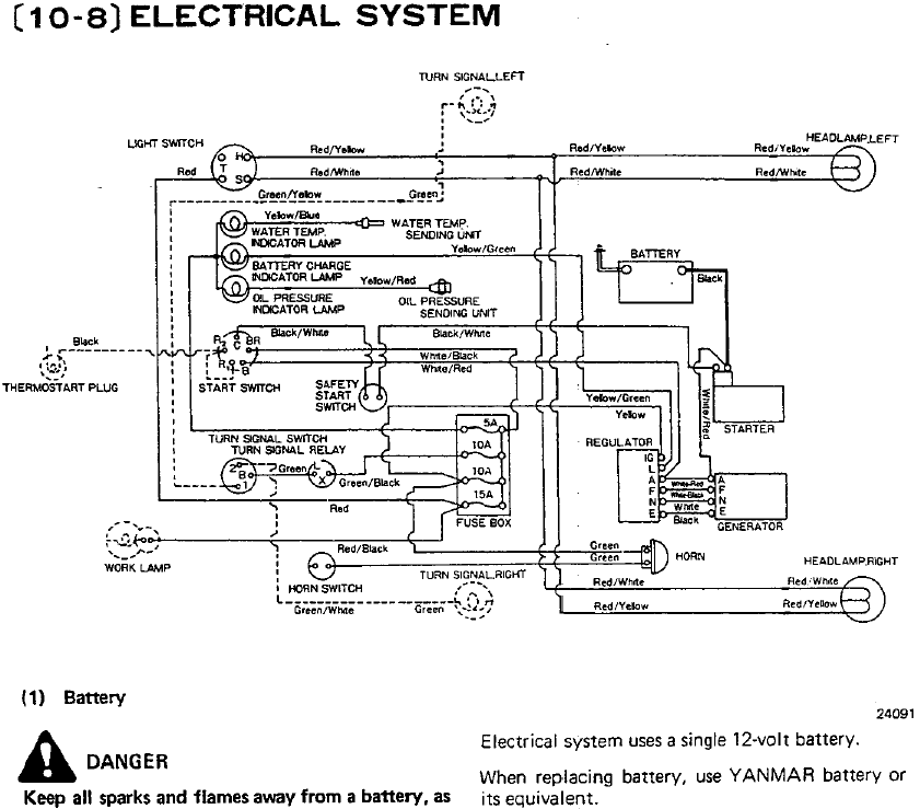

I have two sons who will be using the machine and I know how dangerous tractors can be so I want to install a Clutch Safety switch. I need help figuring how how to wore it in to the system.
I have already mounted a switch system from a YM240 on the unit.

This may help you. The YM240 is basically the same tractor as the YM2000. The start safety switch is Factory on the YM2000B. Which is located on the clutch pedal. The Late model YM2000B has all the Electrical Bells and Whistles. Last production model!.

Thanks! Thius should allow me o do the proper wiring. The swit h is already installed, adjusted and tested using a VOM!
Thanks again!
