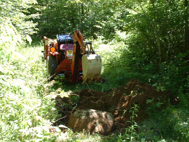

Ok, so the test hole was dug and filled. It was time to move on to a rock. I have a trail that connects two area of property. This trail is flat and packed earth but being that this is the Granite State there are a few large rocks on the surface. I had a mower deck on different tractor that would bang into one of these rocks so I decided to pull the rock from the trail using the Yanmar. I set up the tractor at one side of the rock with god placement for the backhoe. I dug around the rock with the backhoe to free the rock. Eventually I could move the rock with the backhoe bucket but I had to move the tractor to the other side of the hole due to the shape and position of the newly uncovered rock. Once set up on the other side of the rock I was able to curl the backhoe bucket underneath the rock and pull it up the side of the hole. Then I moved the tractor forward and dragged the rock down the trail, dropped it and spun around, then pushed it into the woods with the loader. The rock was about 2x1x1 feet in size and had the loader bucket been deeper I could have lifted the rock without it falling out and moved it that way. I ended by backfilling the hole and supplementing it soil from elsewhere.

Here is a picture of the rock in the hole before I moved the tractor to the other side of the hole and dragged it out.

MDL, that's a nice size ornamental "sitting" rock! A trick that works for dealing with large rocks in holes is to use a spare tire chain as a sort of net to wrap around the rock so you can get hold of it.
