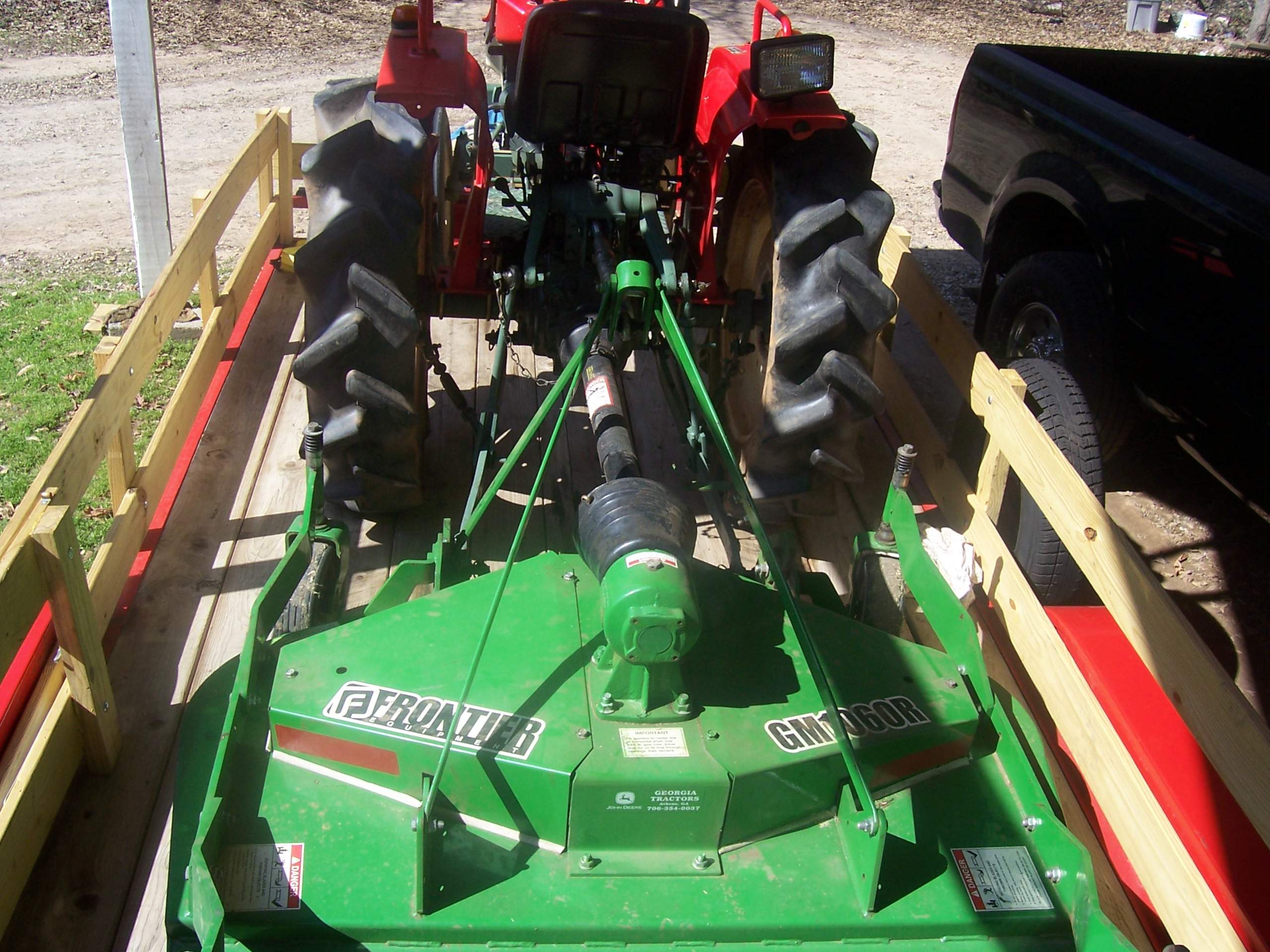

Hands down which way I would go when you see the pick. Adding or removeing nothing to it piece of cake :thumbsup: Frontier is made for JD. by Woods.Can't see from the shadow it's a GM 1060R Behind 24Hp.or 20 Pto If that matters.
