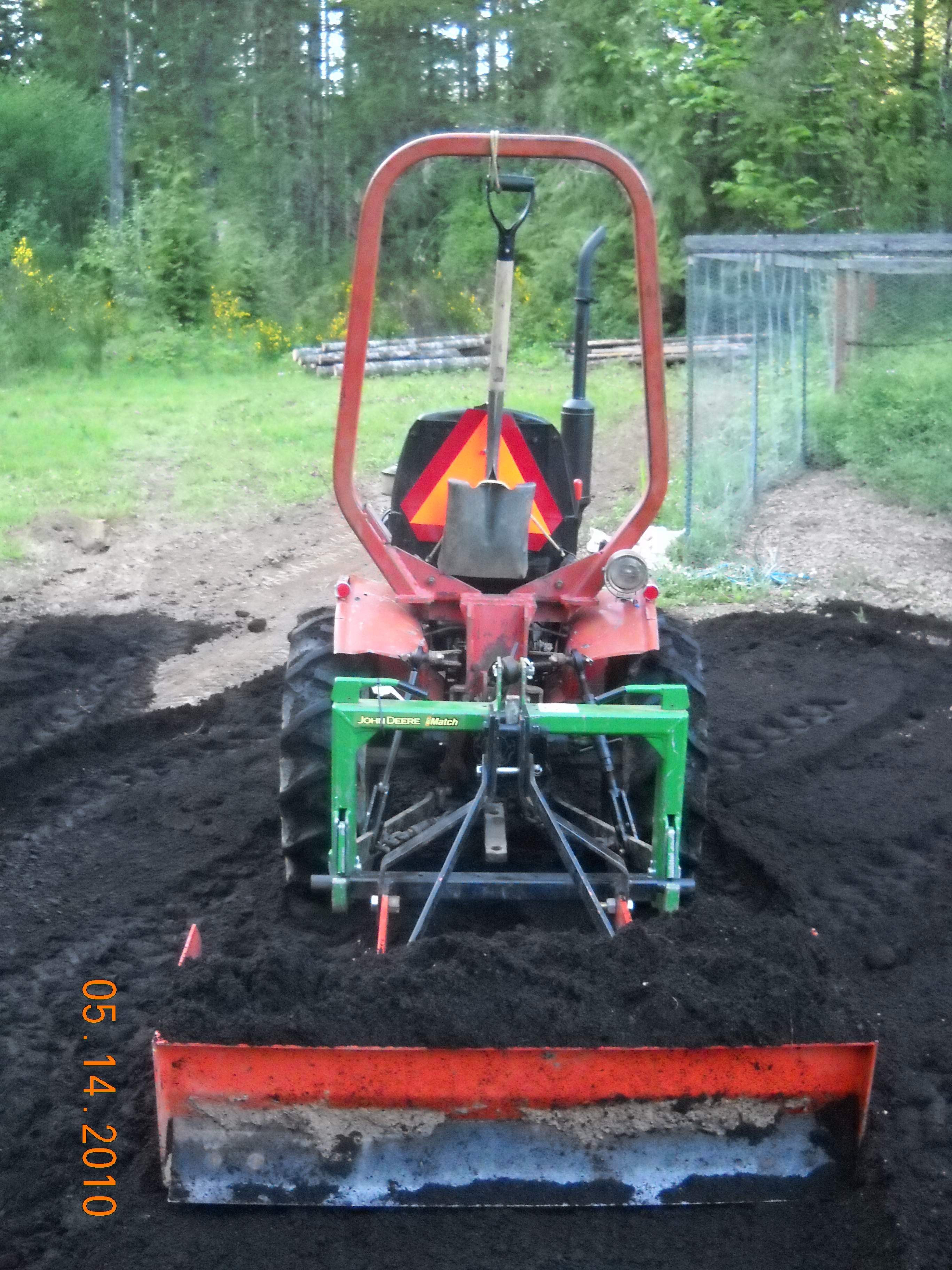

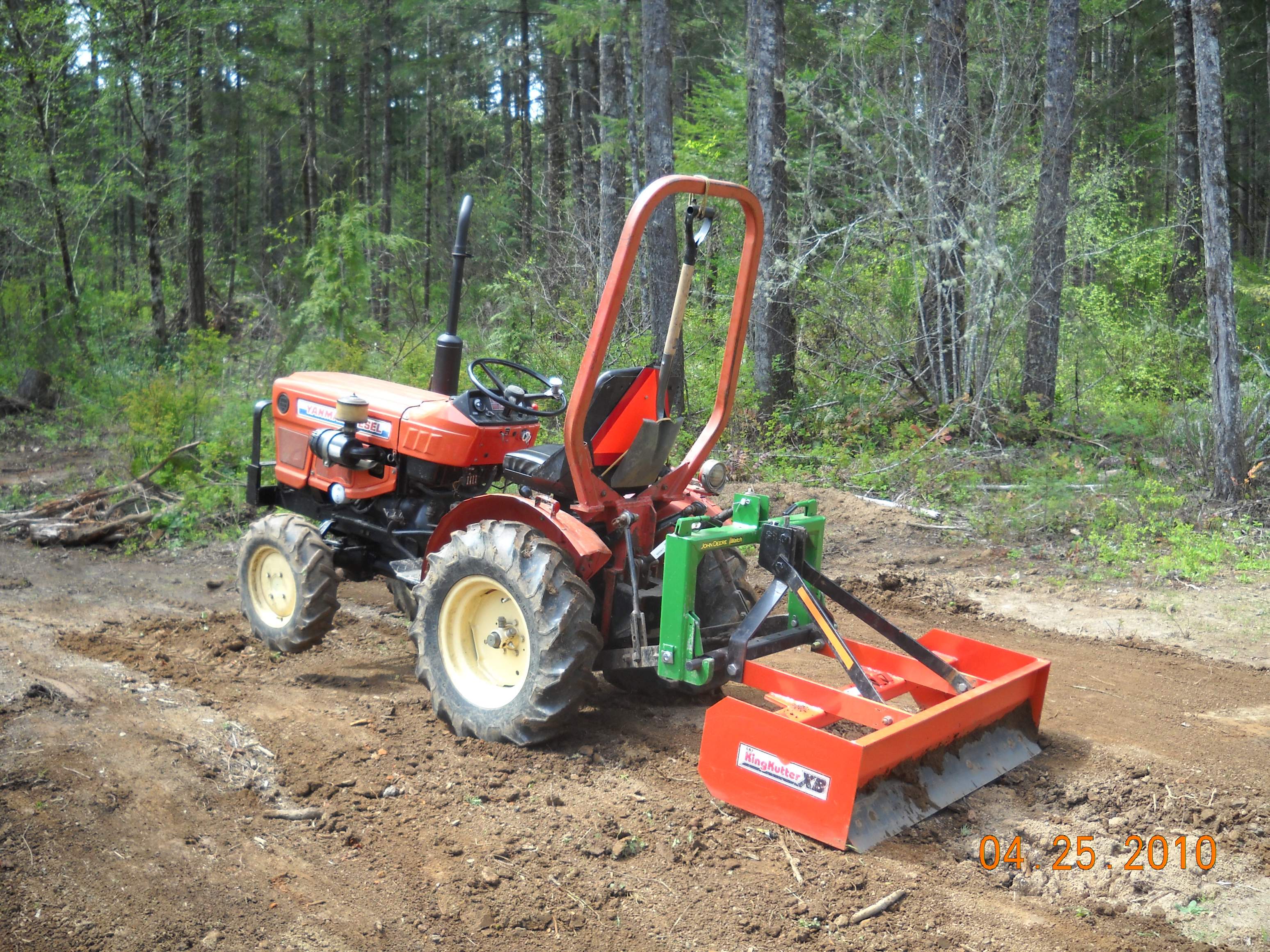

you can pull the 4 footer with a full load of dirt but a 5 footer wont be able to move with a full load. Also, when i use my boxblade, it occasionally will get packed full of dirt and when you lift it up you will pop a wheelie or it wont lift it at all. Also, watch for roots when you are digging. The picture shows what happens but since all the power is put onto the back wheels and since they are slipping so much, it can be a very rough ride. :confused2: with the R3 turf tires on your tractor, i'd look at adding weight to your rear tires and possibly even chains for extra traction. A 4 foot boxblade will pull a little less than a 5 footer but it will be more efficient since your tractor will have a better match size wise and will be more productive since you will be able to work faster. I can fill my 4 foot boxblade to where the dirt is falling out the back in 2wd on level ground.
