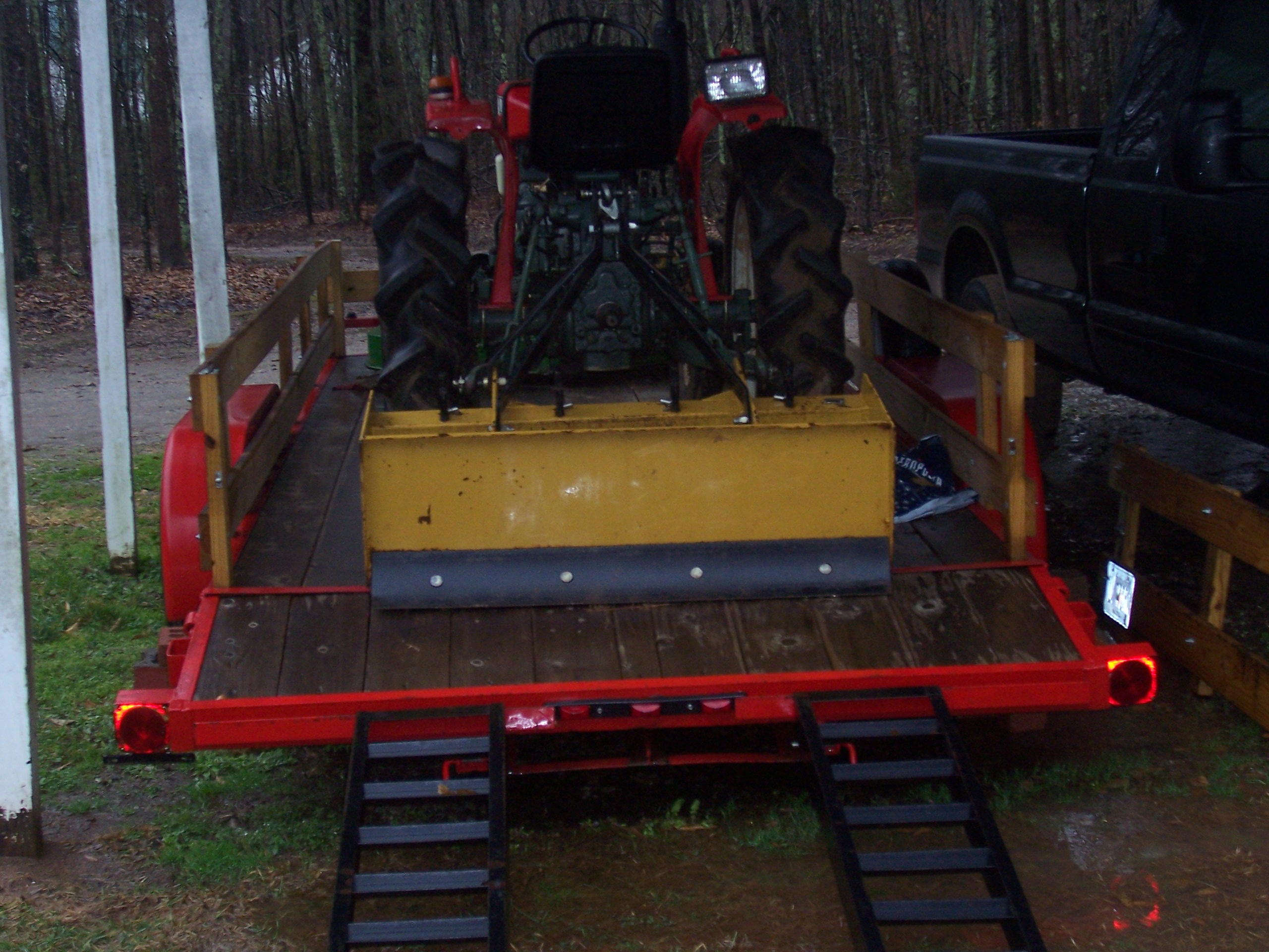

I have a YM1500D and am wondering if it would pull a 5' double row disc harrow. My buddies tractor (Belarus 250AS) is broken and we have the 5' disc harrow, 5' bush hog and 5' box scaper. I am hoping I can pull the harrow to till up the food lots that haven't been planted in many years. I am thinking if I buy a single bottom plow and pull it first, I should be able to disc it much easier with the 5' disc. I think the disc weighs about 700 lbs. I do not know what the lift capacity is on the lower arms. I don't want to hurt my tractor. The fileds are approx. 2 miles from the implement storage and I don't know if I can hook the disc and lock the hydraulics up and drive that far on dirt roads, then drop it and work it.

Now to answer the post question, 5 ft implements that are ground engaging in my opinion are to large for your 1500, not sure of the lift capacity on the 1500 but at 700 lbs I would think you are getting REAL close.

To give you a good idea this is a 4ft BB behind a ym2000 24Hp.Covers my wheel tracks perfect The pic. above is a 5ft. tiller. I can load this BB up and tell it's back there. Only 18hp.and 4wd is not much help when all the weight and drag is on the back IMO. After thinking more about it 5ft. No! and the tiller even sounds better now. a good rule of thumb 4hp. per foot
