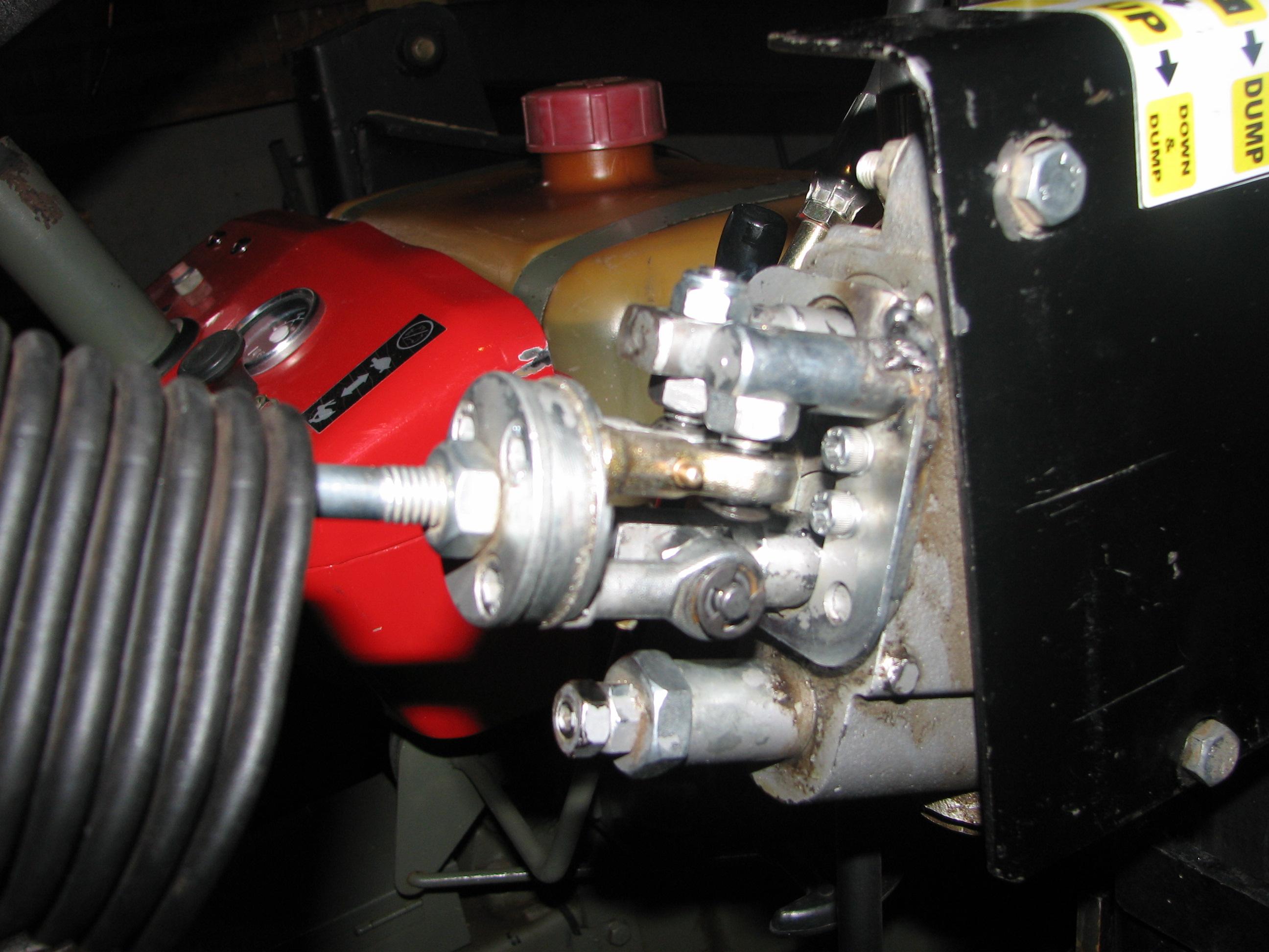

The drive shaft saga: THe drive shaft broke the 1st time I put the tractor in 4 wheel drive to move snow. When I took the drive shaft cover off, I discovered that all the parts were not there. I got a diagram from Fredrick's out of Alabama and found that I needed snap rings, spacers, ball bearings and a rubber boot. I obtained these parts from Fredrick's. I had to fix the output shaft on the transfer case as it was boggered up and would not accept the ball bearings. There was no lubrication either. After repairing the output shaft and assembling with all the proper needed parts it seems to be working fine now.
The Bulldog loader joystick saga: When I stated that the joystick fell off in my hand, the entire control assembly came off. The snap rings had fallen off
of the control valve bolt which held the assembly together. There is a stationary part of the assembly that had a broken weld and this allowed the entire thing to collaspe off. I need the bolt and snap ring assembly because the bolts are stripped and the snap ring area is worn out and will not hold the snap rings in place. I would like to get replacement parts before I go off and try to find another way. I going to try to attach pictures of this assembly area so you can see what I am referring to. You can see the welded area at the top right hand part of the assembly.
Hope this clarifies the support issue that was raised earlier. I appreciate this site and have learned a lot. For example the reversing of tires which I was told by Hank was a good idea for safety reasons turns out to NOT be a good idea because of pressure on the spindles. Hopefully other who have their tires reversed will think about turning them back the way they should be.

Richard, on the plus side:
  • You now know how to post a picture;) and you're obviously getting better at using the PC.
  • You've found a forum for information and you know where to get parts (and we are usually very competitive on parts).
  • You apparently have a good enough mechanical background to get through the repairs once you know what is needed.
  • You have a model with good parts support and one that is relatively easy to work on.
To play devil's advocate, you didn't go back to the seller with some of these problems, however....I can certainly understand why. Did you agree to buy a certain model by number (i.e, 1500) or did he actually agree to sell the one you were looking at and then just pull a switch? If that is what happened, that is just outrageous. You can certainly help him out by making sure your neighbors, etc. know how you were treated.
Best of luck to you.
