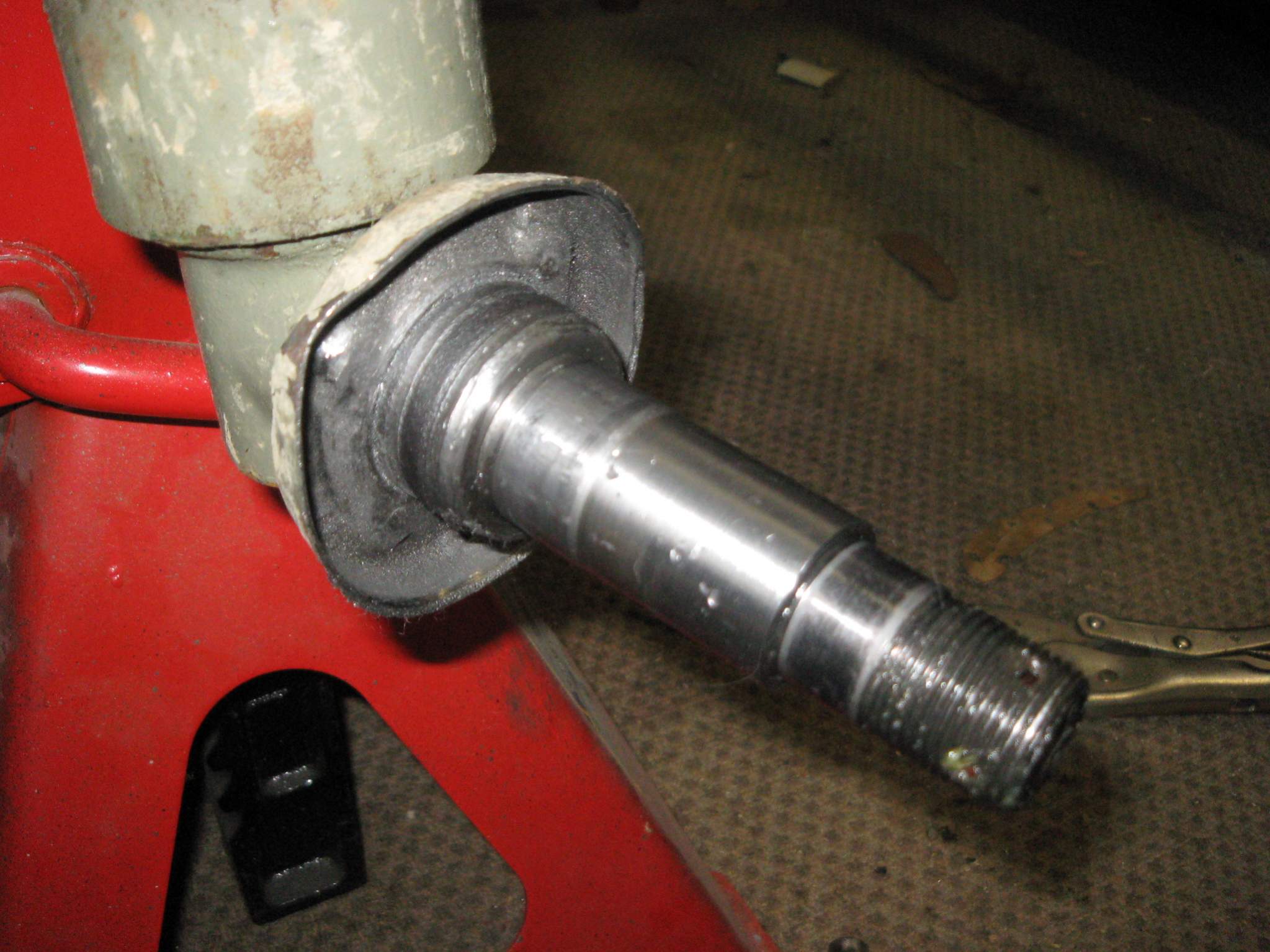

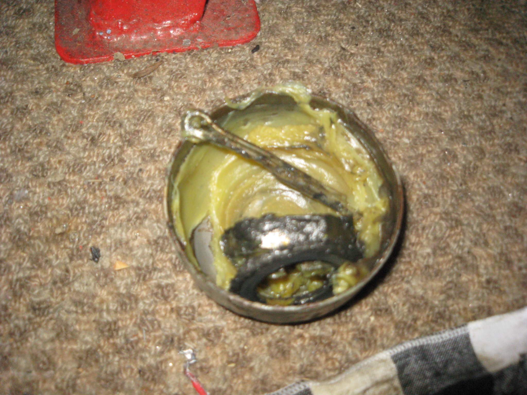

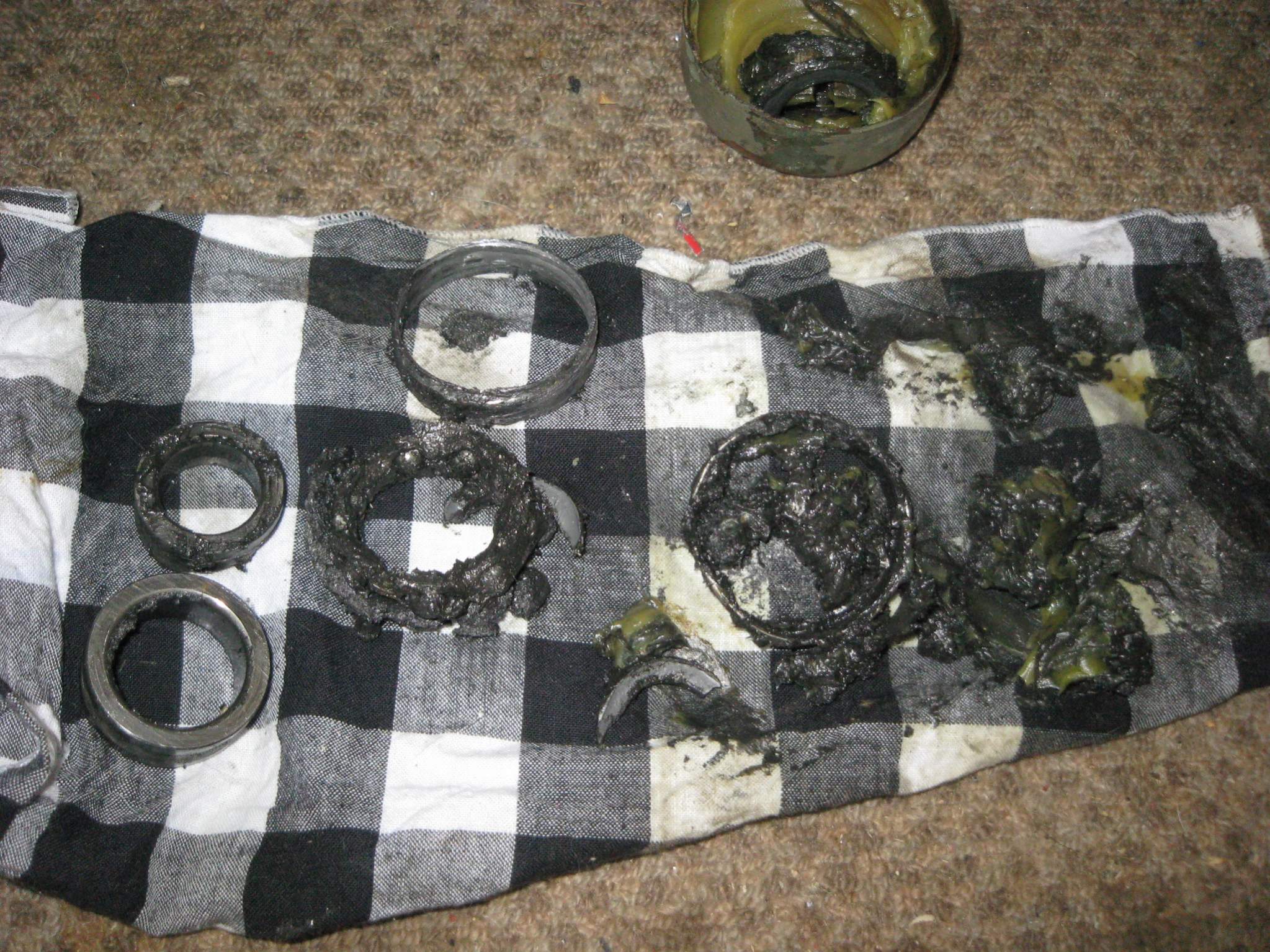

Here are a couple of pics of what is left! first photo has remainder of inner and outer bearing and a pile of ground up metal and grease, you can see the multi purpose grease in pic 2 and the stub survived. only a bit of damage to the seal cover and run area but i am not going to run a seal anyway so it doesnt matter about that surface.

So do you have a FEL on your 1500? I can see in the pictures the bearings are destroyed but it looks like there were still grease on them, I would have thought with even minimal amount of any kind of grease this would not have happen unless the grease became contaminated or under very heavy load like with a FEL, or if this were possibly one of them refurbished yanmars? if so then well you know the rest of the story:(

well now I do relize with this happening to your tractor that it may well can happen to mine, now with me having installed a FEL, The thing about the Refurbed tractor was ment that if there were a bearing issue from the refurb then they would have most likely as you stated packed the cap full of new grease and let it slide, No punn intended;) and never bother to install a new bearing and once you put the extra weight on it then it wound up finishing off the bearing, these tractors are not like cars or trailers that will ever see speeds fast enough that heat up the grease to melt it down, so I couldn't see as to how would ever loose the grease in that mannor... so the idea I had of the zurk fitting may not be worth the effort..
in your case it was probably most likely the weight issue from the loader as will be with mine if ever have bearing problems,
