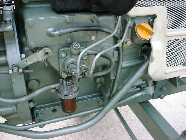

That 67 hours is probably 1067. Sorry but I thought you should know. You are lucky to have a Yanmar because the system is actually very easy to bleed if you run out of fuel. You don't even have to bleed at the injectors. I have attached a picture. Do you see the screw head on the fitting with the fuel line running from it? It is just above the injector lines. It has a phillips head slot in it. Open it slightly and you will have fuel with bubbles coming out. When there are no more bubbles, close it and try starting it. Sometimes it is easier with 2 people. One cranking and one tightening. I don't recommend using a phillips screwdriver, use a 10mm wrench instead.

Thanks for the tip Brent, I did bleed it at the injectors, and if I am ever stupid enough to run it out of fuel again I'll use that technique you suggested.

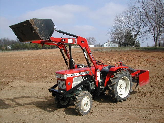

<font color="black"> That is all that matters. When the tractors are shipped from Japan the tires and wheels are removed so your tractor doesn't have the original tires and wheels on it. It does however look to be repainted. The chassis color is not quite the same color as the original but the biggest give away is the decals. YM1500's don't have decals on the hood. On an original 1500 what appears as a decal is actually a very thin piece of aluminum with the letters and numbers printed on it and the sheet of aluminum is pop rivoted to the hood. And the design of the original letters and numbers is different than the decal. Raise your hood and look on the inside of the hood behind the decal and see if you notice any small holes. They maybe filled with paint. Are there any silver decals on the fenders with Japanese writing on them? There should be. Regardless, you have a nice looking tractor. If you ever need anything, feel free to ask. Attached is a picture of a 1500 I had. </font>

Anyway thats a nice looking 1500 you had, I am looking around for a bucket for mine. A local guy builds them for 1500's and other models, and charges $1500 installed, does that sound like a good price for a new loader? They are fairly basic square stock construction, not nearly as slick looking as yours, smallish bucket (I may be biased there as I am used to much larger buckets) and new valves, hoses, and rams from northern tool. He also makes similarly constructed backhoe attachments for $3000 installed.
