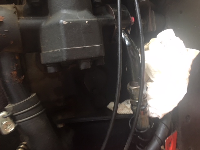

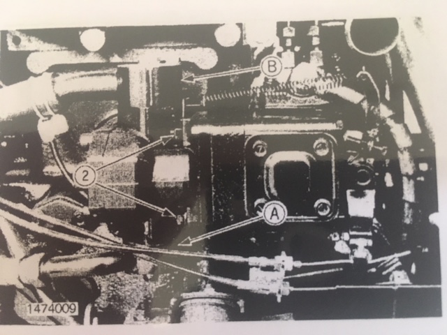

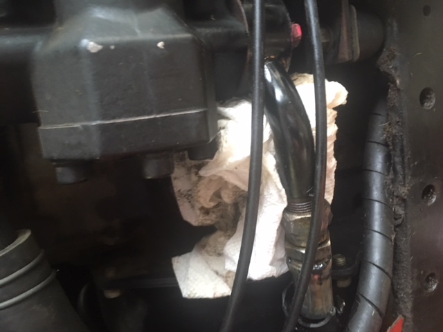

There is a leak on the YM147D on the inlet line into the hydraulic pump. What are the odds that it is a seal in the pump versus the line itself. Someone stated he thought the rigid line is leaking but it seems more likely that it would be an o-ring or the pump. Are parts still available from Hoye or someone for this? Hopefully the photos load. Thanks.

I can't really tell where it is leaking. From the picture it looks like the swivel fitting on the hose might be leaking but it is hard to tell. The small line is the pressure line. The big line is the inlet/suction. Both the suction & pressure lines are sealed to the pump body with an oring but that area looks nice and dry.
