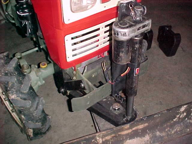

   / YM1401 Front Imp. Left #5
Another view of front blade

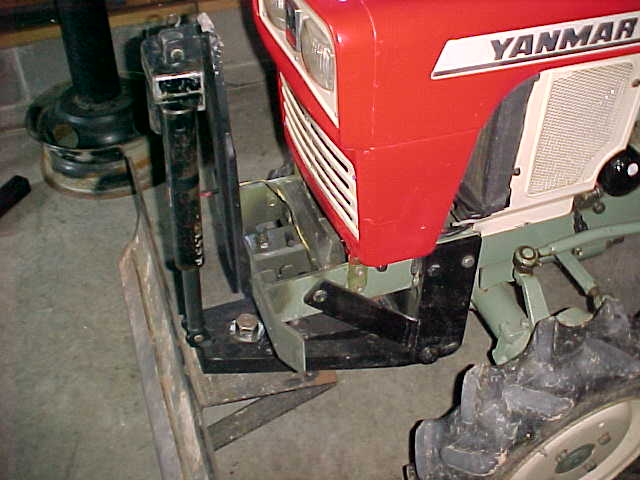

   / YM1401 Front Imp. Left #6
Another view of blade

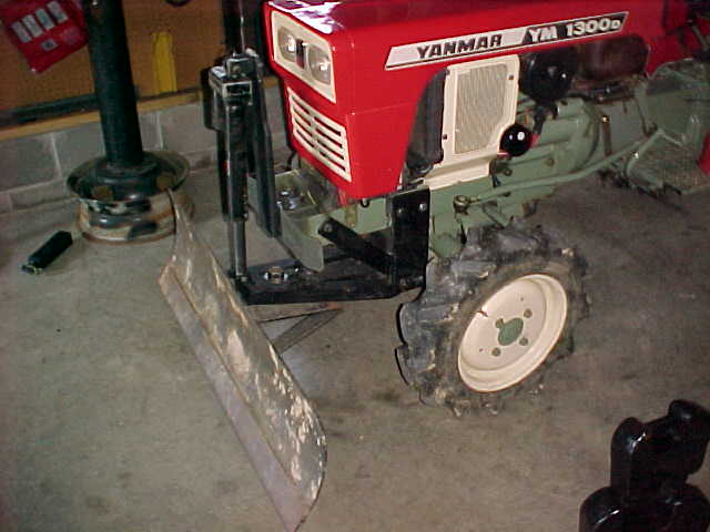

   / YM1401 Front Imp. Left #7
Here is a set up I made up using a electric/screw lift. This type lift system is on some models of lawn mowers to lift the decks.plows etc. I can easly lift the front end of the tractor up in order to dig. It has worked real will for me
