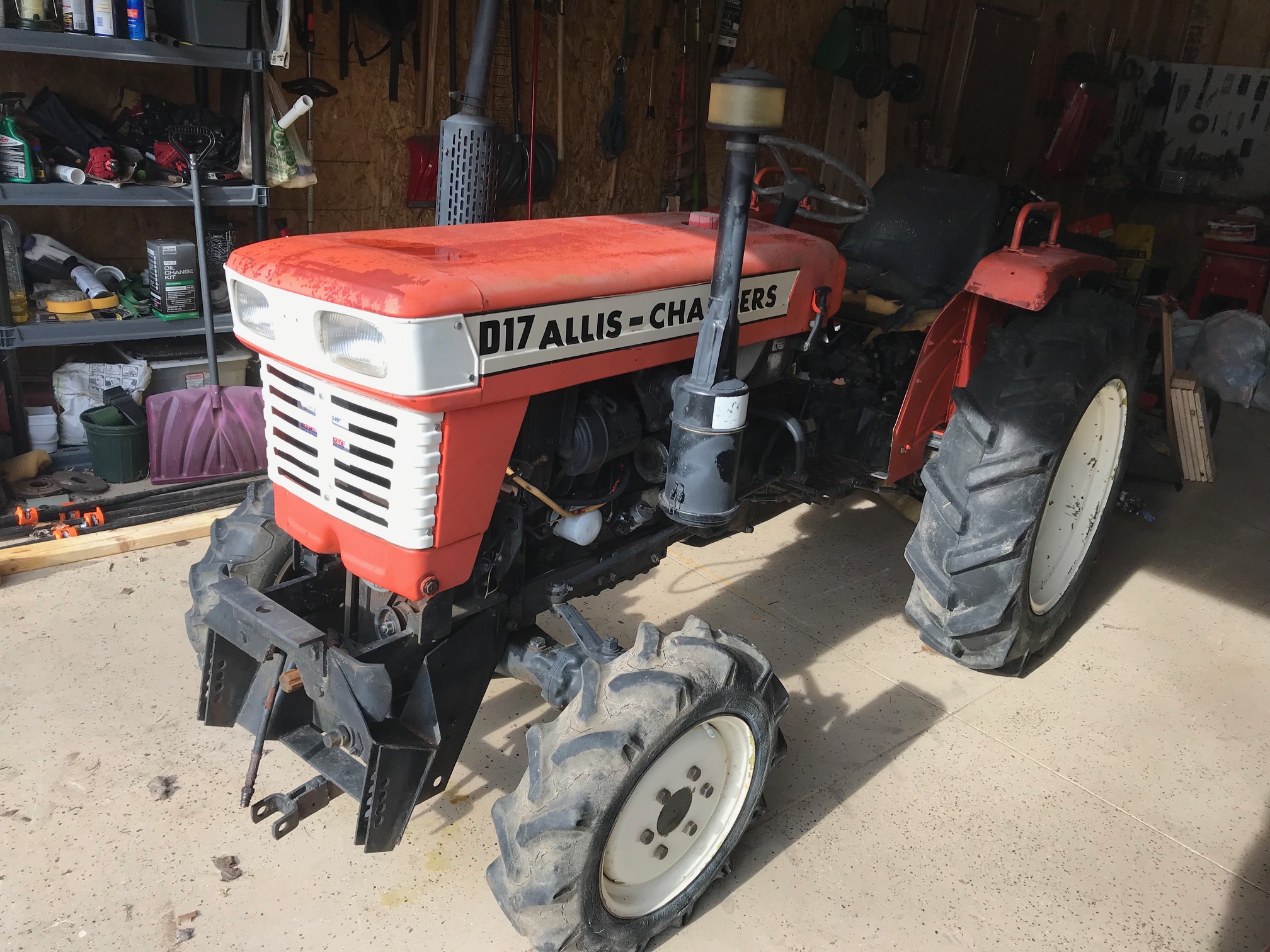

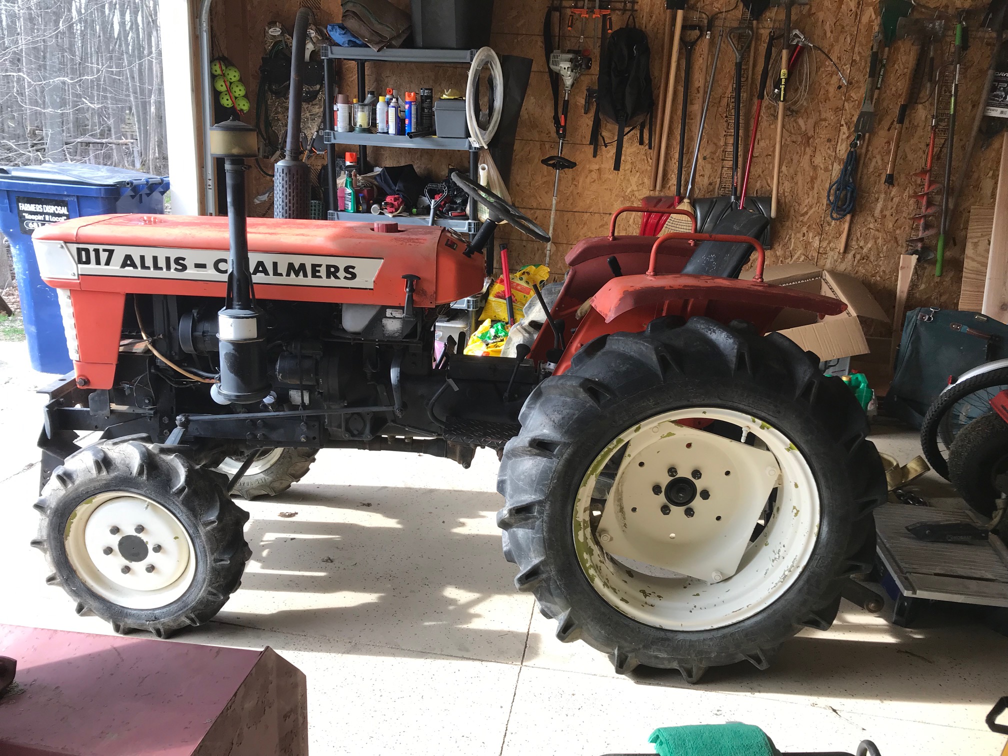

Thanks for the info and suggestions. I will take a look at the decompression linkage and exhaust tomorrow evening after I drain and clean the tank and add some new diesel and injector cleaner. I will post an update after that. I will try to attach a couple images of the new addition sitting in the garage after I got it home. I know we all have our favorites, but it still seems like a crime that someone painted it up like an Allis Chalmers.
   / YM 240D purchase and questions #7
Cool tractor. It's worth what you paid for it if for parts alone. The fact it runs at all makes it a steal. I gaurentee you when you get it right maybe just working it hard with fresh fuel it will run fine.
Why someone would put AC on the front? Maybe to deceive someone for a sale, but it would only be someone who knows nothing about tractors or the internet to research?
I would get that stupid looking AC decals off as fast as possible... possibly before I even had it running right! Haha

Ok, an update after some more work this weekend. First I removed the Allis Chalmers sticker :).
While I am still happy with the purchase, I am discovering more of the "there is a reason it was cheap" issues. As I was changing the fluids, I noticed a hole in the radiator I had missed when I was looking at it before I bought it. My mechanic brother in law also figured out that the smoke and rough running is due to the injector on #2 cylinder being stuck at least partially open. The plan is to patch the radiator and once the injector issue is dealt with work the tractor a bit and see if there still seems to be adequate cooling, if not, I buy a new radiator. As for the injector, we are going to pull that and hopefully a good cleaning will fix the issue. If not, then a rebuild or a new injector is on the agenda.
