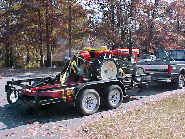

I would like to know if I need the "slip clutch" or anything else with my bush hog. I have been cutting without one, just a shear bolt on the mower.
   / YM 2210 #2
Nice Rig./w3tcompact/icons/wink.gif An overrunning coupler a ratchet mechinisn that attaches to the PTO shaft that keeps the spining Hog from pushing the tractor. It can be pretty uncomfortable to have the tractor keep moving when you want to stop. Agri Supply (1-800-345-0169) sells them for $33.49. Agri Supply sends out a nice mini catalog if you ask them. A slip clutch replaces the shear bolt and protects the tractor from sudden implement stops like when you hit a stump.
Chris
   / YM 2210 #3
I also have a 2210 and purchased a clutch from Agri-Supply that has a thumb release for easy and quick installation and removal. Not all overrun clutches are make that way. If you think you will be taking it off frequently I would get that one.
   / YM 2210 #4
Mark,
That's the one I got from them. No regrets. And no more running into the fruit trees either.
