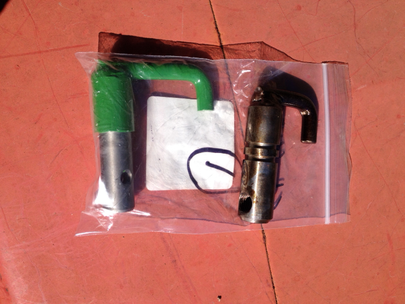

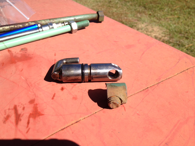

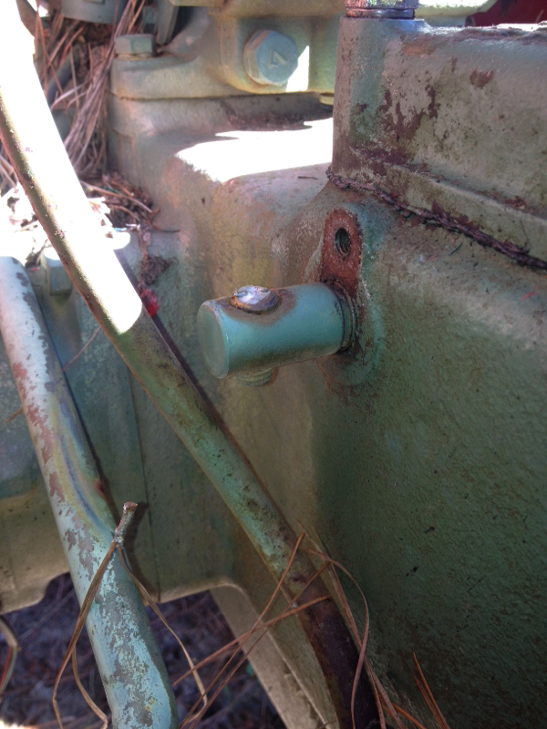

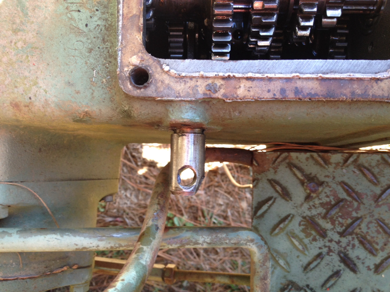

Waited a month to finish this project due to work. Check the parts and Hoye ended up sending me the wrong pieces. No big deal since the shipping was just a few days. Excellent customer service despite the long delay on my part checking. Does not take away from the experience of online shopping with them. I'll highly recommend them. I needed the one on the left. image-2772812720.jpg Next to remove the old one. I ended up shearing off the lever and had to cut off that end to drive it through to the inside. No problem. image-1889847833.jpg It doesn't work this way. But this showed me it was gonna need grinding. image-3857097164.jpg Used my Dewalt with the same cut off wheel used on the old one to take off the corner. This allowed enough room to get it in the hole and drive it the rest of the way. Just some dead blow taps from a 2lb shop hammer. I'd hate to crack the cast iron. image-1185173881.jpg Here it is in. image-2140988896.jpg Bottom line...it'll have to cut down or ground down some to fit easily. But, it still doesn't want any type of load when in high. That'll be looked into next.
