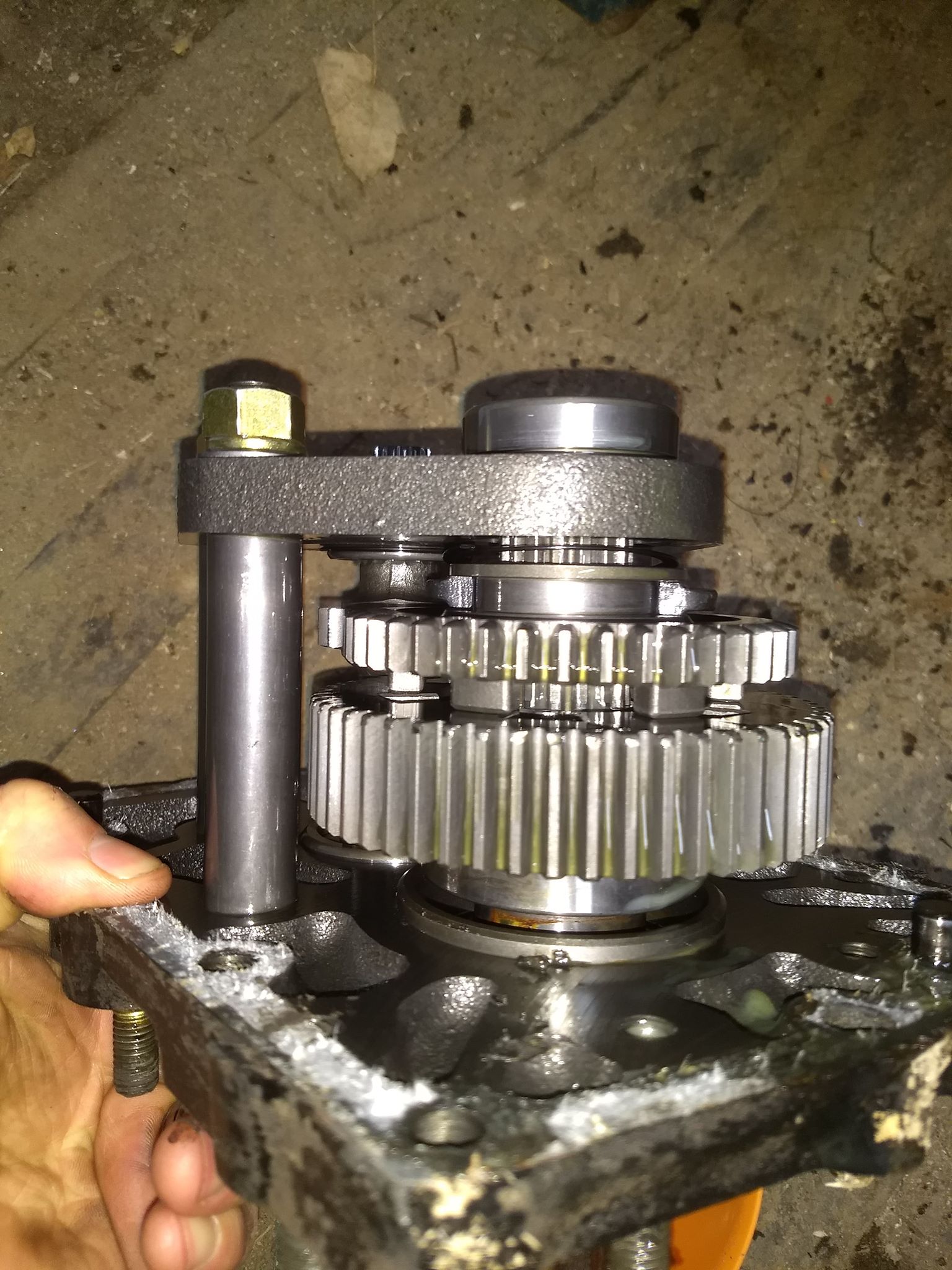

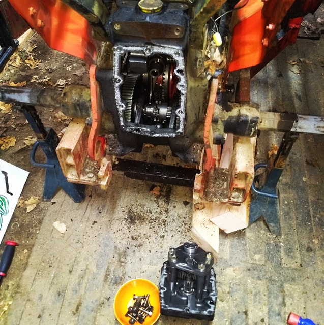

thanks guys. Finally had time to pull it out today. Snap ring on the end Bearing was off and the whole shaft/gears/bearings were pushed in about an inch. no damage that I could see. Wont get it back together for a day or so when i have time.
View attachment 637446View attachment 637447
nice. :thumbsup:
Just come cleaning and placing things back correctly makes this a winner!
Like the pixs seeing the shiny gears.
How does it look on the inside opening with the axle and gears there? clean?
I see something interesting in your first photo. The orange plates on either side of the opening may be the mounts for a semi-permanent tiller, as provided on the Japan-market version of these. Was the 3-point mounting hardware attached to those? Those might be a replacement after the US version 3-point mount got damaged? I recall you mentioned bent parts to remove before getting the pto out.
Here's a photo showing what I think is the standard US 3-point mount for YM186D, its what is on both my first and second YM186D.
Yours looks stronger if it uses those orange plates.
