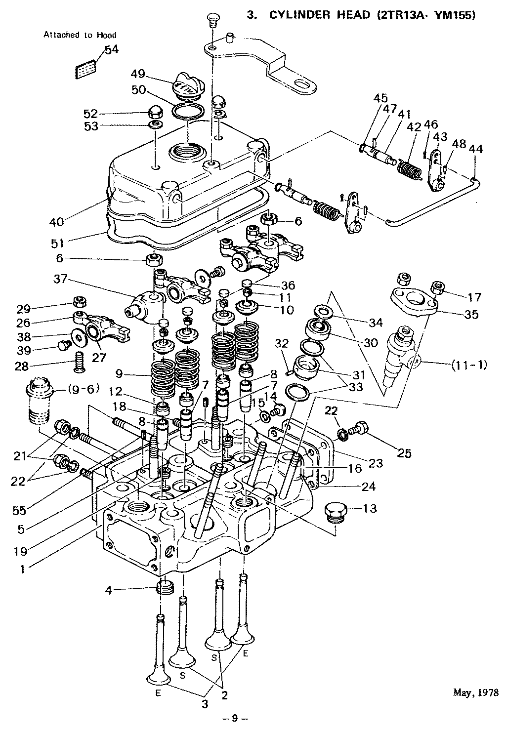

Hi . I just bought a YM 155 about 6 months ago. bought it real cheap, knowing it needed a few things fixed. I really enjoy the little tractor and have used it a lot on a brushhog and blade. I've been on here alot, and you guys have been a godsend. I really appreciate the help and knowledge on this site. Have been getting parts from Hoyle and they are helpful. I now have come up against a problem i need some help on. My decompression does not work. I know it is a needed item but it hasent been a problem yet. It started fine untill the temp got down below 25 deg. Now i need the decompression. The decomp rods do not touch the rockers like they are supposed to. My question is, Is there spacers that go on top of the valve stems to lift the rockers up, allowing the decomp rods to touch? thanks

There is no adjustment on the compression release. It is built into the valve cover.

Note the head parts drawings attached. http://www.partsandservice.com/index.html#home Note part #36. The list is calling it a retainer. I believe that is a mistake. It should be called a valve cap and is on all other Yanmar drawings I have seen.
Only pointing this out to make sure your valve caps are in place. If not, your rocker arms would be way down causing your release to not make contact. Make sense?

I had seen the "retainer" in the only drawing I had found. My tractor does not have these.

I have the same motor and I took the caps or retainers off when I did a valve job. I guess I should say they wouldn't stay on. My decom works without them There is no adjustment that I remember. The only thing that I would check is the thickness of the gasket or wear of the cam that push's down on the rocker arm and they turn inside the cover.

Curious here. These caps fit over the valve stem, much more than .008". If the valves are adjusted correctly I fail to see how they could come off.
   / YM 155 Decompression issues #10
Winston the new valve was tapered on top, not flat. When I rotated the motor by hand the caps hit the keepers I knew I had the wrong valves, I needed the ones without a radius on the top. Wrong! yes but I went with it. Adjusted valves to .007 instead of .0078. I have around 300 hrs on it and no trouble that I know of.
