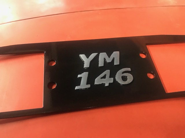

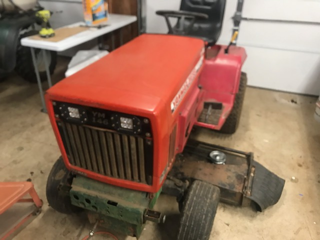

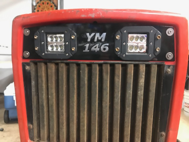

I just finished my custom designed plasma cut front grill with LED lights. I came out very nice. I used inkscape to create the file with the cutouts and bolt pattern. Then I had it plasma cut at the shop. The model letters are also plasma cut and spot welded to the light grill plate. I taped off the letters and polished them to make the letters shine. Then added a few coats of clear coat to protect the metal. I had previously made this from wood but now I have access to a plasma cutter. My next project is the shift plate under the seat I already have the files just need to cut them out and finish.
