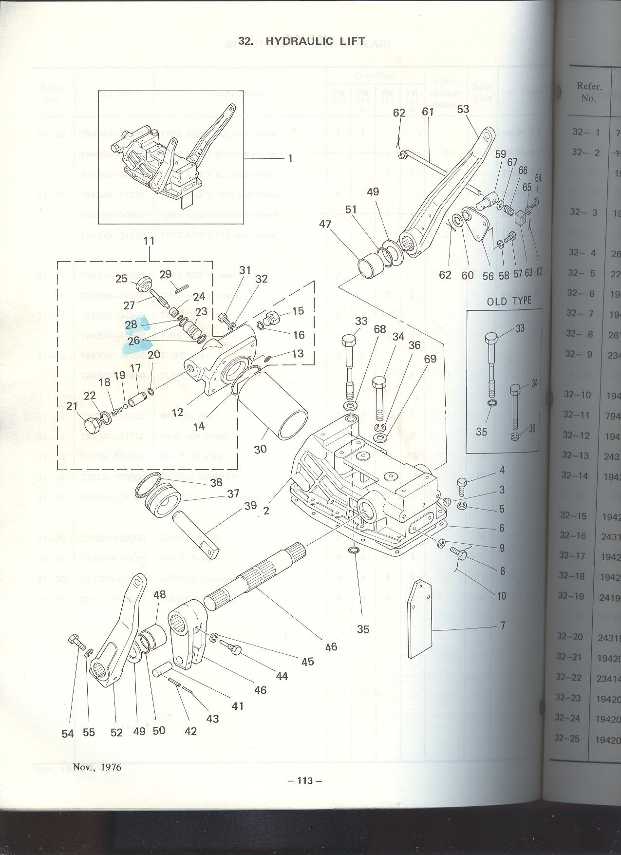

Folks,
As spring approaches, it is time to start thinking about projects I have been putting off until it warmed up. My girlfriend owns an adorable little 135 she uses around her yard and for working on a prairie restoration (yes, she is a good woman and yes, I am a lucky man). Recently the 3 point won't lift what it used to and once it is up, if you put more weight on it, it will drop. The engine doesn't sound like the pump/3 point is maxed out, it just won't lift. Closing the valve under the seat has no impact on it going down. If the carryall is up and I step on the back edge, it will drop (again regardless of whether the valve is closed). After searching on this forum and a couple others, it sounds to me like this is a bad o ring. Does that sound right to folks? If so, how much of a project is it to fix it and will the bad o ring be apparent? Thanks as always for sharing the knowledge.

Do you have the manuals? These would help greatly. If no, click on the link in my signature and find them for FREE at the Yanmar Tractor Owners Group.
It could be a seal or it could be the hydraulic filter needs to be cleaned or replaced. Maybe the fluid too.
Yanmar made our YM machines and the John Deere 50 & 55 Series machines together. So, the J20C fluid is spec'ed for our machines. Both Yanmar and John Deere worked on the Hy-Gard formula.
The YM135 and the 155 (& 165) were the same tractor except for a slight change in the engine HP. My OEM Yanmar parts book covers both the YM135 and 155 in the same book and as far as I can see there are few differences. Certainly no differences in the hydraulic lift.
Those were really nice little tractors. Many were sold and yes, they are adorable. Hers is probably the lime green color. We still have our YM165 bought new and it is identical except for being red.
Anyway, what you describe is probably a worn o-ring on the lift cylinder piston. It is common for many tractors to use a rubber O ring there, and not unreasonable to need to replace it every 30 years or so. Replacing it is a simple & easy afternoon job if you have ever done it before- and not too much longer the first time. This is almost basic maintenance, therefore Yanmar made it easy to do without special tools - a good set of sockets and wrenches are about all.
Prepare by placing the lift arms in their lowest convenient position and putting a block of wood under them to prevent then from falling down any farther.
As I remember, there are two O rings that you need. One goes around the 3pt lift piston, and the other ring seals the cylinder to the head. Both are visible in this attached picture as parts 38 & 14. Might as well get #s 26 & 28 as well. And anything else you might think you need.
I like to use a sheet of the good 600 to 1000 grit wet-or-dry paper to shine up the inside of the cylinder in case of rough spots or some rust... not always necessary.
That's about it. I hope it sounds like a fun project. Design for simple upkeep is what these vintage Yanmars are all about.
