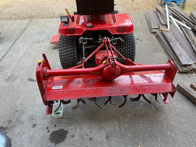

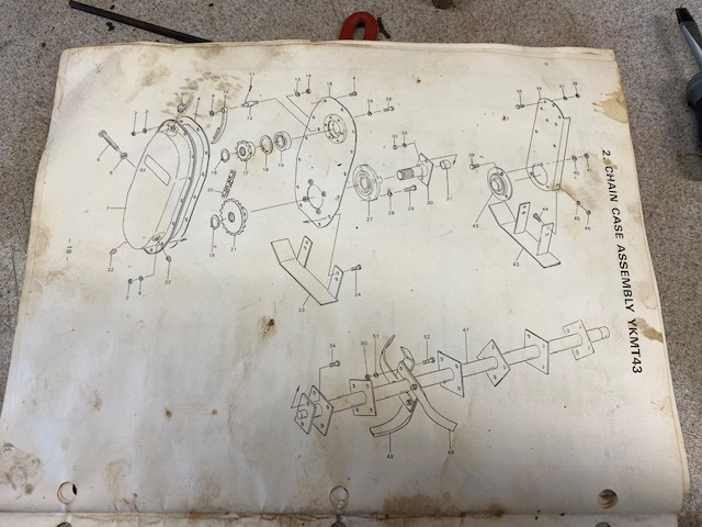

I was able to find a YKMT43 rototiller the 2000 rpm for my YM 146 Yanmar. Tiller had some leaks around the pillow block bearing so I am replacing those now. It came with a manual so I have the diagrams. Has anyone else ever did maintenance on one of these?

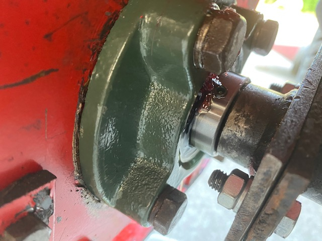

Need some advice on this one I just replaced both bearings on my YKMT43 rototiller. However the pillow block bearing that I purchased is leaking through the bearing. I ordered the correct PN I believe is there an option that will make the bearing sealed? Here are some pics. IMG_0101.jpgIMG_0102.jpgIMG_0103.jpgIMG_0104.jpgIMG_0105.jpgIMG_0106.jpg
   / YKMT43 tiller oil leaking between bearing and tiller shaft. With pics any ideas
Reinstalled new sealed bearing still leaking, anyone else ever have a problem like this?

No is that a thicker grease? I am wondering if the shaft has worn slightly and the grease is flowing bewtween the shaft and the inner bearing.

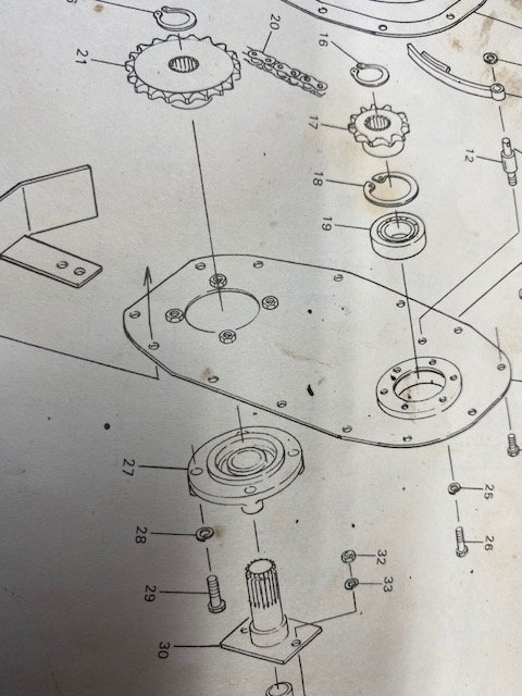

Manual called for a 80w90w oil unless in very hot conditions then a 130w. The part that is leaking is the It is not in the gearbox rathar in the chain drive gear box. The leak looks to be coming from between parts 27 and 30 in the diagram above. I am wondering if gear lube in this area would work or is the oil required.
