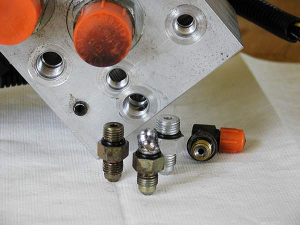

I've been putting up with a slow hydraulic fluid leak for months now. Every now & then I would take a look around, decide it was a fitting on one of the many return lines to the tank and put off doing anything about it. They are really tough to reach and if I have to take one off, the tank has to be drained first. Procrastination rules!
Until yesterday when out mowing and the leak got suddenly much worse. As my eye passed by the RPS valve on its way to visually check out the return hoses it was arrested by a fitting that looked bent. Bent? Gwan, how can that be? Well, it was bent alright. And leaking like a sieve.
When I took the hose off and the fitting out what I found was quite astonishing.
In the picture you'll see four fittings, which we'll call 1 2 3 4 left to right. Number 1 came out of the hole directly above it. Number 2 came out of the adjacent hole (yes, the hole looks larger - I machined it to accept a larger replacement fitting (number 3). Number 4 came out of the other end of the same hole as number 2. A close examination will show some damage to the number 2 fitting - for comparison it started life identical to number 1. Also note the shape and color of the tip of number 4.
Here's what happened. The "machinist" put number 4 in its already drilled and tapped hole and ran a ball end mill (an especially long one - that aluminum block is 3 inches thick) into the hole from the number 2 end and machined a nice concavity in it's end. Then (s)he took it back out, put number 2 into it's already drilled & tapped hole and ran the ball end mill through from the number 4 side ALL THE WAY TO THE O-RING!
Why!? Beats me.
Why did the thing hold up for 400 hours? Beats me.
I hereby donate twenty lashes with a wet hose to that darn fool "machinist"

That is a fitting in the high pressure oil shuttle. The damage is caused by the ball shuttling back and forth each time you shift from forward to reverse pounding the end of the fitting into that shape. It was not machined that way, in a shuttle valve the ball is seated into the softer fitting by setting the ball on the end of the fitting and striking lightly with a hammer. Sometimes shuttle valves will hammer into destortions as seen in your photo. Just reseat another fitting and install into the valve, don't forget to insert the ball in the valve between the fittings or your machine will not tram very well and no pressure will be available to release the brakes or operate the draft. These high pressure shuttles are designed to be repaired by replacing the inexpensive fitting instead of the entire valve.

<font color="red">That is a fitting in the high pressure oil shuttle. The damage is caused by the ball shuttling back and forth each time you shift from forward to reverse pounding the end of the fitting into that shape. It was not machined that way, in a shuttle valve the ball is seated into the softer fitting by setting the ball on the end of the fitting and striking lightly with a hammer. </font>
Yikes indeed! I hardly know where to start. First off the ball must have escaped while I was removing the RPS valve - I never knew there was one! And of course that much better explains what I was seeing, even the enlargement of the hole for the first inch in. It looks like someone had stared boring crooked.

cjturner: <font color="red">Will it cause problems that the fitting has been replaced by a larger fitting? He said he machined it out to accept a larger fitting. My logic says that the only important part of the fitting is the ID (Inside Diameter) because that is where the pressure is generated/carried.</font>
My logic says, especially because of the "crooked hole" wear (which I didn't mention until now) that the ball needs a guide to keep that pounding from continuing. To be sure I had plenty of clearance for the tap taper, I had drilled the hole about 3/8 of an inch deeper than the fitting needed. That gave me a nice clean hole to bush back to somewhere near the original diameter. (see attachment).
Blackwell: <font color="red">don't forget to insert the ball in the valve between the fittings or your machine will not tram very well and no pressure will be available to release the brakes or operate the draft. </font>
Yikes! You mean I've been spending all this time since the fire living with a tram pedal that acts like it has a sticking cable and a draft control that only works intermittently and all it is is a sticky ball? At least that's my guess - that the ball in the process of beating up the fitting would occasionally get hung up then snap loose giving me sudden acceleration just like a sticky cable would. And that occasionally the ball would stay hung up causing the draft to stop working (trust me - you DO want that draft control working on a steep hillside!) The "sticky cable" I assumed was from the heat of the fire driving off the lubricant and that eventually I would have to remove it and either lube it or replace it. Procrastination rules again! The intermittent draft control I just couldn't figure out.
So, the new fitting is in, the ball is in, and I have a tractor that behaves like it should for the first time since before the fire! No hydraulic leak, no sticky tram, no intermittent draft. Wow - life is GOOD!
