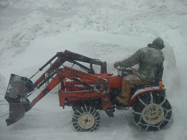

I found a used YFL 650 loader that I may buy. I was wondering if any knew if it would bolt right up to a YM 1510?
The person selling it told me it came of a 186, which I think is a similar size tractor. I got some measurements to check, but I figured I would ask and see if anyone knew right away if it would or would't fit.

If it didn't bolt right up, it would surely be very close. If you go with an aftermarket, get the Koyker 80 with a 42" bucket.

Well, I don't have a 1510 but I do have a 186D with a YFL-650. I can't answer your question of the loader fitting a 1510 but I just looked at some good pictures of a 1510 and it looks a LOT like the 186. However, measuring the frame and mounting holes is different than "looks".
