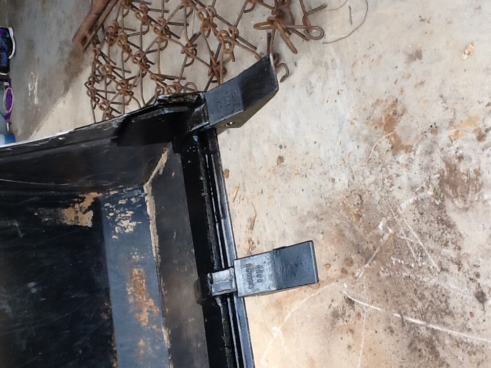

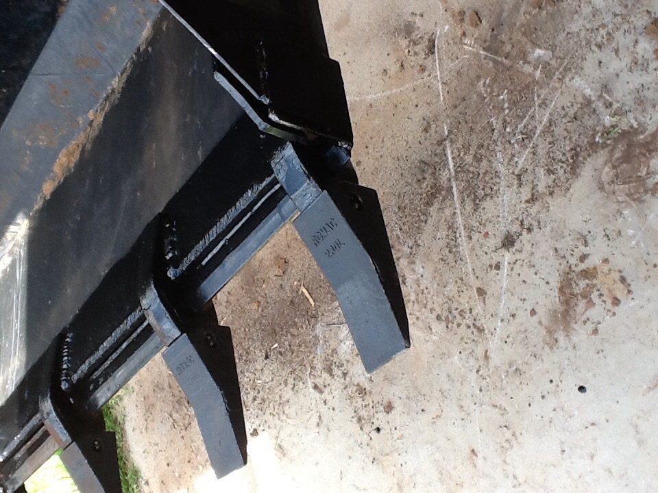

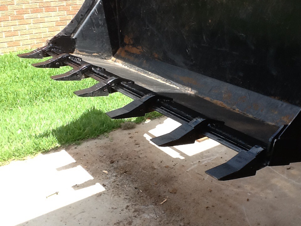

What's different about this one? The price. 72" bucket, 7 Wrap around 230 series shanks, dirt teeth, all new (the plate was from a scrap yard) for under $150. Here's the breakdown and some pics.
Got the 3/8 plate as angle from my local scrap yard, 7 ft for $16, cut to 3/8x4x70".
The shanks are 2740-ZW-23 from h-eparts.com, $4.17 each, total with shipping, $57.16 (buggars are heavy)
The teeth are romac 230 dirt teeth from wholesalepartsjim on EBay, $7.75 each with flex pin, total with shipping, $71.45.
Weld it up, and bobs your uncle. Btw, it's a beast, probably not for the small CUT, this ones on my 6500lb mahindra 4025 4wd.
