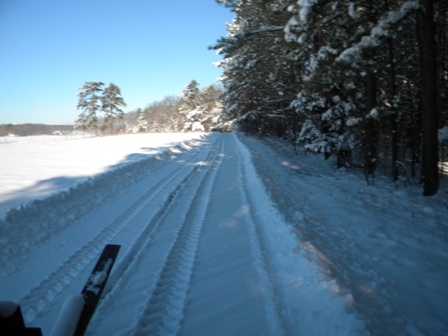

Here in Central Virginia we do not often get snow, maybe once every 10 years or so we will have a large snow. It is not uncommon to go several years with out a snow that exceeds 3 to 4inches in depth. This does not justify a lot investment in snow removal equipment. But what about those years (like this one ) when you have several deep snows >8". And what if the driveway you have to push is a 1 mile long dirt road?

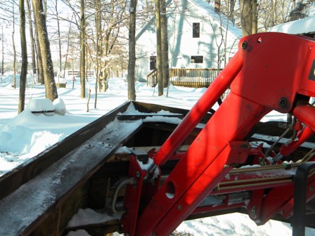

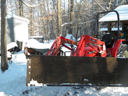

I rememberd a pull type V plow that my father had when I was a boy and decided to see if I could recreate his idea and mount it to the loader on my Centurty 2535 (Branson 3510). Using 3/4 " marine grade plywood, treated 2x4s some misc oak boards that I had,and some metal that I had lying around, I built the plow shown in the attached pictures plowing the 10" snow that fell yesterday. It attaches to the quick connect assembly on the loader so I can attach it is about 2 minutes or less.

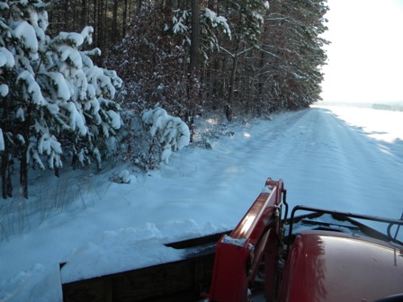

The tractor has plenty of power and weight (tires are not filled) to handle the 10" snow as shown in the attached pictures. I can plow this road in about 1 hour. because the road has a high crown I often have to make a back pass to moe a bit extra from one side that did not clear as cleanly. One pass leaves a 11 ft wide road.
Best of all even if I had to buy everything it stillcould be constructed for about $300. Now I have plowed only 3 snows with it so I do not know how it will hold up for the long term. But it works and is economical.
