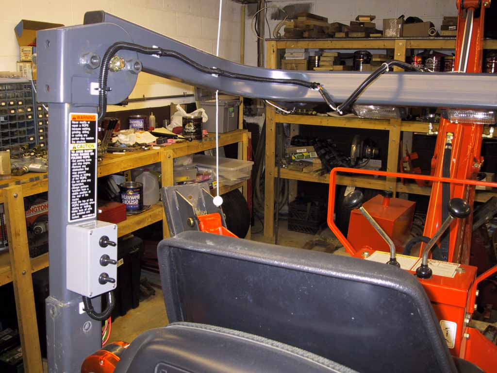

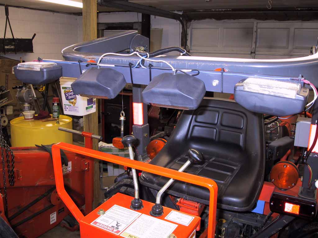

I wanted some additional lights for snow removal so while I was at Harbor Freight awhile back I noticed that they had these 55w lights on sale for $8 a pair, so I picked up four of them. The only good thing I can say about them is the low price - the bases and housing very cheap and rather of poor quality - which makes aiming them precisely an almost impossible task - but they work good enough. I needed a way to mount them so I picked up a pair of small orange magnetic ground clamps (you can just barely see them at the top, behind the bar the lights are mounted on) while I was there as well. For the mounting bar itself I used a piece of old aluminum threshold from a recently replaced door which I cut down on the bandsaw. A little Kubota ROPS grey and it blends right in, more or less. I have to say that I managed to knock the lightbar off the ROPS when clearing the driveway and wasn't paying good attention to some branches that were hanging real low due all the ice - and the lights were none the worse for it.

For the switches I picked up a NEMA waterproof plastic box, three 20 amp waterproof switches, and three rubber boots for the toggles (double protection. I used some plastic loom to hide the wires in and attached it with cable ties to some cable tie mounts, which attached to the ROPS with double sided adhesive foam (holding up good so far.) The loom was routed down below the switch box so that there would be a drip loop. The hole in the switchbox that the wires pass thru has a rubber grommet in it and all the wires are encased in heatshrink tube at that point - hopefully it will be fairly waterproof. There's one switch each for the front and rear lights, the third switch is for a cigarette light accessory plug that I mounted at the rear of the tractor.

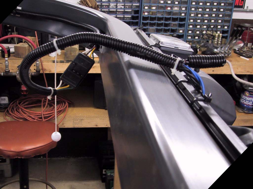

I wanted the light bar to be easily removable, in case I needed to use the tractor in heavy brush or the woods. I had an old flat 4 conductor trailer plug that had been lying around the shed for about 20 years but was brand new .... seemed like a good way to get rid of it. First wire carries the current for the front lights, second for the rear, the third is a common return for both pairs of lights and the fourth is currently unused (just in case I get the hankering for one of the flashing yellow popcorn poppers) Makes it easy to remove - just pull the trailer plug apart and pop off the light bar.

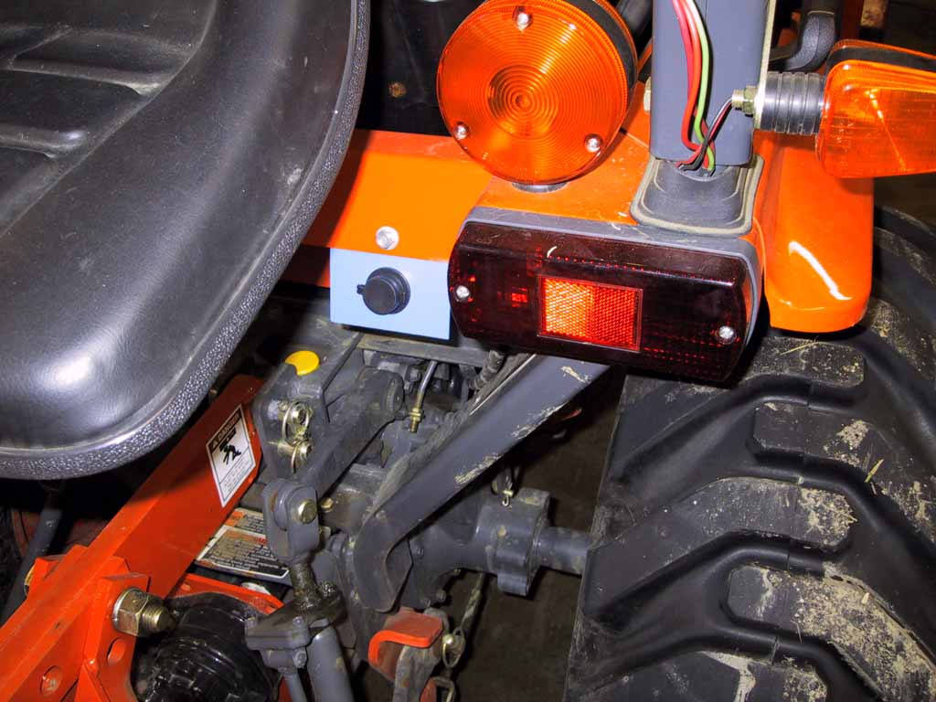

The cigarette lighter accessory receptacle. I picked this up at Autozone, supposed to be waterproof. I used a blank plastic cover for a 4" electrical box for the mounting plate. (It's blue and it still needs to be painted ROPS grey.) It's mounted through an exisiting hole which I believe is for the Kubota rear work light. I used a grommet in the hole and then passed a bolt through that, to avoid chewing up the paint. The electrical feed and ground wires, which you can see coming out of the rubber boot on the bottom of the ROPS are heatshrinked to avoid wear, there's also a piece of plastic loom that goes there that's off in this picture. The feed wire is connected to the exisisting wire which Kubota provides for the rear work light, it's on it's own circuit with a 20 amp fuse.

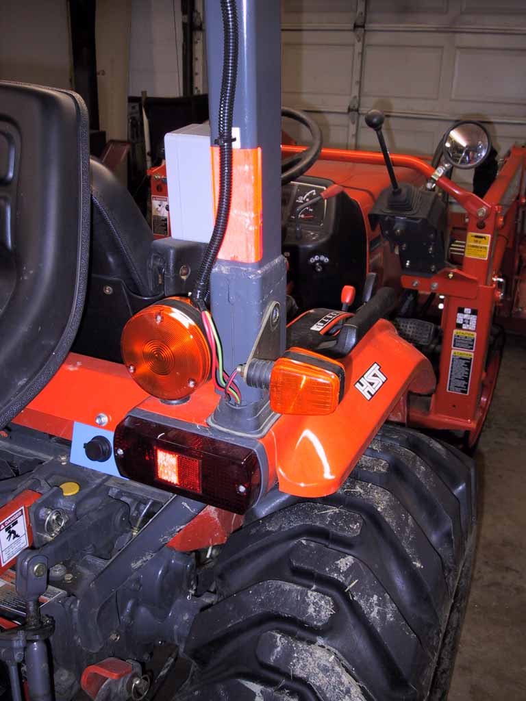

Another shot from the rear.
