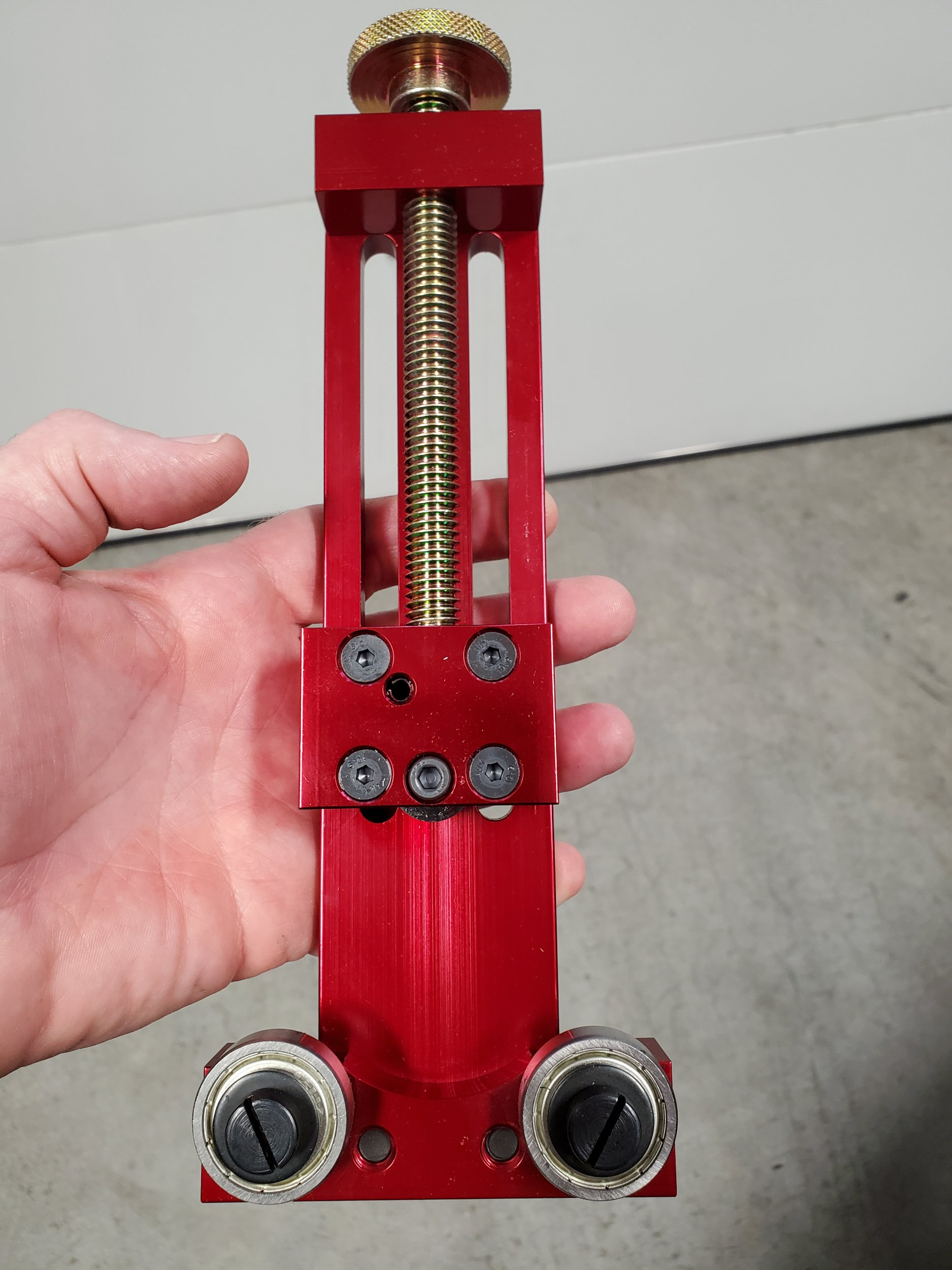

Here is my Taiwanese Proform 66490 filter cutter I bought in 2020. It came with spare cut off wheel.
Here is Chinese less expensive now available knock off

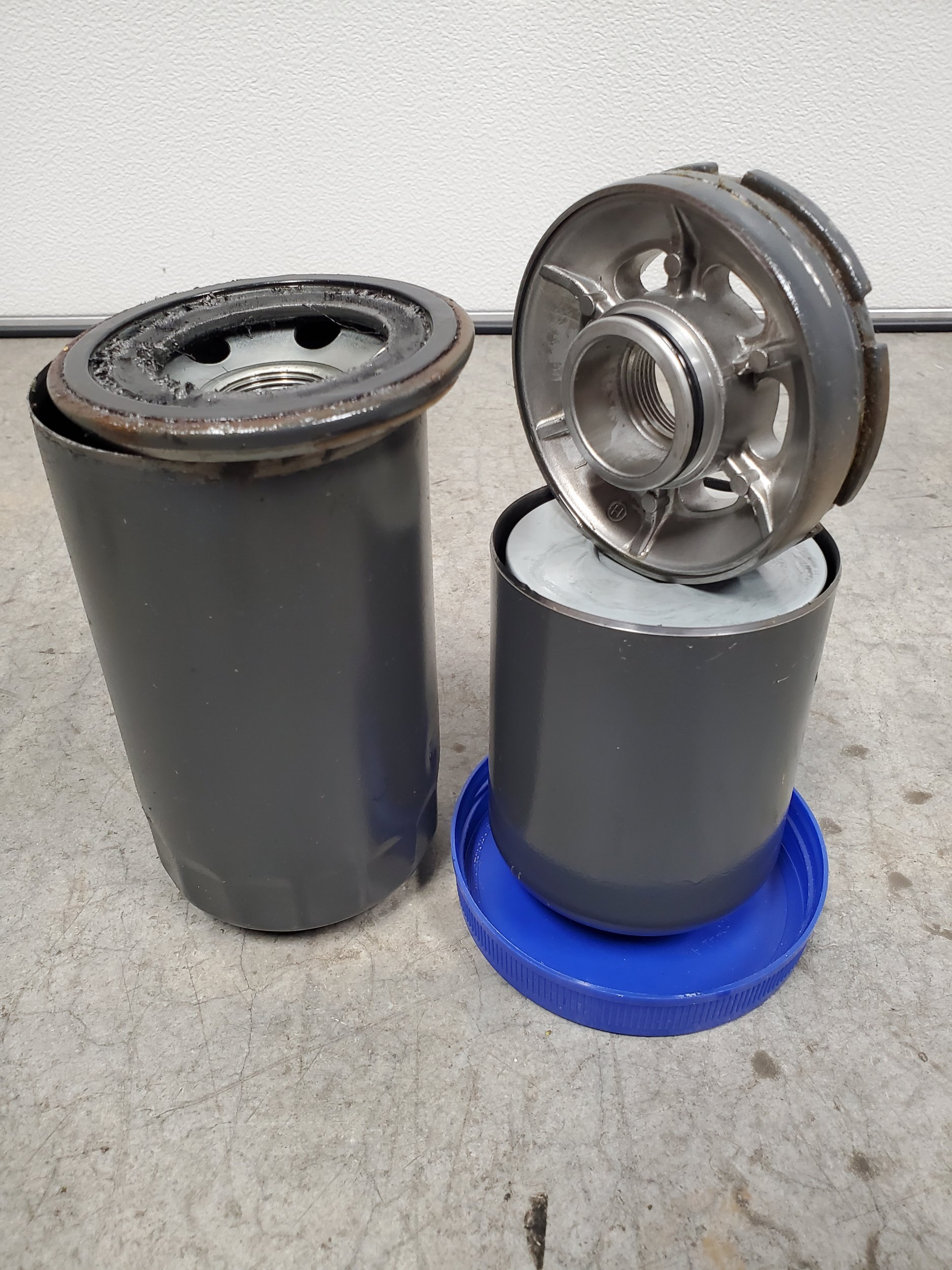

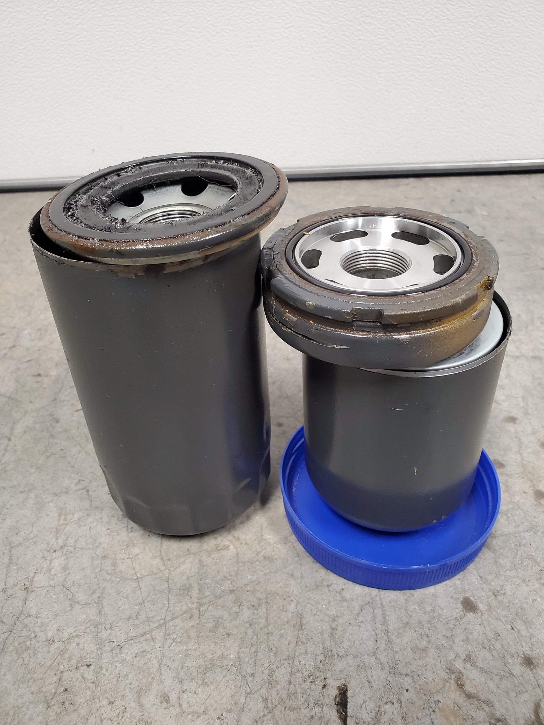

And because this is a tractor forum, included are two pics of Kubota's high and low pressure hydraulic oil filters. Kubota M59 has two low pressure filters ( Left pic ) that incorporate a magnetic ring at filter inlet. Both of my filters's magnets were clean until I set then down on the lathe bed and voila, magnets loaded up. The filter cutter will cut Kubota low pressure filters but not the much thicker high pressure filter. These Kubota filters are both original install OEM filters, that is why they are gray.
The high pressure filter on right was cut with lathe and parting tool. Note the very thick aluminum base. For fun, I tried cutting a portion of the high pressure filter with abrasive cut off wheel but stopped due to concern with contaminating the filter with steel dust during cut off. Very tedious and throws lots of grinding dust.

Your first one is about in line with the Motion Pro I bought some years ago. It was made here. I try to avoid all the import stuff as it's usually inferior (as the reviewers state). The Motio0n Pro also takes a Ridgid cutting wheel.
