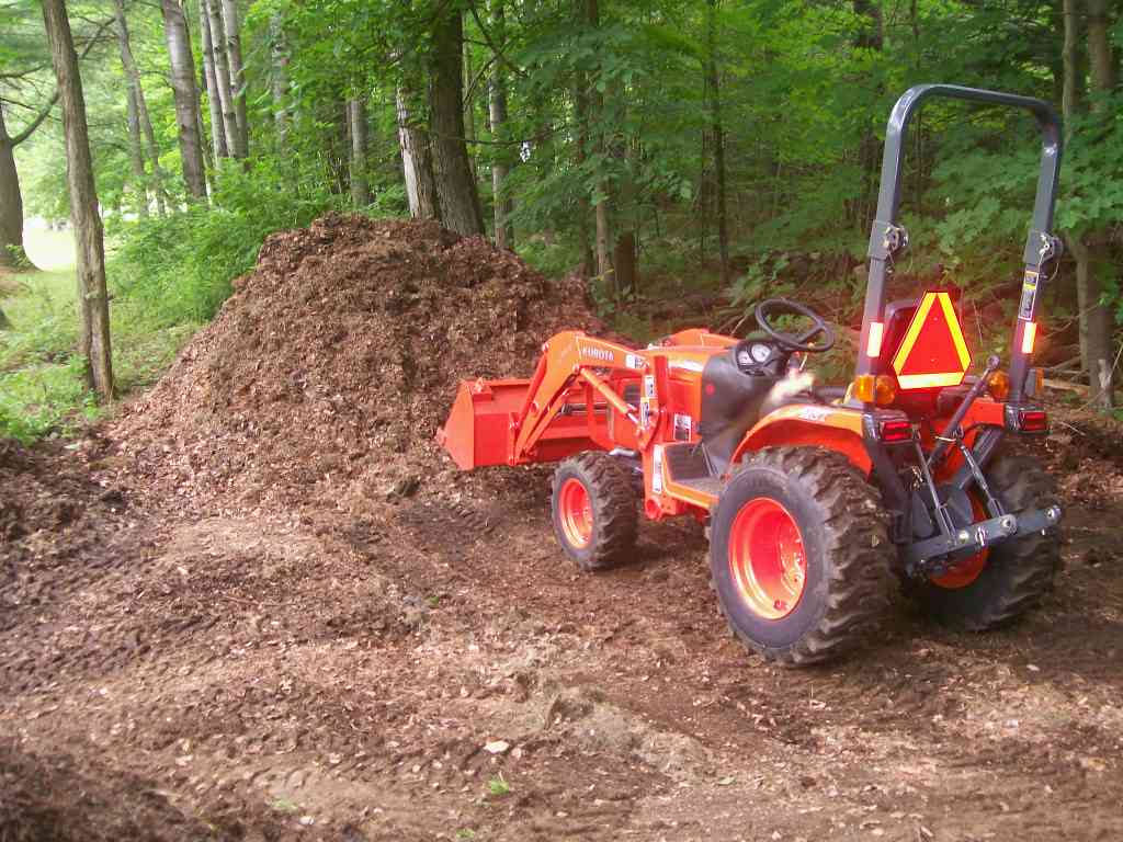

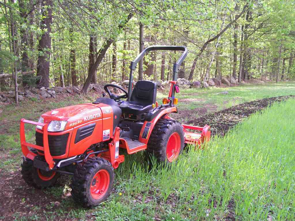

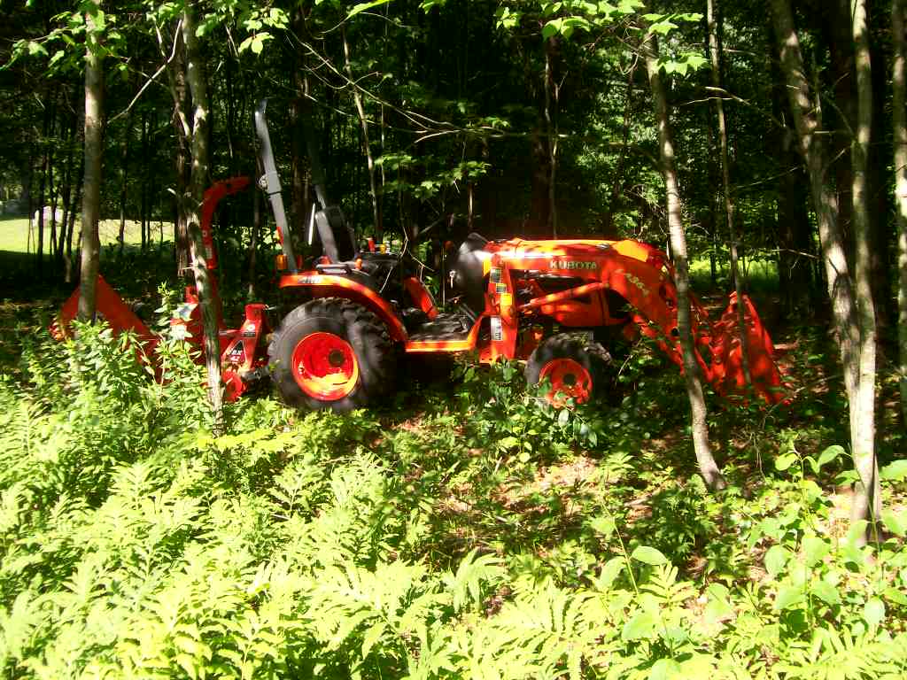

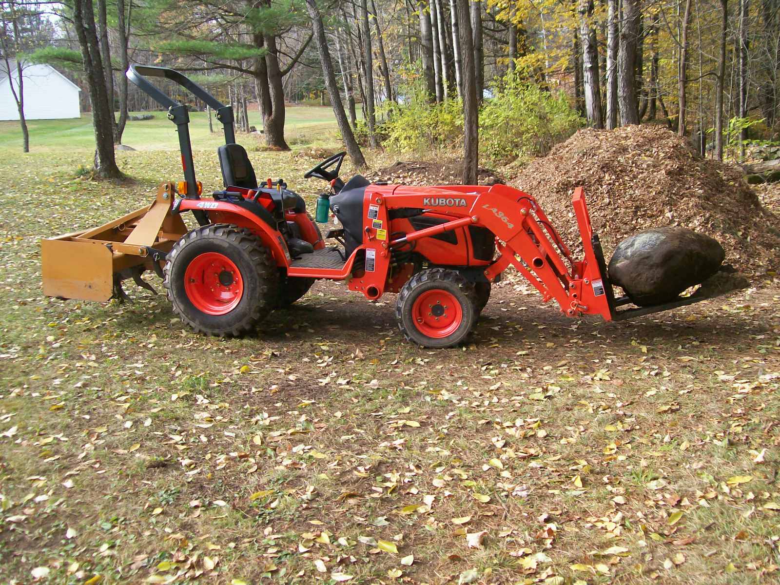

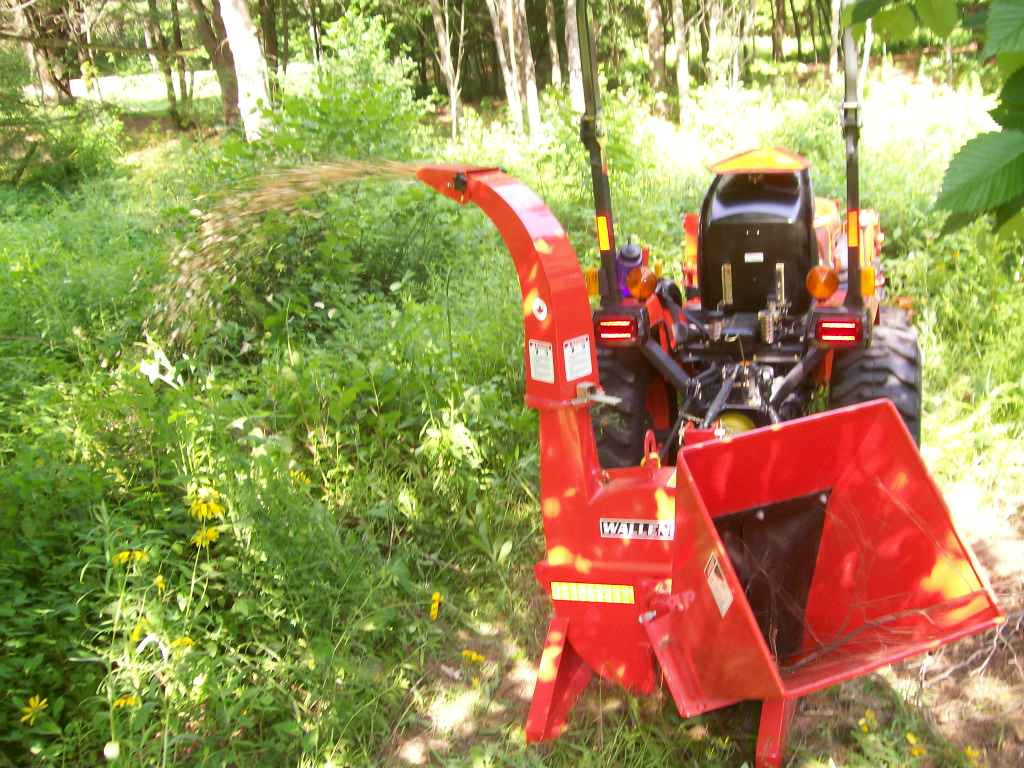

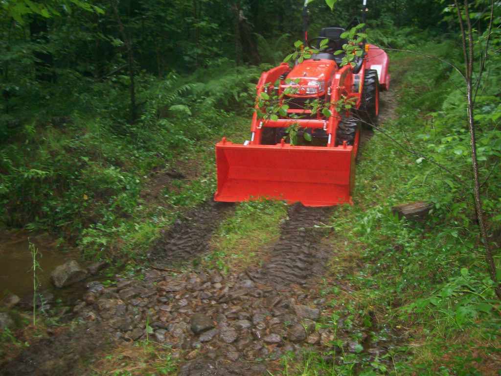

I've had a BX22 with the backhoe, etc., and I think other posters are right in guiding you to something larger. I stayed with a B size, and it has done a good job for me. I got the B2620 because I wanted the extra loader capacity you get with that model over the B2320. Though the backhoe on these B's is more than capable, there is another step up in performance when going to the larger B3200, etc. size. I've done a lot of work without the backhoe, but I still miss having one, and may be getting one for my B. Forks will be a very useful addition for the kind of work you are planning. Moving rocks from one place to another for example, working with brush, and logs, etc. I have some spots in my woods trails that are still just wide enough to get my tractor through, and a 60" bucket wouldn't fit through one spot so my B2620 has worked well for me doing trail work, and is still small enough to rototill small gardens, and do other things around the yard. I have about 3+ acres of "yard", and the rest is wooded.

Heh. Chuck, for all I know we're neighbors (we're also in NH). Very helpful, thanks for the pix!! You probably have an excellent visual of our woods!
Hadn't thought about a forklift. Expect we'll be moving the rocks in the fel.
