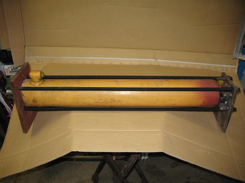

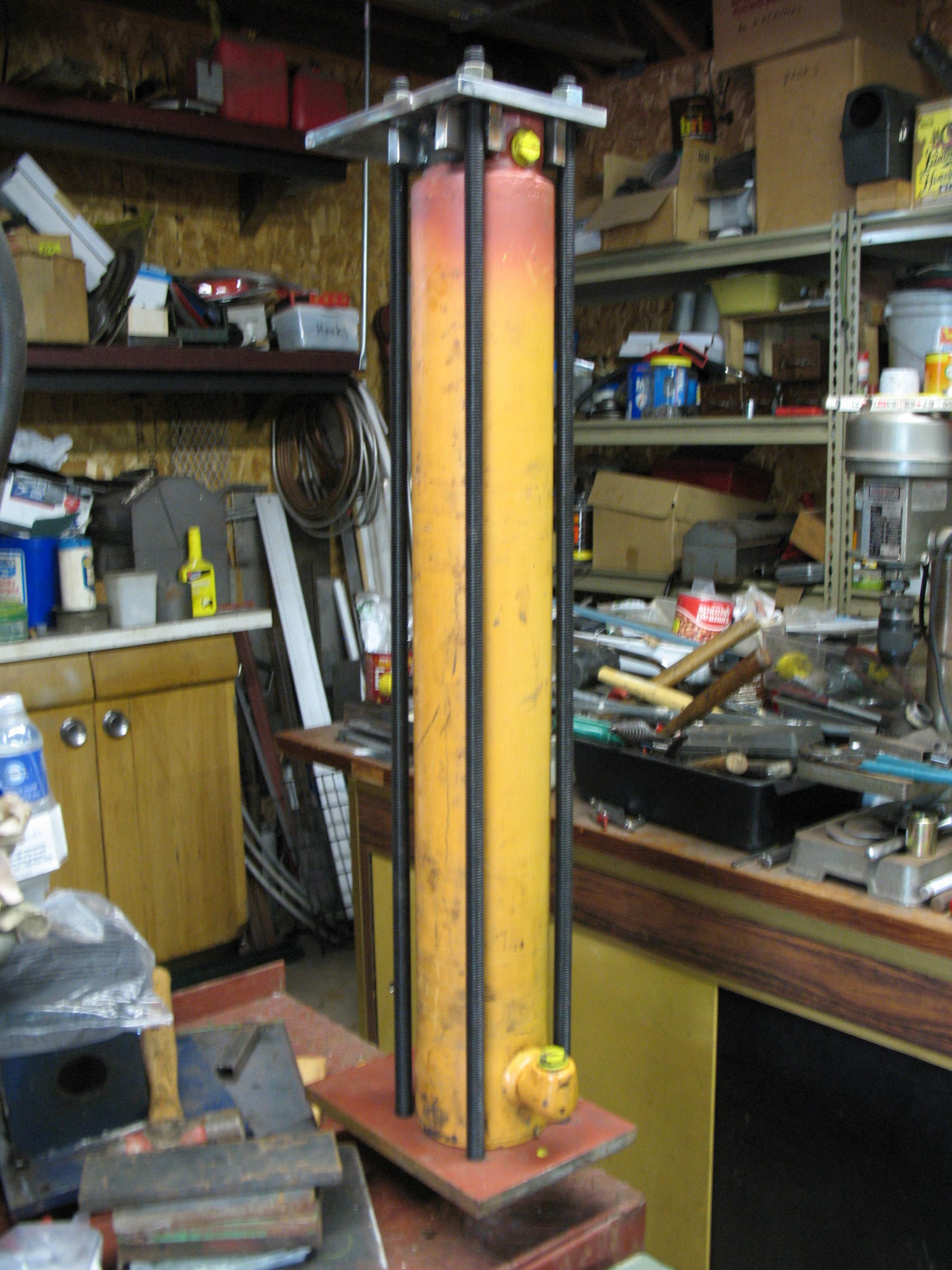

With a short beam you can consider converting a tie-rod cylinder to a front mount by replacing the existing rods with longer rods. Even welded cylinders can be converted to front mount.

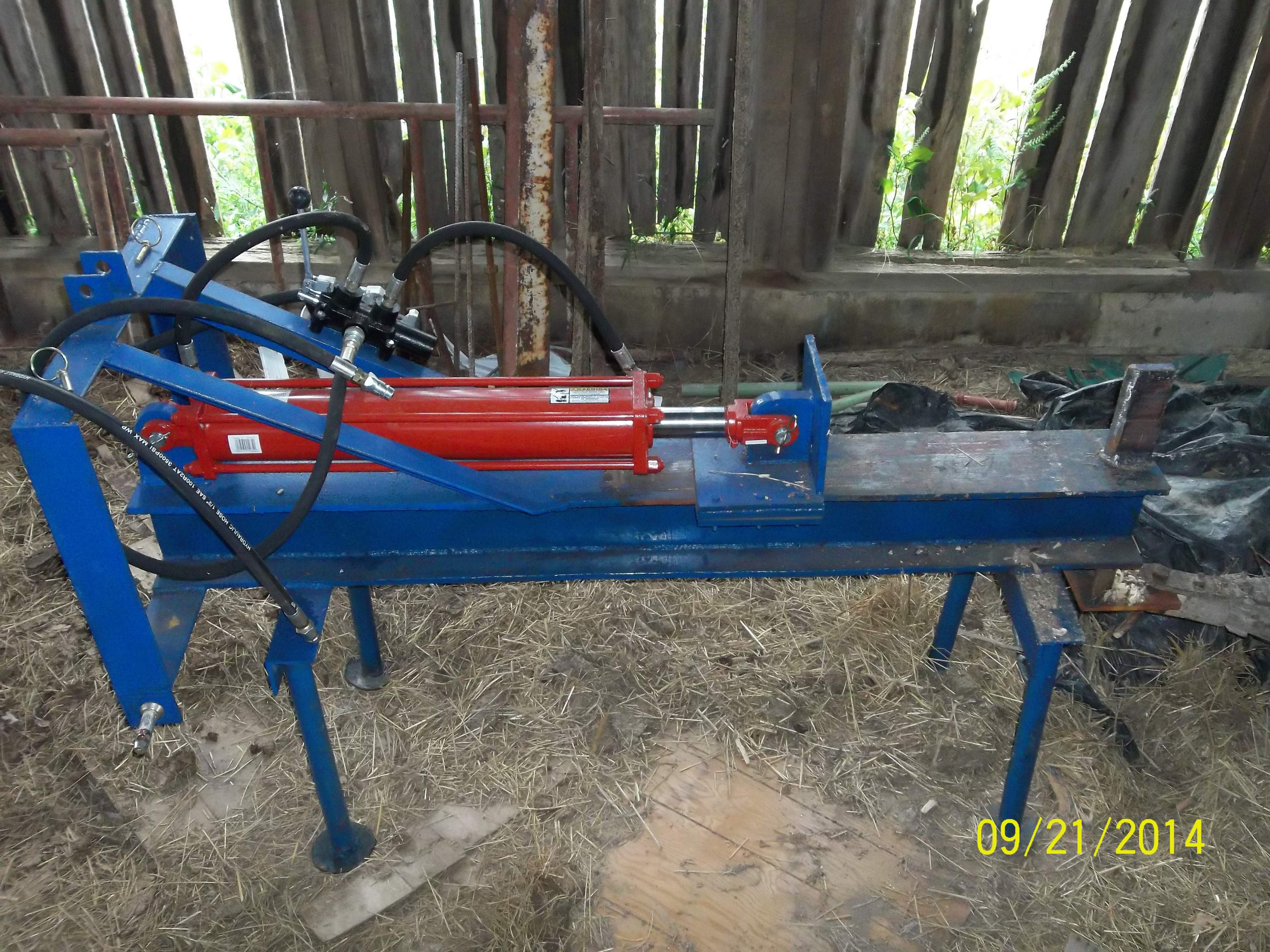

Here s the one I built for my tractor that the beam is 67 inches long. With the 4 x 24 cylinder there is no room extra, fully extended the plate is just short of the wedge. 100_3096.jpg
