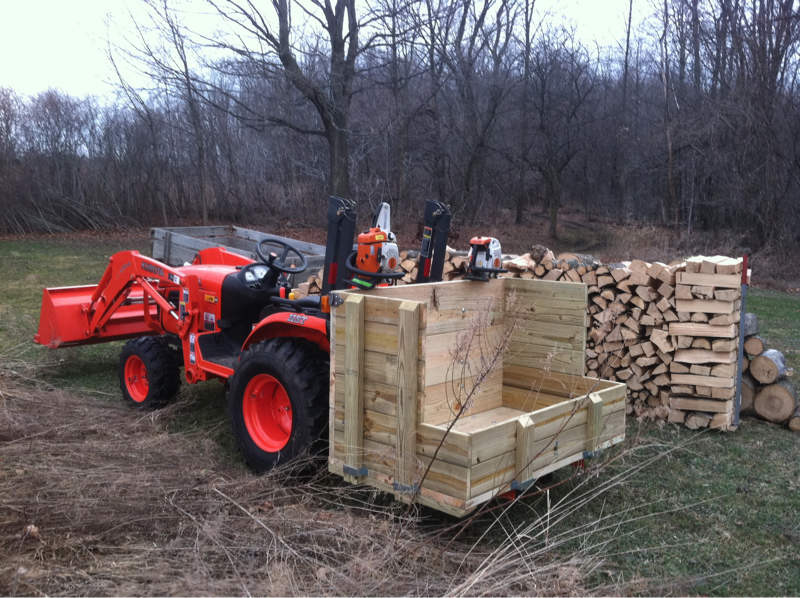

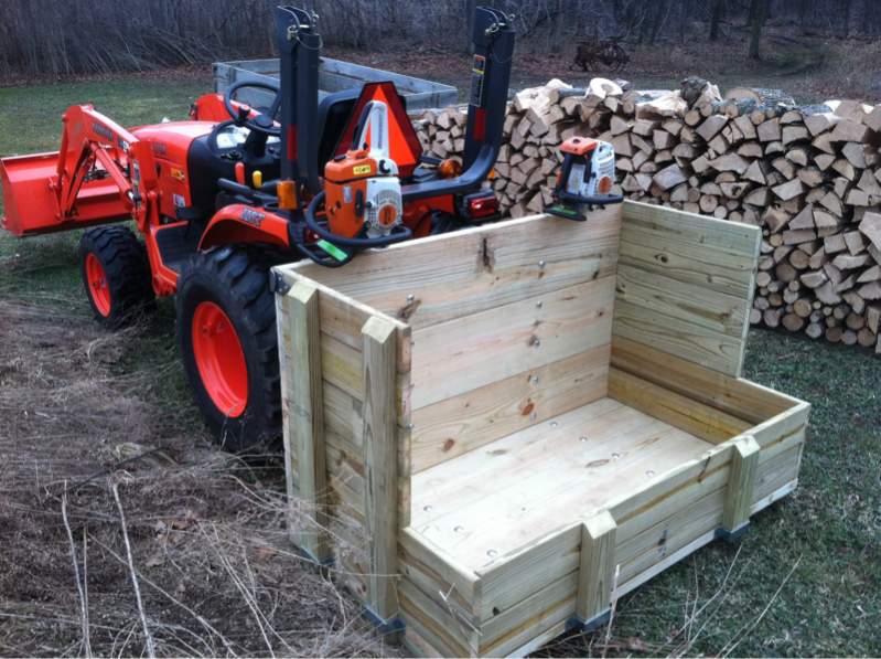

Here's what I came up with today after carefully studying everyone else's.

It does look good! Thanks for the idea on how to mount the chainsaws.

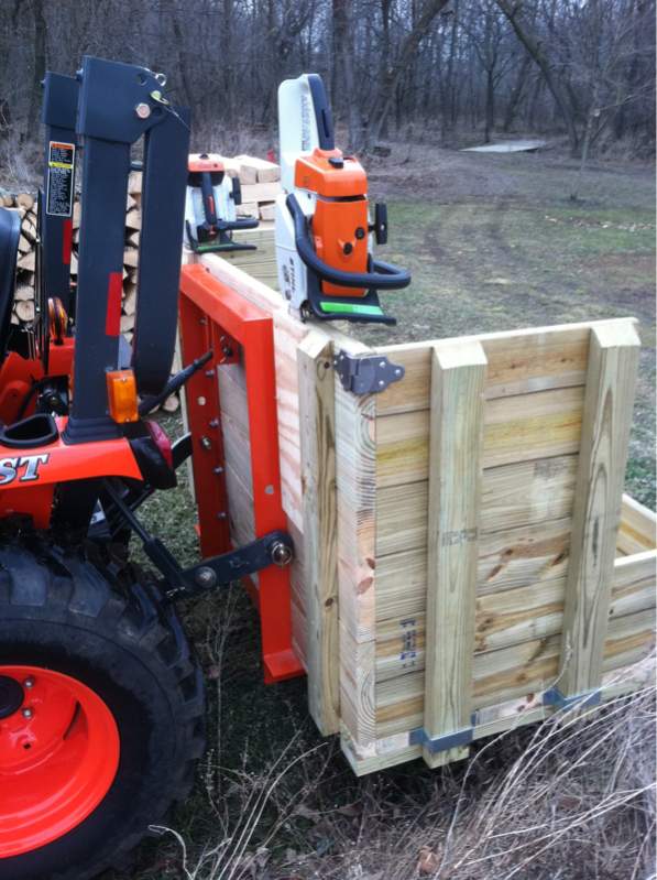

Looks great, do you have any close up pics of the chainsaw mount. How high does your carry-all come off the ground? the one pic doesn't look like a lot of height , but pics some times throw your eye off.

Beefie I'll get you a shot or two of the chainsaw mounts. Not sure how far it comes off the ground, maybe a foot or so. Wow that thing got heavy! I was starting to wonder if my tractor was going to able to lift it empty :confused2: Worked out great though we will see when filled with firewood.

Nice job on the ''Carry-All''!!:thumbsup:... Looks great!
Should be able to carry a lot of firewood in that!
Those chainsaw ''mounts'' sure are handy!... I put 2 on my firewood trailer, and one on my tractor!
Thanks for sharing the pictures!
   / Yet another carry all project #8
does the blade of chainsaw basically just sit down in a "slot?" You not afraid of torquing blade when going over any bumps or does the saw not move that much?

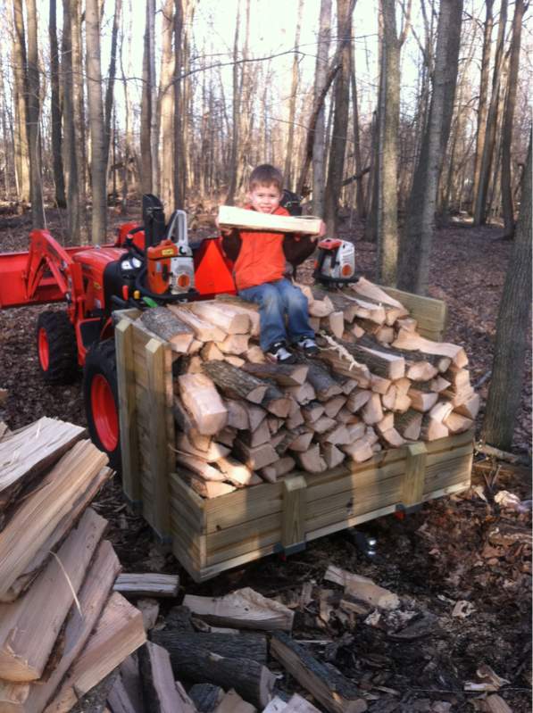

Holds about a face cord.

Does anybody know how much these carry alls are rated for? I have the heaver duty one but cant find the ratings anywhere. I'm thinking its more than a B2920 can lift. anybody know what a B2920 is rated for? Just got thinking about this and my manual is out in the barn :laughing:
That sure holds the wood!;)

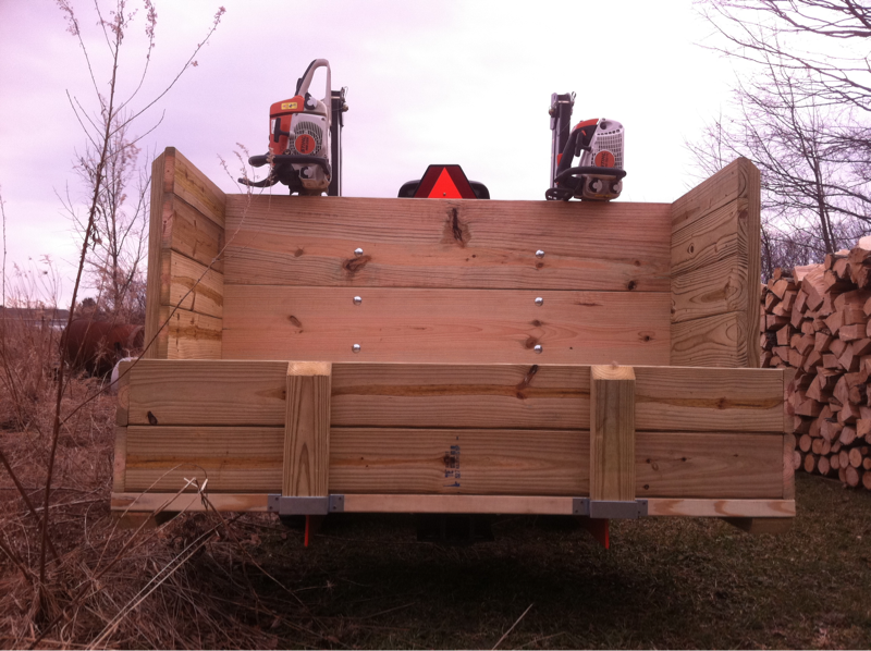

I don't know how much weight the Carry All will hold, But I would check the welds good on the angle-iron!... If you had to, You could always put more braces on the bottom with some ''flat-bar''!
I started to buy one and fix it like yours and like ''Runner'' did.. Instead, I made my forks to use on my 3PH, and plan to build a box like that to haul tools etc.. etc.. around.

Thanks! I have a trailer hitch on this also to pull my splitter.:thumbsup:
   / Yet another carry all project #15
Really nice job. A carry all is on my list - and I like the way you built that. What are the dimensions you used ?
A face cord of 16" green hardwood will run 1500# or so. You'll need your boy to sit in the bucket to give you some front ballast :D
