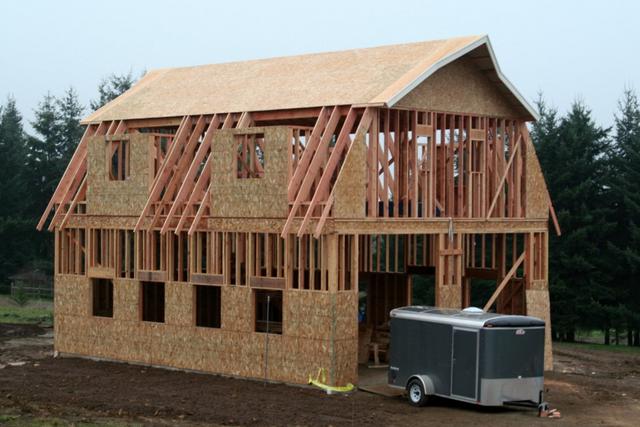

Long time no post, but lots of progress is being made. Attached is a pic as of a few days ago. Garage doors are on order, roof should be on in a few days. We should be able to move a few things in around Christmas.

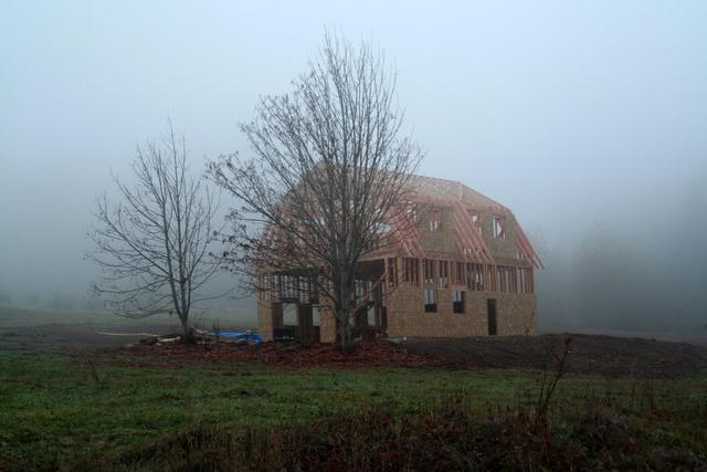

Here's a cool pic viewed through the heavy fog we had last week.

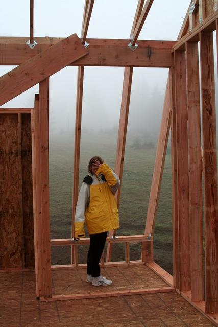

The builder and engineer have been great to work with - both have offered up great advice on little details that have made a big difference in how the building will turn out.
The original barnplans.com plans used hand-built trusses for the roof, which rested at floor level upstairs. By using narrower pre-fabbed trusses, and some strategic interior beam and wall placements for the dormer windows, we gained more interior roof height while keeping the exterior shape.
Also, the addition of a small, 18" stem wall upstairs made areas that would be cramped and/or unusable under a gambrel roof, almost completely available. Attached is a pic of my lovely wife modeling under a corner section that would normally be very difficult to get any functional space out of (you can see the beam above her, stem wall behind.) As it turned out, it will make a great closet, with all but the back 1' or so very accessible. The stem wall also makes cleaning a lot easier, as there's no "zero clearance" area where the roof meets the floor.
Oh...she's not covering her face cuz she's shy...just mad that I asked her to model before she had a chance to put makeup on for the day... /forums/images/graemlins/smile.gif

Very nice looking barn DaNag! My apologies for not reading your entire post before asking, but it looks like you have an oversized door. Perhaps for an RV or something?

Most RV's would probably fit, but the height was done for my boat w/RADAR arch. It comes in a little under 11' on the trailer. I'm also thinking of getting a camper on the truck someday - it should fit in the shorter bay as well.
Made the openings 12'6"...might lose a few of those inches to the garage doors.

I had a look at the rest of your pics DaNag, that's going to be one fine looking barn when you're finished. I really like the upper peak treatment. Nice proportions too. Keep the pics coming /forums/images/graemlins/smile.gif
