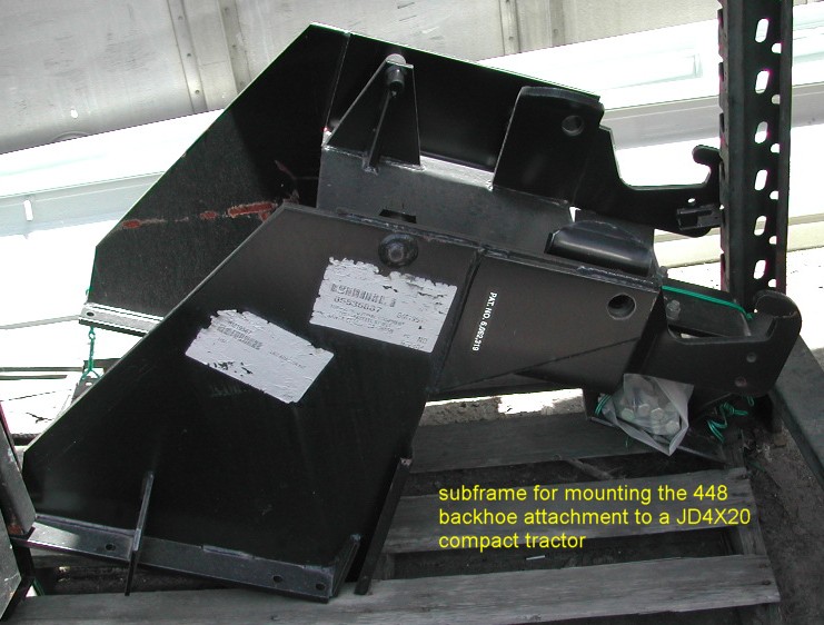

so I'm about to take the plunge on a 448 hoe (maybe even tomorrow.) This will be going on a 3320. From what I understand, there is a specific subframe that is needed for hookup to the 4xxx series..but not on the 3xxx series. I am a bit confused as to how this mounts. I guess there is some sort of rockshaft assist and that it is not a 3pt mount. How rigid is the mount-up? Not that I have seen any reports of breakage and the dealer says that it is quite stout, I am still curious.

There is a permanent subframe for the 448 that mounts to the tractor. The 3PH is used to lift the hoe onto this frame. Your dealer should have more info.

yea he gave me some sort of vague answer about plates, etc..but when I mentioned that one of my reasons for going 448 over 447 on a 3xxx was to keep the hoe if I go up one series, he stated that in doing that in the future I would need some sort of subframe specific to the 4xxx series machines. That comment is what was driving my curiosity
   / yet another 448 question #4
It's not a sub frame just a different bracket for the 4000 series machine. The 3000 series also has there own bracket. There is nothing that goes on the 448 itself. The mounting method is exactly the same on both series. I have the 448 on my 3320 you'll be happy you picked it over the 447. Anyone who says its not meant for the 3000 is just plain wrong. Make sure they bump your relief valve to the max so your rockshaft can lift it.

Just an FYI about your backhoe and tractor. I have a 448 for my 4400 CUT. With the installation of the subframe mount you cannot use the mid pto for a mower deck because of the back hoe mount. I don't know the specifics about your tractor frame, but I wouldn't spend the money for the mid mount PTO if you won't be able to use it.
Good luck with the Backhoe, you will find all kinds of uses for it.
