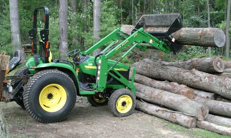

Here's my new 4310. It arrived Friday morning and already has 20 hours on it. When this picture was taken, it had my Woods 750 backhoe on for ballast. I'm very impressed with the 4310, especially its ability to dig in hard ground with the loader.
The dealer plumbed up the 4in1 bucket with the hoses running across the floorboard as pictured, to the 3rd SCV outlet at the back. I'm thinking of plumbing with steel pipe to a set of quick-connects up near the loader quick-connects. I'll put a manual diverter valve at the back so I can use the 3rd SCV for both the 4in1 and a hydraulic top link (can't afford the JD top-n-tilt). How was the 4in1 plumbed on other owner's tractors?

My extra hydraulics were plumbed under the floor board with 2 extra connects above the usual 4. If you would like I can send a photo.

The hoses over the floorboard, well, looks like hell, I cant beleive they were left like that from a dealer. There is plenty of hose length to run under the floorboard along the pipes for the scv's tie wrap them to the pipes direct the remaining hose over top of the axle housing and plug them in the rear couplers. Other than that, looks good.
   / Yet another 4310 club member #7
Welcome to the 4310 Club! That 4n1 bucket looks like it will really come in handy for you. I think you would be wise to get those hydraulic lines plumbed under the floor when you have an opportunity to do so. Good luck with your new Green machine.
