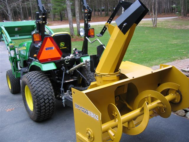

I picked up a used Woods 52 inch blower for my tractor last year. Think I paid about $600.00 works good. My trractor is 24 HP. Hope this helps

Wow that was a great deal. I would be all over a deal like that if I can find one...
