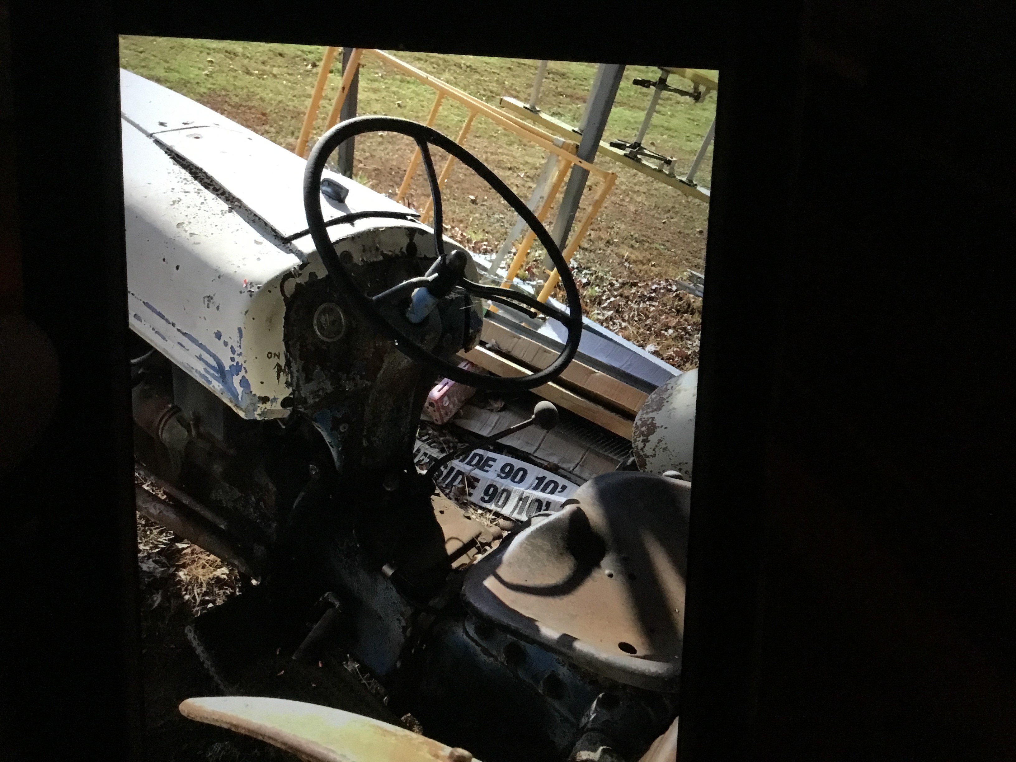

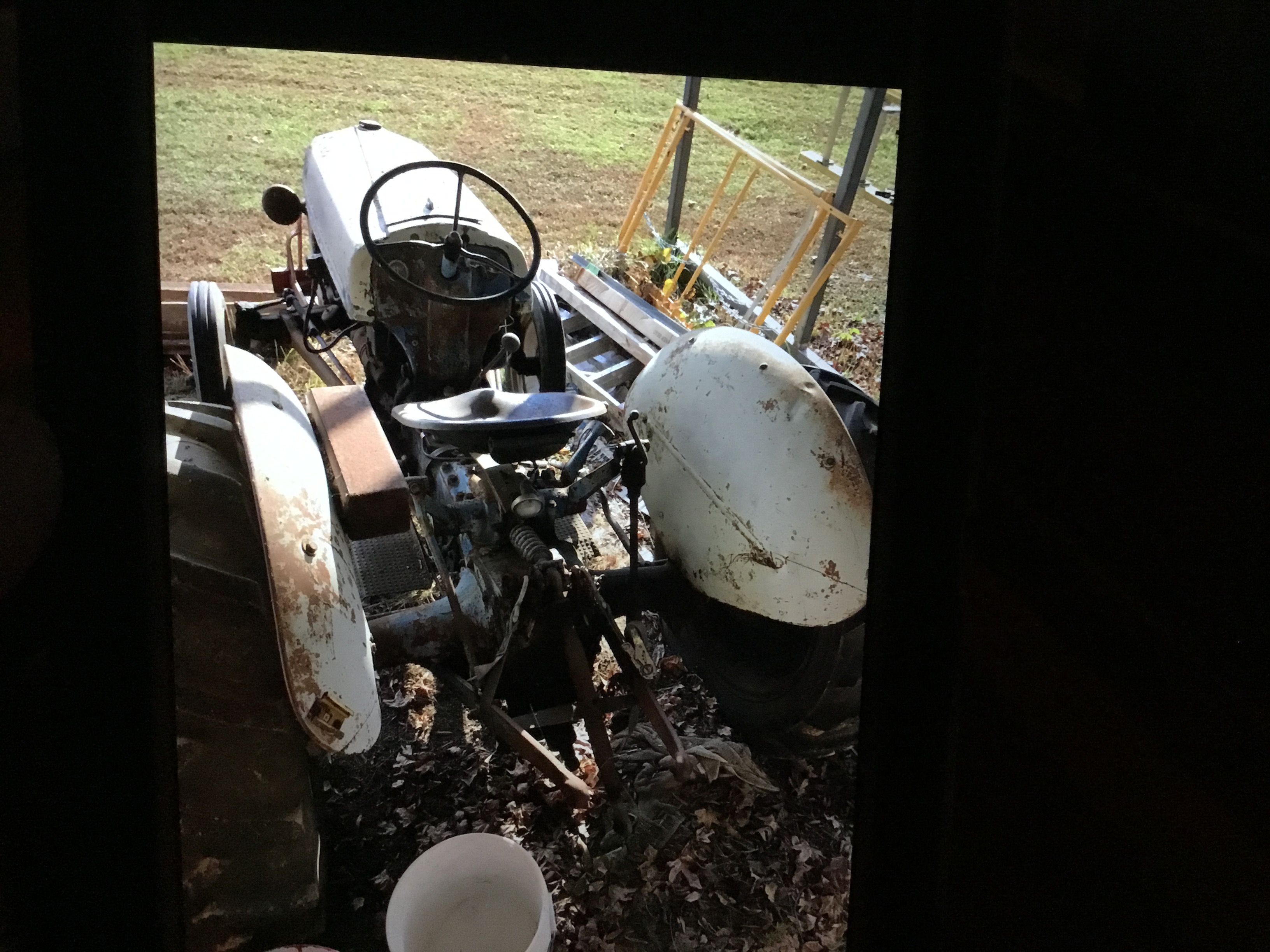

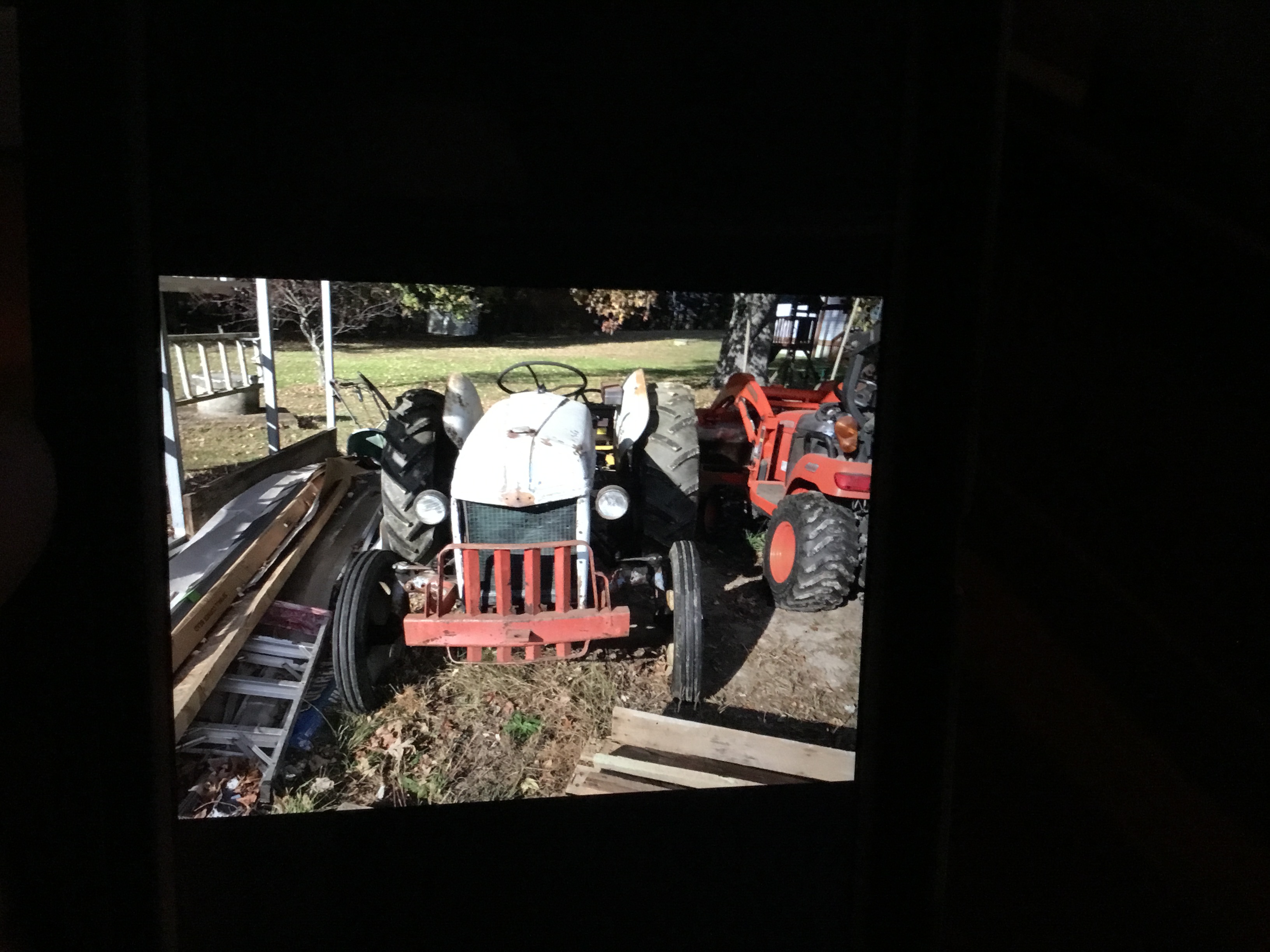

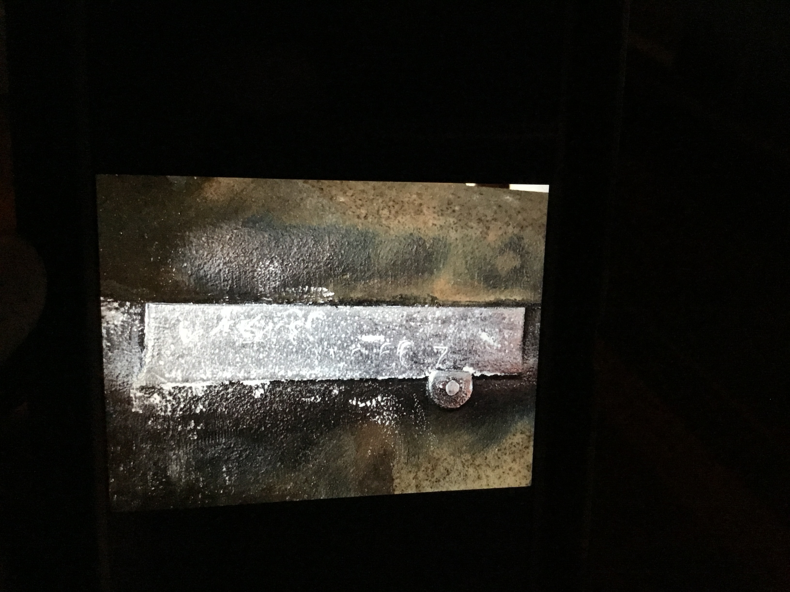

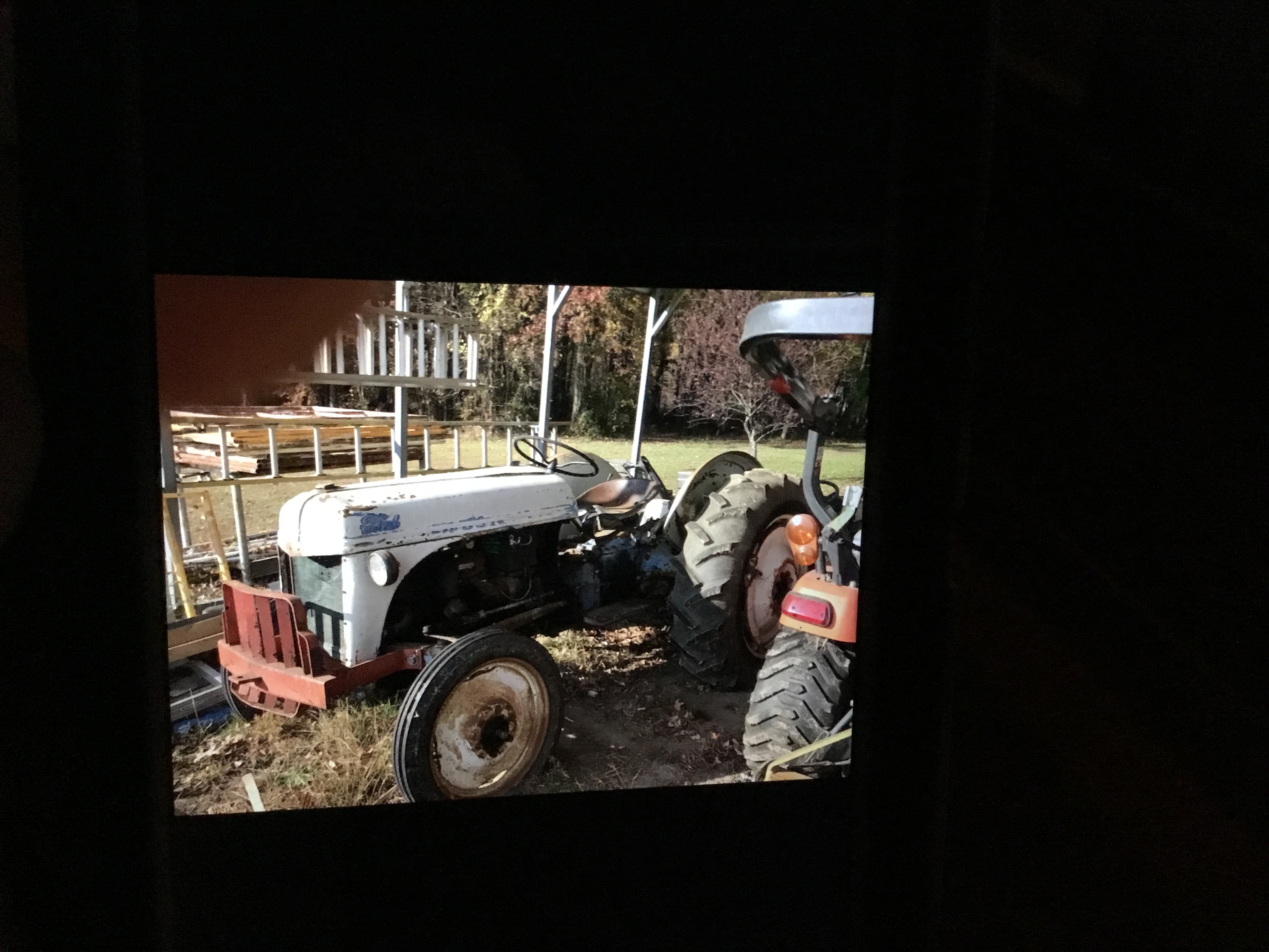

I recently inherited an old ford tractor from my grandfather and I'd like to begin restoring it. I am having trouble finding the year and model of the tractor and nobody in the family seems to remember either.
I found the serial number on the left side of the motor and have cleaned it up to bare metal but I still can't make out what it says. I've tried the pencil trick, the chalk trick and a flashlight in different angles with no success. Any help will be greatly appreciated.

I'm guessing 8N. With that said, I think the rear wheels and fenders have been replaced by something newer. The tractordata link I posted earlier will give you the technical information on the 8N. The experts mentioned below will tell you how to analyze your Serial Number if you can ever get to read it and that will tell you the year.

One simple check, 8-N had both brake peddles on right side. 9-N had one on each side of trans.

It is an 8N

It has a clutch on the left and what I think is 2 brakes on the right.
/ Year and model help #13
Older 8N's have a front mount distributor, later models have a side mount (handy to work on).
Some late models have the Sherman combo transmission (very desirable - many more speeds- with selecting lever on left side)
