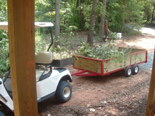

Harbor freight had some tires and wheels on sale last week, so I bought the last 4 4.00 x6 x 13" OD tires they had. Our daughter has Vickie's trailer so I decided to build me one. I used 2"x2"x1/8" angle for the frame and some 2"x2"x1/4" tubing for the walking beams. It has 1/2" treated plywood for the floor and the 16" high sides. It works great behind my golfcart. Later, Nat

Looks good. Hey, what's that I see in the background, a still? /forums/images/graemlins/grin.gif

Last year I built a tandem trailer for my Sears garden tractor. After the kids gave each other rides for about two hours I found two of the 5/16 bolts & nuts gone from the rims. make sure they are tight, almost split a rim. Gary

That is a great lookin' trailer....Love the RED!!!
