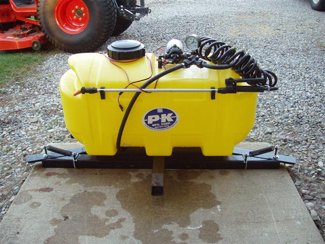

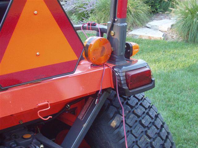

Here is my setup. It started out as an ATV sprayer and then I made a bracket to mount it to my receiver hitch. Works great. The boom covers 120" which is double the width of my 60" MMM. I get near perfect coverage by just following my mowing stripes and skipping every other stripe. I calibrated it by trial and error with just plain water in the tank and measuring how far and how fast I need to travel to spray 1 gallon. On my B3030 it is 1700 rpm at full HST pedal in M gear. It takes 40 gallons to do my 2 acre lawn. I use Bayer All-in-One at a rate of one bottle per five gallons of water. I have found that fall spraying gives the best results with a touch up or two during the summer to a few spots.
