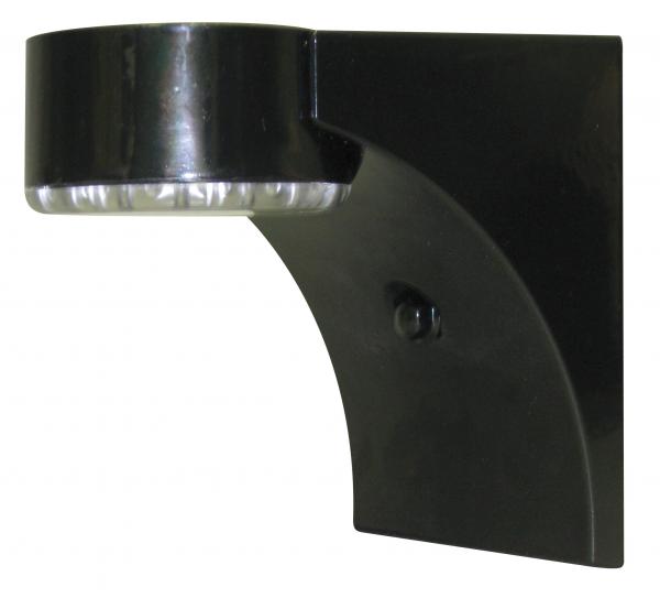

Here's another nice little fixture ive installed a few of. 14W 1100 Luminens min. http://www.rabdesign.ca/productdetails/wl-led14.html No complaints at all. Nice look. Made by Rab, but not the same Rab as Eddy posted (weird 2 companies with basically the same name). Around $125.
