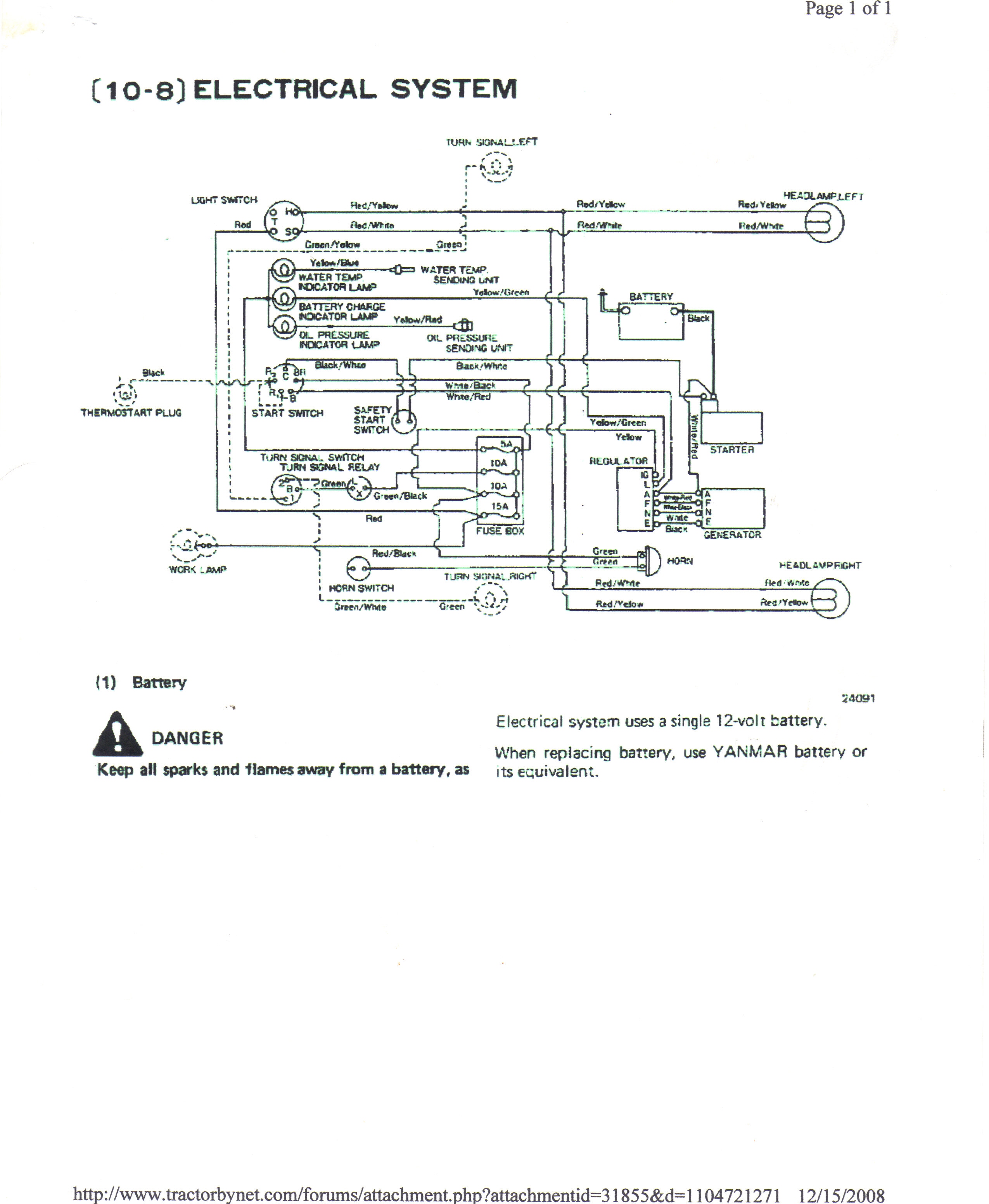

I have the little reservoir and everything but my key doesn't turn to the left.....?
Don't know, but looking to see where the thermostart wire goes will give the clue.
   / Yanmar's Thermostart #10

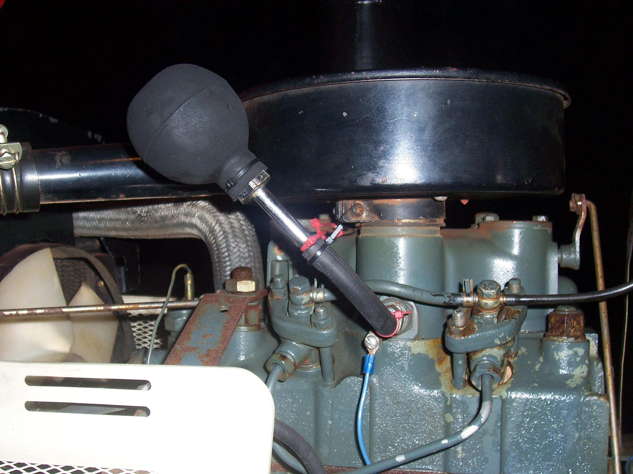

Really not much to it. The blue wire to the Ign. switch. It's been yrs. but I believe it's R-2 on the switch... Rarely do I ever have the need to use mine and I don't have the plastic cup. So the very few times I did use it this is all I did to get fuel to it. After I started the tractor I just squirt it back in the tank. If the switch is not working just run a wire to the battery + for a few Sec..
