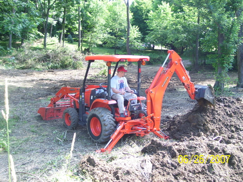

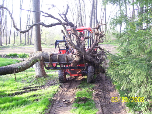

I looked at the Yanmar a little about a year ago when I was looking at TLB's. I probably didn't give it as thorough a look as the JD 110 and the Kubota line of TLBs. It looks like a stout machine but I didn't have many dealers around and had a little trouble getting any feeback on them. Not fair for me to comment further on it. I ended up with an L39. I have about 200 hrs. on it in 11 months. It fits my needs really well. Not sure what you are looking to do but it has the right combination of power, manuverability and reliability (so far) I was looking for. It's kind of a swiss army knife. There may be other machines that will do particular things better but it has done everything I have needed it to very well. The hoe is a stud for it's size and the loader has perform well for me as well. I have a stock FEL bucket, grapple bucket and and 12 and 24 inch BH buckets. I have dug out 50+ stumps (ranging from 5-30+ inches in diameter) and taken down 20 some trees rootball and all. I've cleared a couple acreas of brush, put 75 ft of drain tile in, moved 20 ton of #57 gravel, cleared a creek (still working on that), moved 100 ton of fill, Dug drainage ditch, graded several low areas with fill I moved in, moved tons of Landscaping boulders and mulch, transplanted 8ft tall pine trees, moved a couple holly bushes, fixed a septic problem and several other odd jobs. Didn't mean to run on but just wanted to give you an idea the type of work it does for me. I'm just a homeowner - don't contract out. It's a chunk of change but the efficiency it brings to the scope of work I have on my 14 acres is a good match. I have a 21hp CUT that compliments it so I thought the stronger integral frame TLB was what would supply the best bang for the buck in my situation. I have attached a few photos. If you like to see more or have any questions let me know. Good luck with your decision.

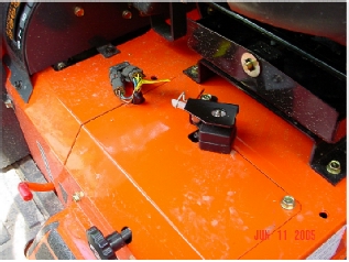

Creep type function is attainable as well. Mike (from NH) showed me this. He used a hanger (See attached pic). I used alittle piece of Tyvek tape to bypass the switch which kills the engine when you shift out of neutral from the hoe position. By doing this you can lower your rpms set speed level at 1 and go F or R. Kinda slick.

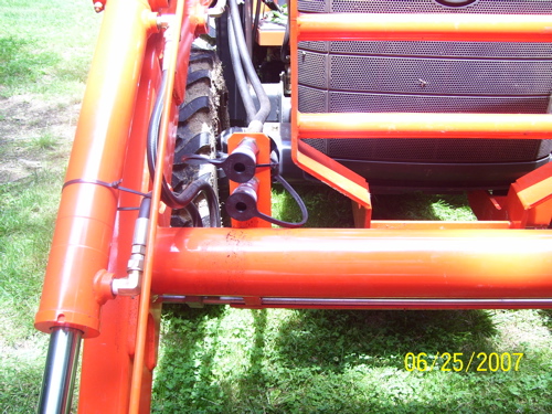

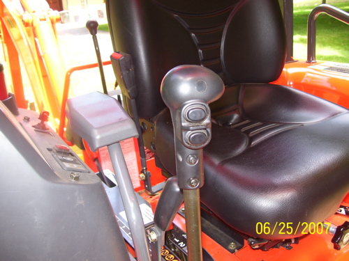

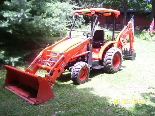

Also - Here's my front remote setup for the grapple and the joysitck with remote controls in case your interested.
