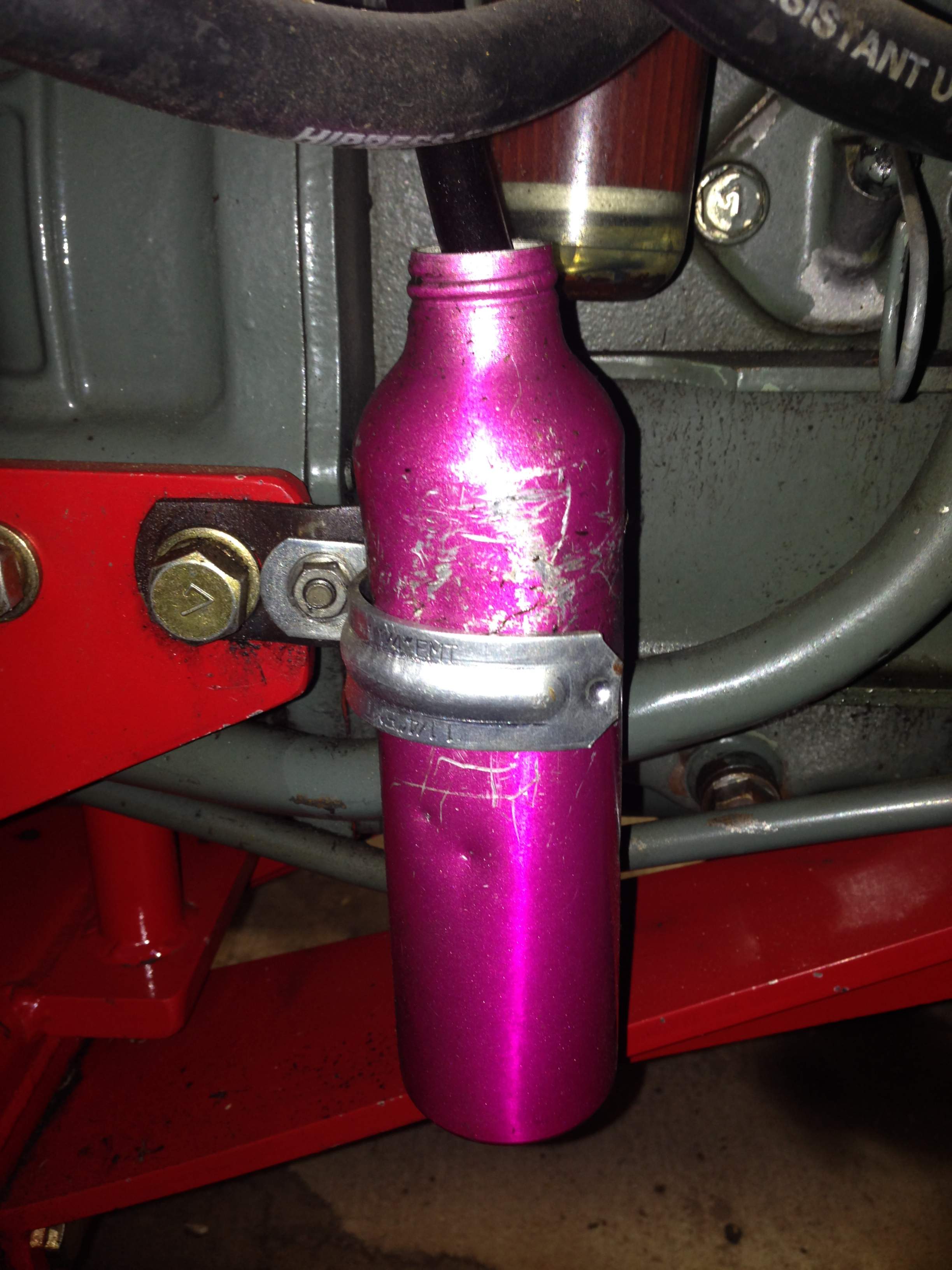

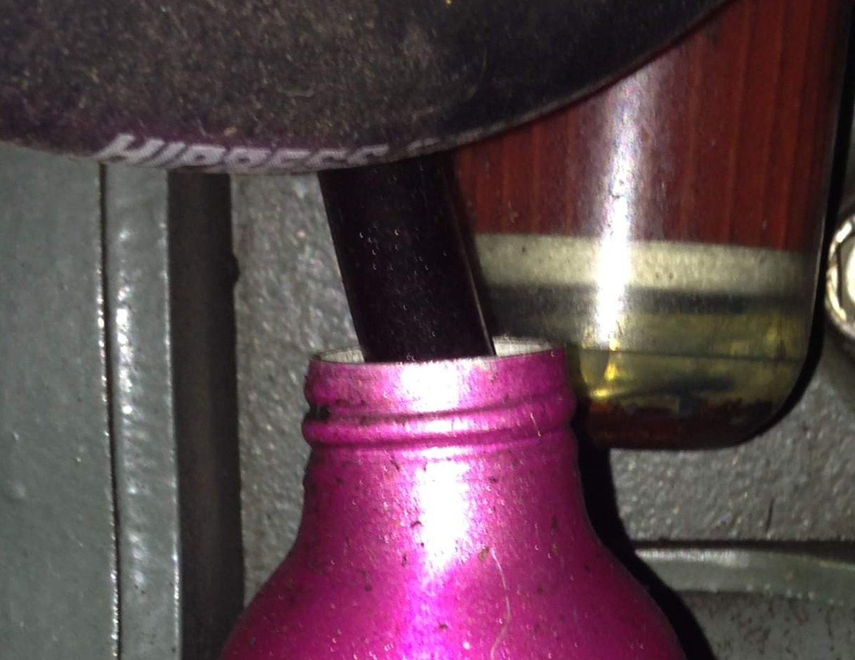

   / Yanmar1610D Engine #7
Do what I do in the same situation mount a small container where the blowby oil tube ends and every couple of hrs of use check container and pour back into crankcase if not contamimated this works well on my 1601D
How long have you been dealing with this? Got any pictures of the container you have ridged up and how you get it to stay on the tractor?
   / Yanmar1610D Engine #9
been doing this way for about 2 yrs cheeper than a rebuild this was a spray bottle I picked up at the dollar store
   / Yanmar1610D Engine #10
Isn't that the Fuel level looking at the Filter and Bowl. Did you Just change the Filter when you snapped a pic. of your Rig.? I fill my Bowl up when replacing it and a new Filter. Alot easier to Bleed all the Air out.
