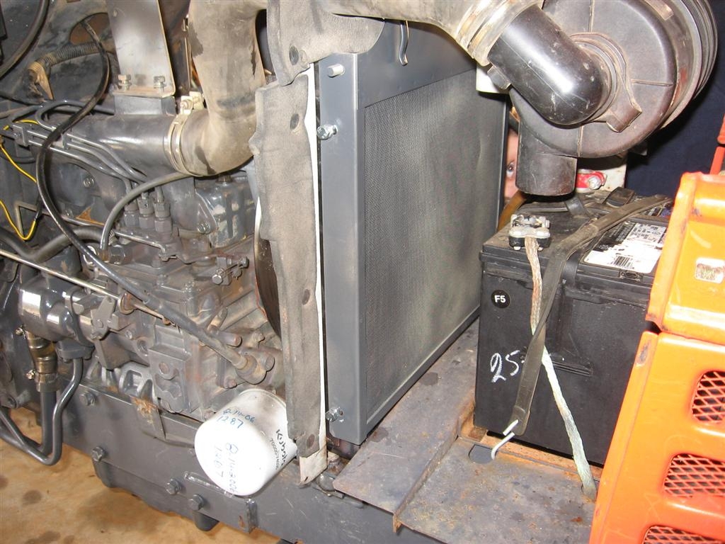

KennethBrown said:
My dads 2610 will overheat after using it high weeds. We have to pull the radiator out and flush it. We have a plastic 55 gallon drum that will fill with water and soak the entire thing in. I then take it and blow water through the fins/core. You'd be suprised how much gets through the screen.
Maybe you need a smaller screen. I bought the screen for my L2500, not the nice slide up and down type like on the newer models. It's about the size of door screen but has really helped me keep the stuff out of the fins. Just a stick or bush to knock the stuff off now and I'm back to mowing.
Rob
