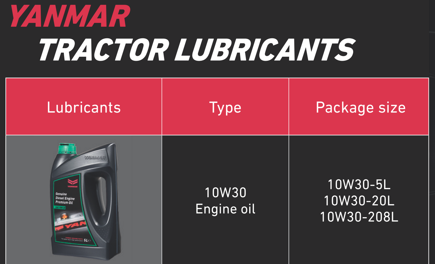

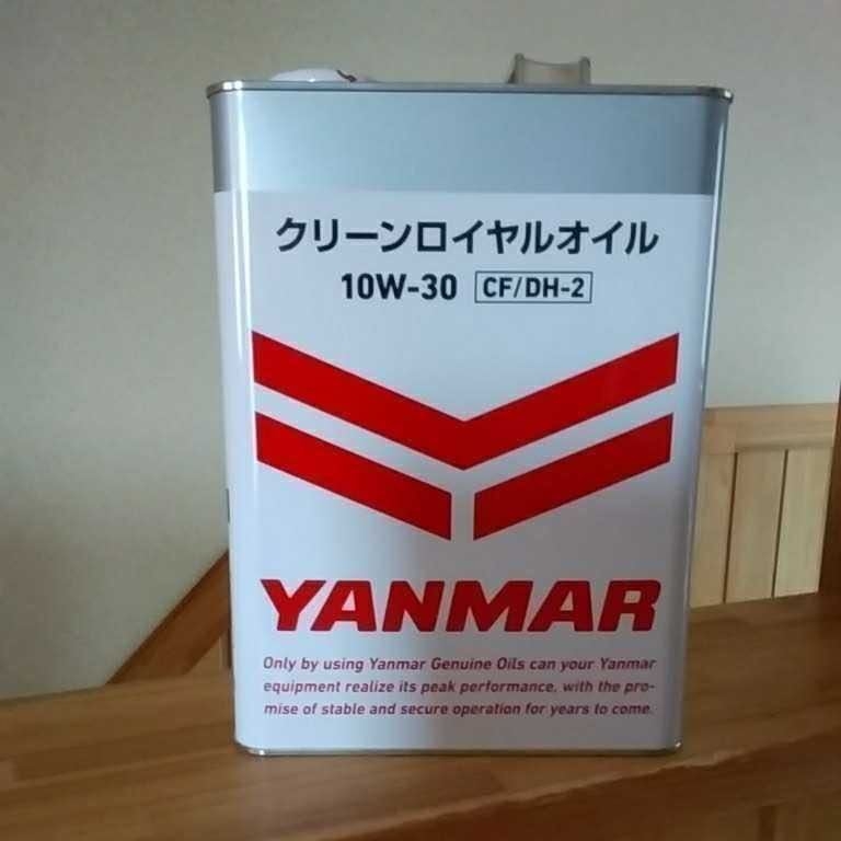

Hi Travis,
Good to see you here on TBN as well.
Yes, we have touched on the oil topic here on TBN a bunch of times.

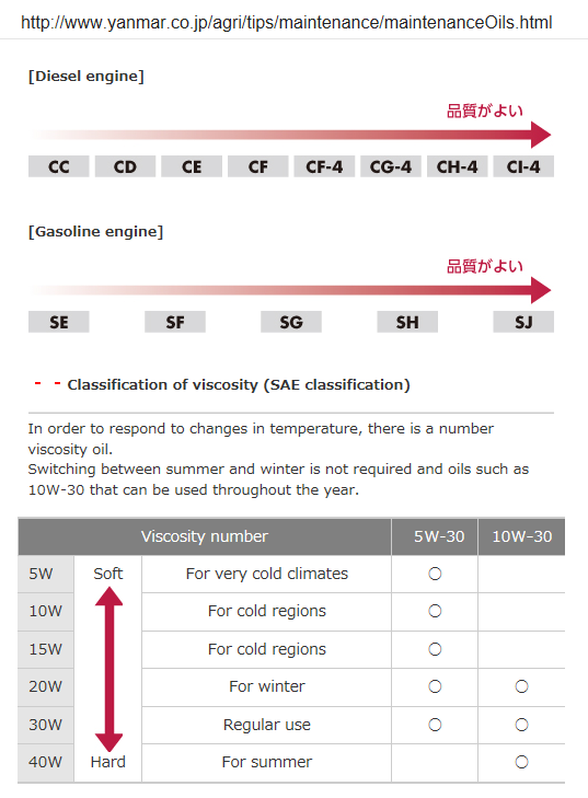

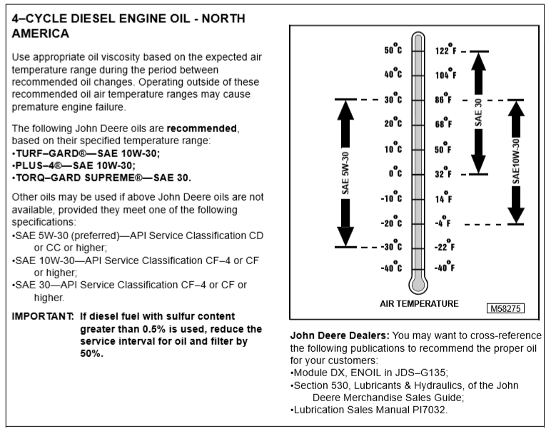

Since you are down south, really down south, I bet you can get by with 10W30 all 3 seasons, then SAE30 for the hot summer.
The Yanmar OE engine oil is,

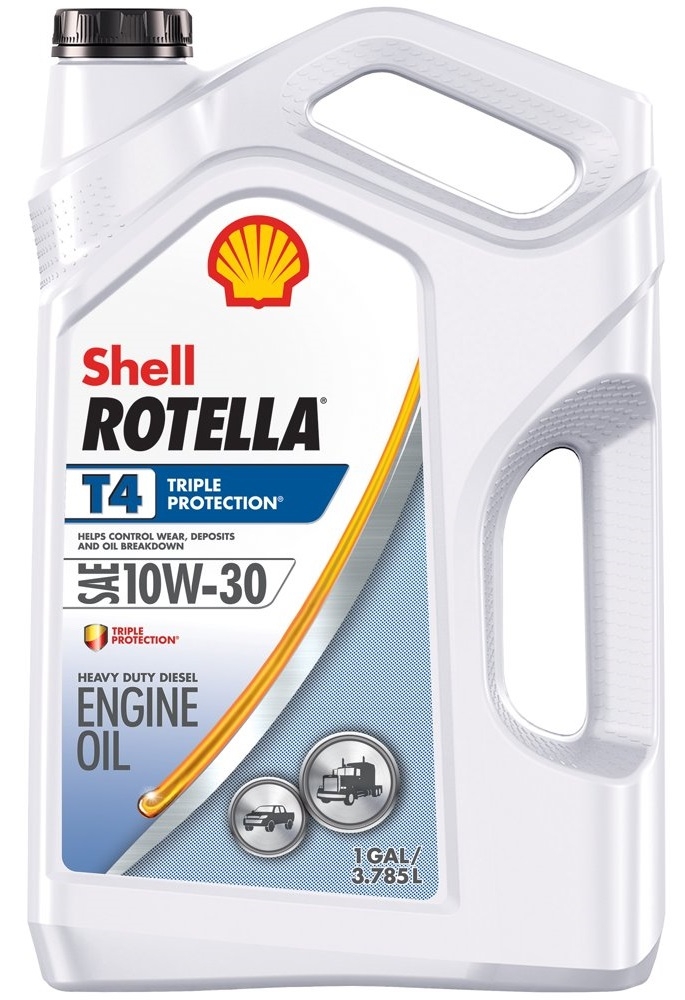

Pennzoil, Valvoline, Quaker State, Shell, etc. in 10W30 would be fine.
Menards tends to have this for $15.89 up here.
For the vintage Yanmars like the YM, F, FX, KE, RS series in North America,
